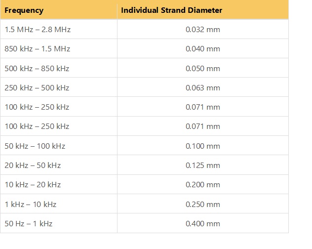

      Hi everyone. I made 3 rx coils for the omega. 1: 0.10mm, 2: 0.20, 3: 0.25mm all three have almost the same inductance value, only their resistance changes of course, .. for the moment, it is 0.25 mm which is the most sensitive to the target size. all resonate at 9.9, 10, and 10.2khz. Tomorrow I change the capacity, to resonate at other frequencies ..
      Hi Lamoiz
      Contacted a UK manufacturer of litz wire today who asked me some interesting questions which led to further research into litz wire.
      You will see from the attached table that 0.2mm to 0.25mm diameter conductors are more suited to our purposes and designs
Name:	Litz frequency table.jpg

            • Originally posted by MartinB View Post
              Hi Lamoiz
              [ATTACH]53962[/ATTACH]
              good information .thank you.
