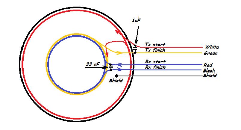

      • Maybe this style of coil, this from don bowers pdf i downloaded on making an IDX Concentric Coplaner coil.
Name:	db flowers coil.jpg
        If Don does not want met to share his image, i wll remove it, it is from his pdf i downloaded that is the whole process to build one of these, and who better to make the coil shell also, which i have bought some shells from him and they are as good or better than whites, or anyone else also,I dont have his permission to share the pdf so i wont.
        This for the whites classic series which is a vlf, but it does use 5 wires like a whites.
        Maybe have to build 2 coils for voodoo, one for vlf, and one for PI.
        I have learned from my experience that when something can do multiple things, it cant do one thing the best as to say.
        When i took my detectors out prospecting, i always took 2, my whites goldmaster, which ran at 50khz, and my tesoro which ran at 25khz.
        Goldmaster for small gold, and Tesoro for larger. Both vlf. i would switch them. Goldmaster for smaller stuff, Tesoro for deeper bigger.Goldmaster more sensitive.

          • I've made a version of this coil for the Voodoo (verticle planer concentric) Its what I first fired up with, So far Ive not tested any pro coils to compare to for performance.
            Depth is not that great but I'm having noise Issues as Lamoiz did at first.
            It may be due to using straight leads off the coils that are unshielded.
            Also I used some compatible parts I have to switch out to see if that helps.
            Here is what I'm seeing on the voodoo front end that I think is causing some problems.
            Thinking because the tx is damped and the Rx is not I'm seeing the Rx oscillations with faster coils in the tx Pi preamp first stage.
            Testing my dual field DD coil on the Voodoo I can see the Rx in the Tx.
            Thinking this might be the case with other DD type coils as well.
            Do any of you see this?
            The concentric with a bucking coil does not exhibit this so as you guys are saying a bucking coil arrangement may be the way to go for the Voodoo.
            I still have one more thing to try to the dual field DD and thats adding a bucking coil to the Rx to see if can cancel out the Rx interference in the Tx.
            Other wise on a normal Pi with a damped Rx the dual field DD is quite good on the bench so far so I would think it should be workable on the Voodoo.
            Also going to try a SEF coil off a Mxt.
            • You may take TX coil + bucking coil as sort of "8" type coil.
              Good noise suppression... but i am not sure about other benefits.
