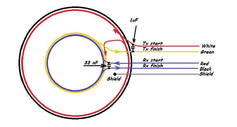

      • The wire sizes for RX / TX and possibly the number of turns would be very interesting for the IDX-Pro project. That would really help a lot. If you already have the Black Max 950 on ;-)
        • here is a link to the TGSL thread with the downloadable docs on how to build the coil, a concentric, Rx, TX, And Bx or bucking with all the wire sizes, turns, ect.
          I have downloaded the files and they are written perfectly with wire sizes, lengths, and pics of the complete process from Dbowers who makes the coil shells and posts here.
          Maybe not what people need for a coil, this is from Dbowers, I have attached a Click image for larger version
Name:	db flowers coil.jpg
          Here is the link, its at the bottom of downloads, in sticky on top of page HERE

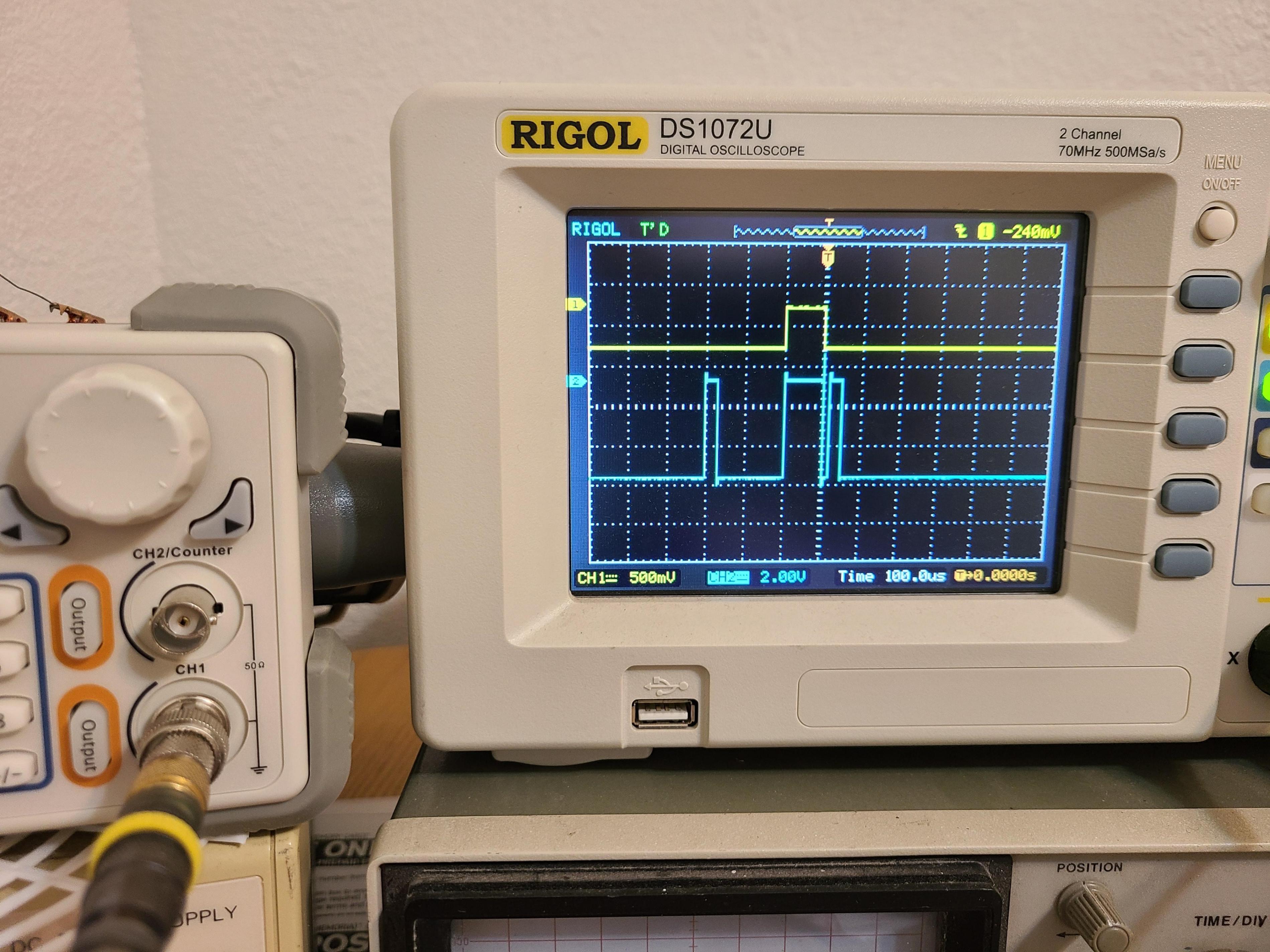

              • While waiting for my PCB and PIC to arrive I decided to build a concentric except I went for a more conventional 360uH TX and 6.9mH RX coil. To test it I attached it to a modified Surf PI Pro with a split TX and RX. To my amazement it worked great for a disc channel but required reduced gain. So I figured why not just build a separate disc channel and have an analog version of the VooDoo? I am just using the existing PI channel as an equivalent GB channel and borrowed some of George’s idea from the VooDoo project. I am just merging the two channels just like the Raptor, TGSL or Whites classic with a pair of LM393s. The only real challenge was getting the frequency response of the GB and disc channels close to the same. Also.. Resonant frequency of the RX channel doesn’t seem to matter much as long as the sample delay and sample pulse can be adjusted to sample at the correct time.
                Too many ideas from on George’s books to post here but I can show that it works.
                https://youtu.be/9aqxGrFK9fo
                So, here is a little demo of how it works. It deals with the ground signal quite well and can disc iron with an analogue meter.

                            It's not easy to tell from the video whether you're using a simple SAT, or single, or double-differentiating filters.
                            I've also tried analog versions of Voodoo with varying degrees of success.
                            • My original PI circuit uses a SAT for the audio threshold.. that’s it. For the disc channel I’m using a single ended diff amp same method you use for the VooDoo. For the Disc channel, I’m pulling from the main clock on of the PI detector and using Schmitt triggers to adjust delay and sample width. Then just merge the channels with LM393s. I think I could get it to work on the Baracuda, Hammerhead or Surf PI.. I had to change a few thing on your disc channel though because the frequency response was different between my PI circuit and what you have in your book. I had to change the gains a little as well. It completely ignores brick which I think is close to a real ground signal. That makes me feel optimistic. I will clean up my schematic and send it to you .
