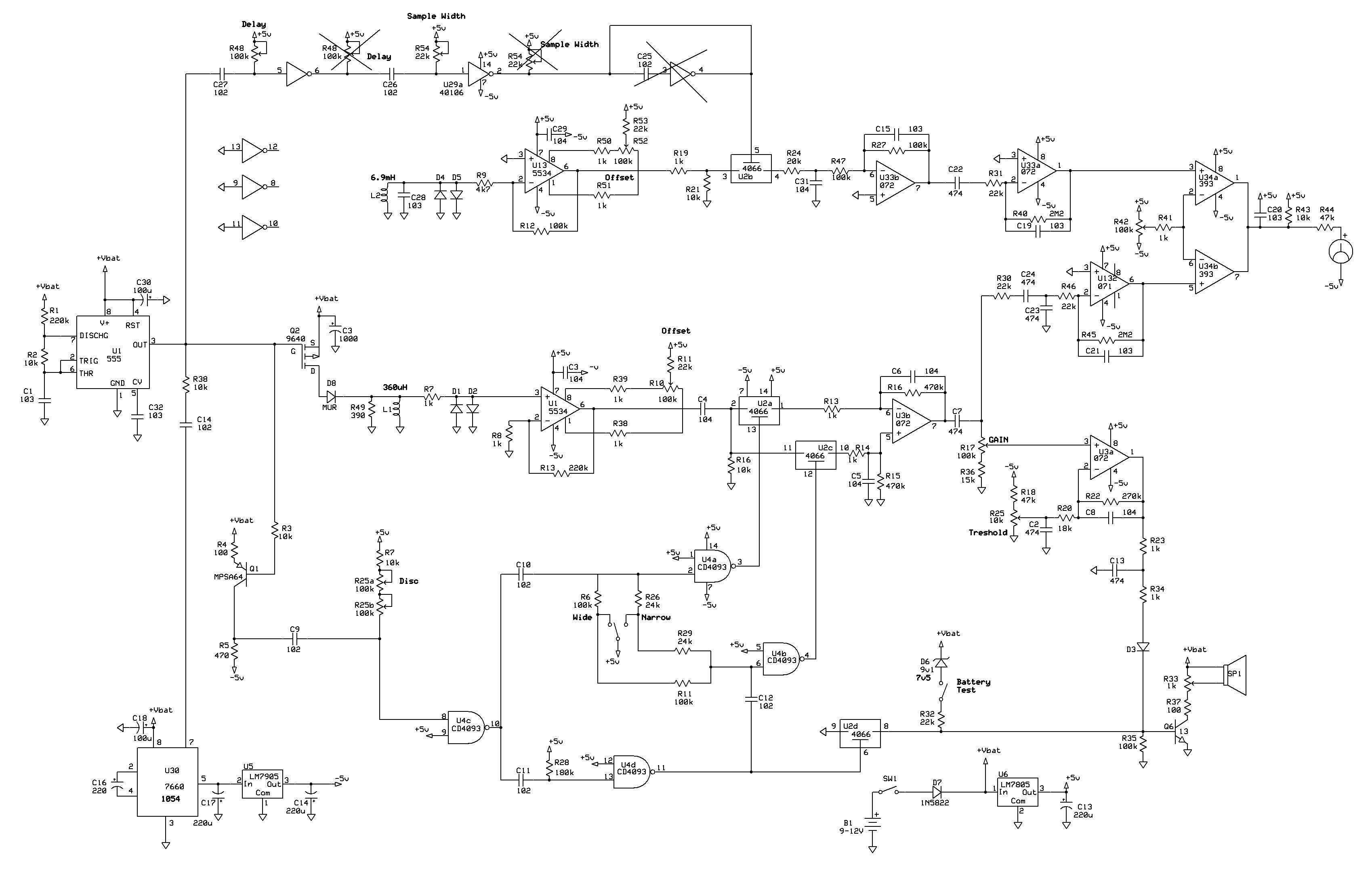

  • Don,
    please take look to your breadboard and update it's schematic!
    We need to know how to proceed.
    • Originally posted by Altair View Post
      Moreover, to do delay line with smith trigger the pull-up resistor must be connected to the input gate pin, not at the output.
      Referred to the schematic:
      -R48 must be on pin 5 of 40106;
      -R22 must be on pin 1 of 40106;
      -C25 and the third gate of 40106 don't should be needed if modification at post #956 will be made.
      This is confusing, you said "-R22 must be on pin 1 of 40106;" do you mean resistor 54 which has a value of 22K ? going by pin number changes in post #952
      R22 which is 270K is on pin 1 and 2 of U3a
      • Ohh, sorry to everyone, you rigth!
        I meant: R54 (22K) must be connected to pin 1 of U29 (40106).
        About: "-C25 and the third gate of 40106 don't should be needed if modification at post #956 will be made" I meant that if the modification described at post #956 will be made, probably C25 and the third gate of 40106 will no needed anymore: a direct connection between pin 2 of U29 and pin5 U2 will be required instead.
            Don,
            Yes.. sure will!! I by moving everything over to my protoboard It’s a good check. You guys are too fast sometimes. More in a bit..

                              Love it
                              • Fortunate coincidence in my drawing is that i did lot of wire jumpers on the top layer and now it will need not much of a surgery to correct those.
                                Only one track have to be cut actually, the one which goes from pin 2. to trimmer.
                                Jumper that goes from pin 6. omitted now and trimmer side soldered to close trace that goes from pin 5.
                                C26 soldered only with one pin to pcb, other pin in the air and with wire connected to pin 6.
                                Wire jumper that goes from pin 4. omitted. Pin 5. at 4066 connected to pin 2. at 40106 with short wire.
                                C25 omitted.
