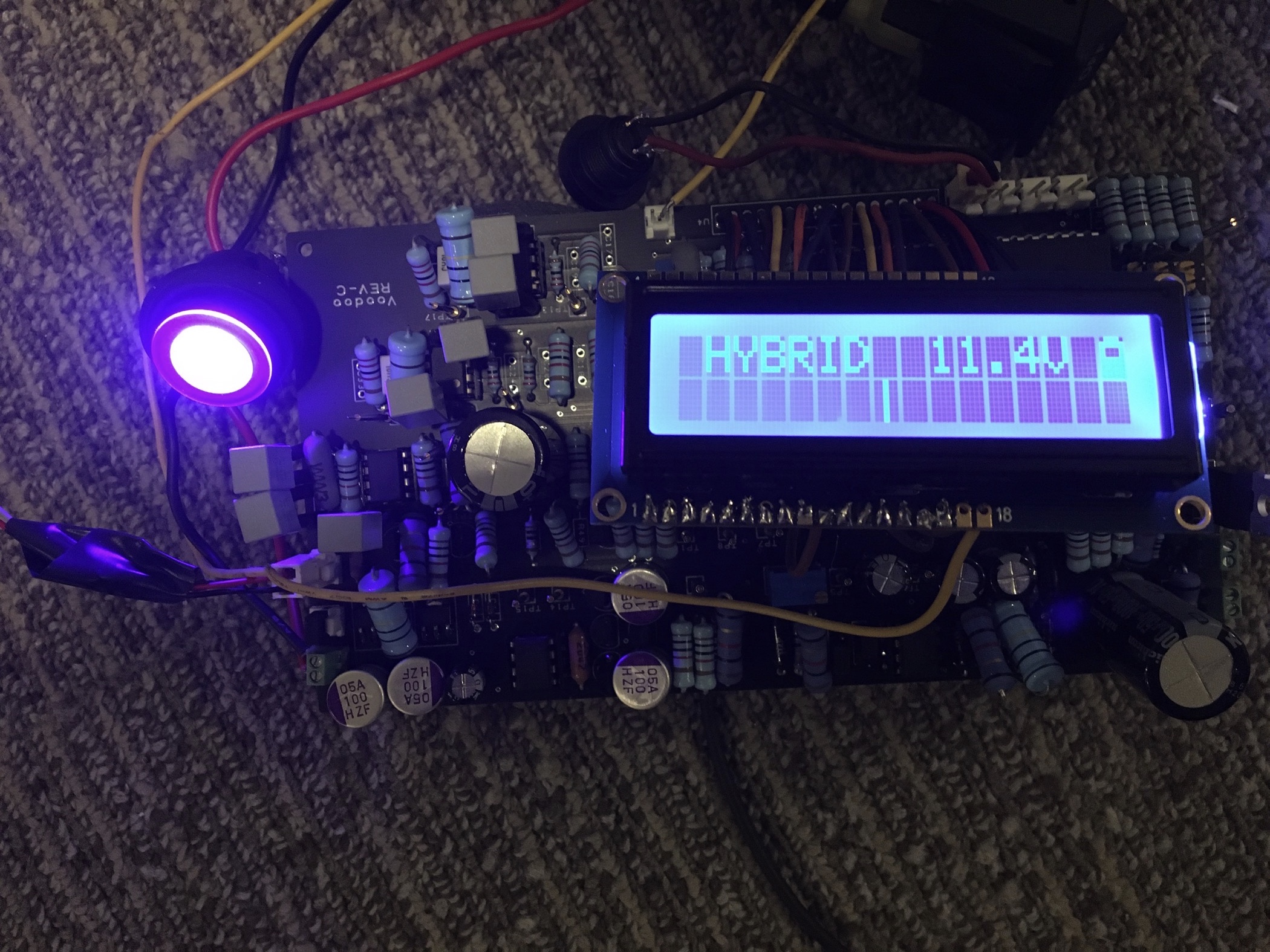

                          • Got my display going temporarily until i decide what color i want to light it up here is the common blue Click image for larger version
                            • Why you put giant resistors all over the pcb?
                              No need for that.
                                No need for that.
                                I was also wondering the same thing, as he previously said:
                                "I bought all the best parts I could that digikey had waterproof 5 pin male and female for the RG58U coax all gold contact ic dip sockets all gold test points multi colored screen waterproof push buttons and switch the best caps and resistors I?m at about $240 so far lol I want to make it so whoever just sees it asks about it let alone begs to use it"
