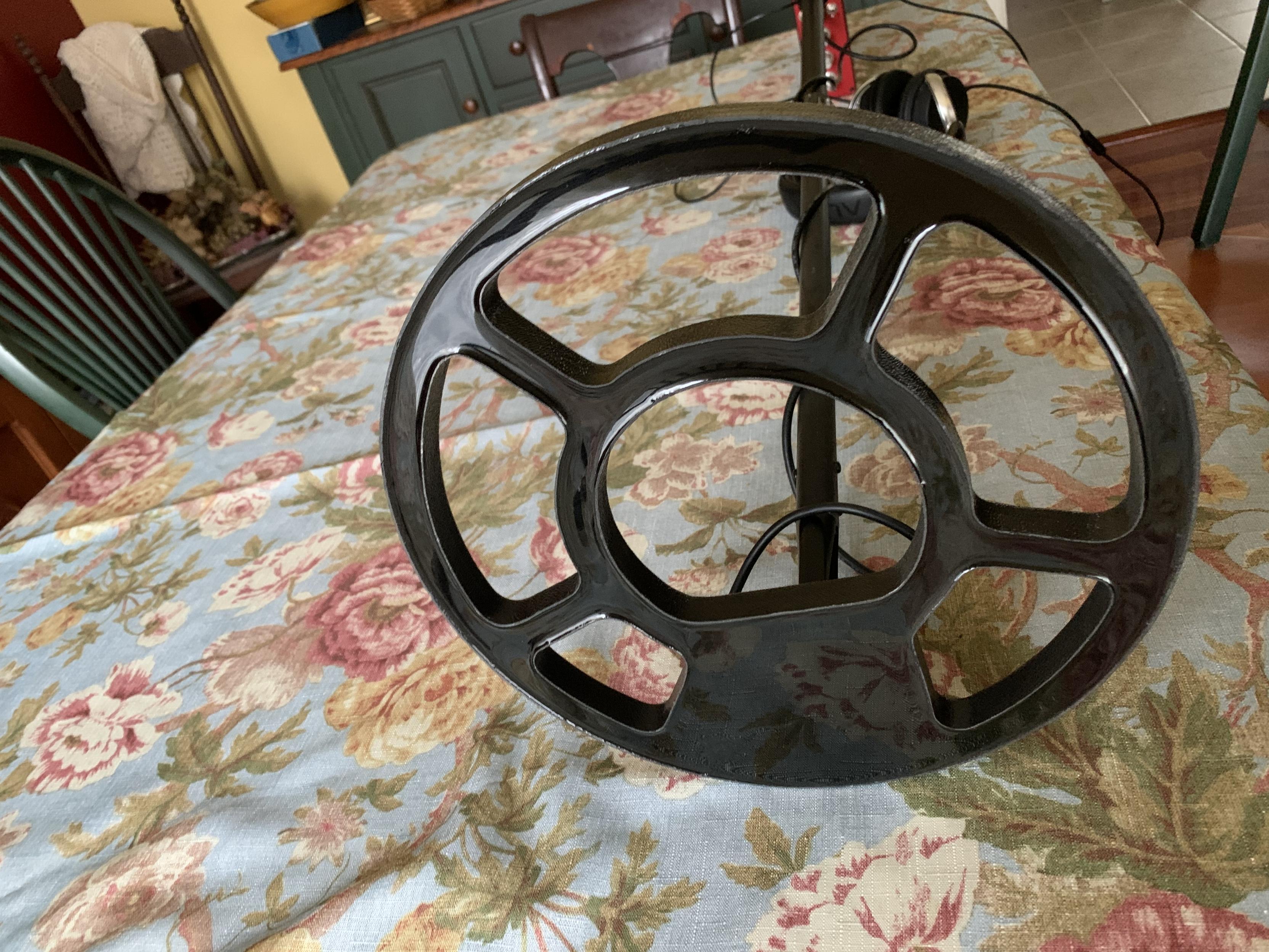

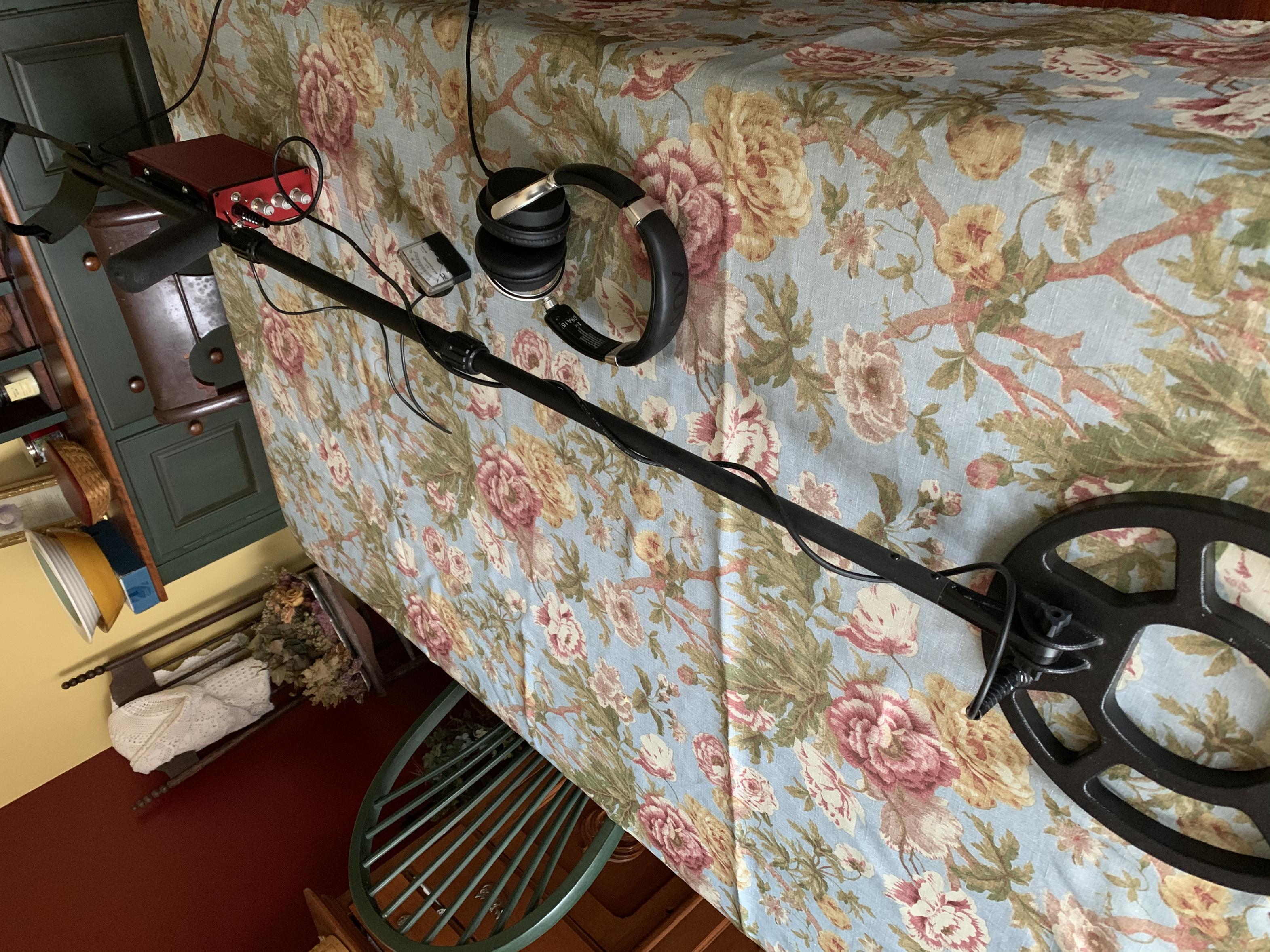

                      I didnt intended to divert attention from the VooDoo project as I am working on the same project as well. While waiting for parts I just built a coil and made a few experiments based on the book material. I was kind of caught off guard when a few members pick up the idea though. Since then, I moved my experiment off of a breadboard onto a messy prototype board and boxed it up. As it turns out, it works fairly well for adding disc to a common PI circuit. It can be adjusted as to either reject iron or ferrous depending on where the sample is taken. If the sample it taken to indicate the presence of non ferrous, iron will sometimes bleed through though with slight choppy meter movements while nonferrous is usually very smooth needle deflections. I would expect that though because iron often gives a double beep on the audio. Still easy to ID iron though. I have not posted any more corrections yet as I am still tinkering a bit. If I had to change anything I may go for a faster coil, maybe try to match the frequency response of the two channels a little closer and work on a more proper way to present the disc indication. The meter works just fine but is kind of crude. Also.. the modified surf PI circuit is just what I had laying around but I think there are many better PI circuits out there..
                      It handles the ground just fine which was my main concern.

                                While waiting for parts I just built a coil and made a few experiments based on the book material. As it turns out, it works fairly well for adding disc to a common PI circuit.
                                Great news! What resistance did you chose for graphite shield and how did you positioned the drain wire in this type of coil?
