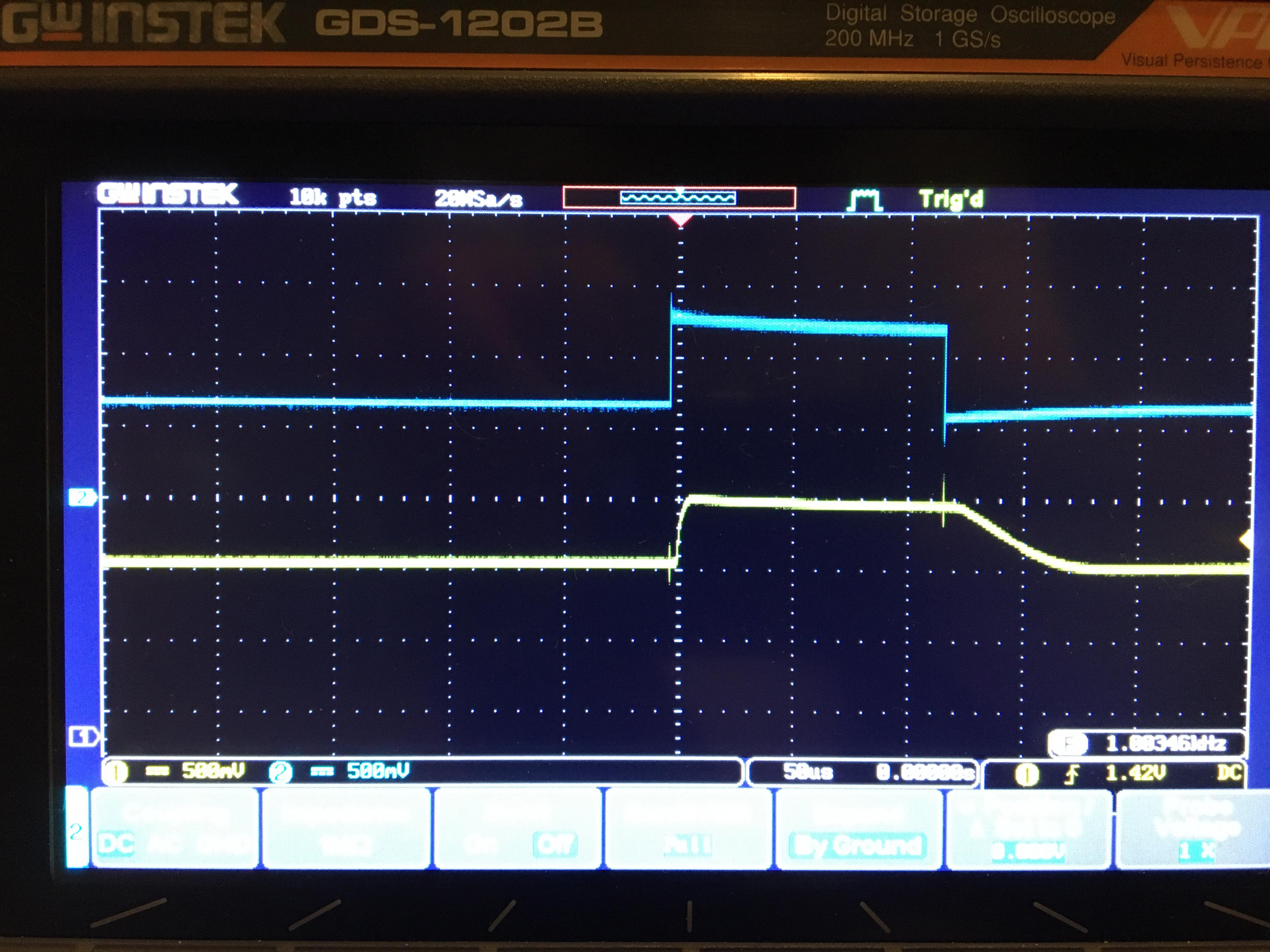

          • This is tp2 and tp5. I can move test point 5. like surf did in his video right and left and right in between for the noise. But the wave doesn'tClick image for larger version
ID:	359085 look right.

              • Originally posted by SilverSurfer17 View Post
                This is tp2 and tp5. I can move test point 5. like surf did in his video right and left and right in between for the noise. But the wave doesn't[ATTACH]54364[/ATTACH] look right.
                TP5 does not look like you have a coil connected.

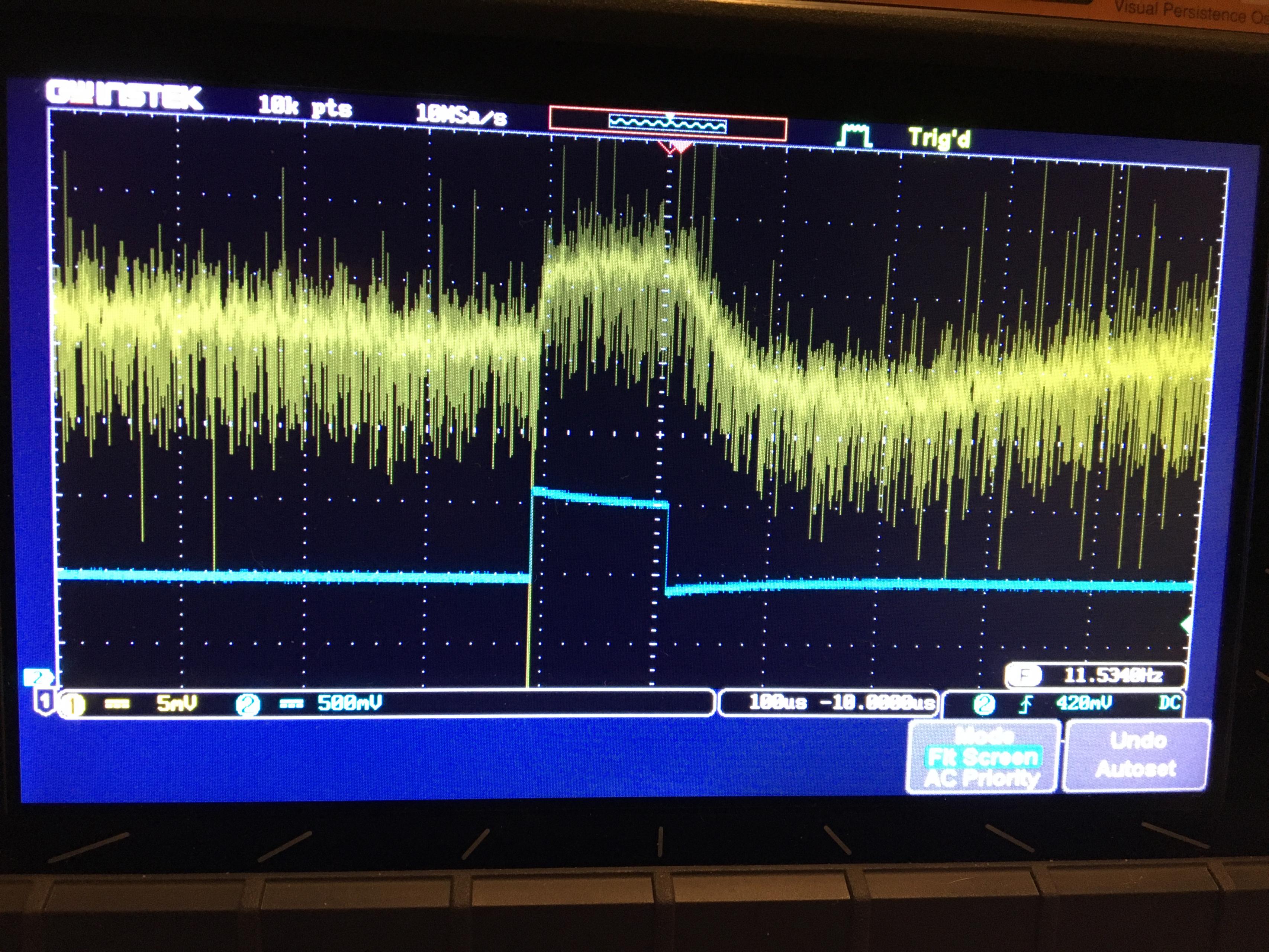

                            • You where correct i disconnected the tx loop and thought it was the rx this it with the tx connected Click image for larger version
