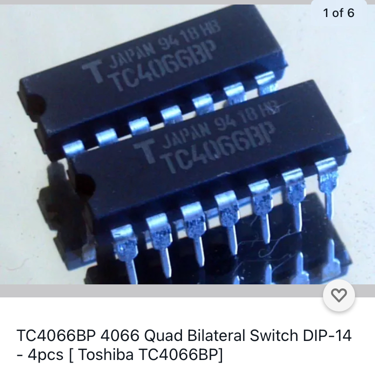

    • I made a concentric 8 inch coil and im just using the outside coil on tx to get pi working with no capacitor and the resistor jig but my output signal looks backward before a coil is connected wrong when connected and stage 1 tp3 looks really off no where near tp5 does
      • Im pretty sure i found the problem 4016BE bilateral switch not 4066BP !

ID:	359252Does the TC in TC4066BP make a difference ? It says quad
          • Originally posted by SilverSurfer17 View Post
            looking online i found a 4016 is analog only, and 4066 is bilateral, analog and digital
            but im new also, thats why im here trying to learn about what numbers and letters mean so i dont order wrong parts
            • Its says its a bilateral switch but its the wrong number and not what i ordered i started looking over my board with a magnifying glass after someone above mentioned checking parts before you install them and found it and the one thing i know with this already is you need all the right chips glad i installed all sockets

                • From what I've read on google most of the letters are company initials i think it said that come after the number and that TC is before it and i know the number is suppose to be correct and thats not so thats why im making sure before i order it
                  • Yeah i checked the numbers on the package i didn't bust out a magnifying glass and look at the chip but from now on i sure will what a head ache thanks
