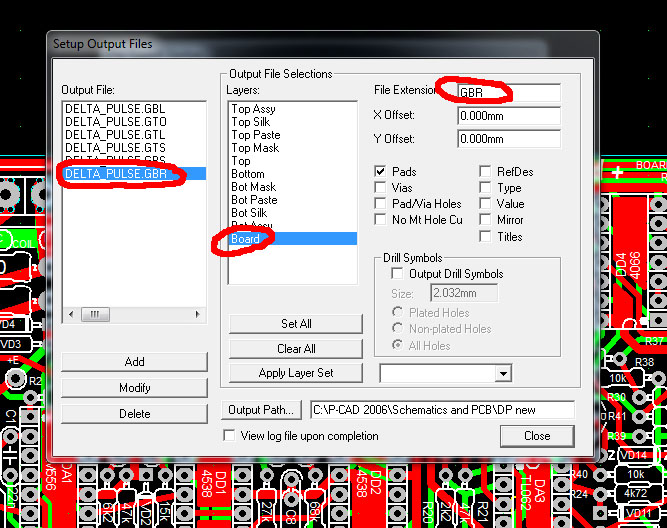

    • Has any one else tried to load the Gerber the files to https://oshpark.com/?
      I get to following critical error: "I can't find a board outline file."

          I can guarantee that the Gerber files are fine. Try examining them in a Gerber viewer (such as Gerbv) or uploading to JLCPCB.

              probably jlcpcb adds the outline itself on a base of edges drills. same politics. yes, there is not the file.
              while oshpark claims sure exact match https://docs.oshpark.com/troubleshoo...utline-issues/
              Gerber file extension Layer
              Top - top GTL
              Bottom - bot GBL
              Top Mask - smt GTS
              Bottom Mask - smb GBS
              Top Silk - sst GTO
              Bottom Silk - ssb GBO
              Top Paste - spt
              Bottom Paste - spb
              Board - brd GBR
              ==============НАДО==============
              GTO Top Silkscreen (text)
              GTS Top Soldermask (the 'green' stuff)
              GTL Top Copper (conducting layer)
              GBL Bottom Copper
              GBS Bottom Soldermask
              GML/GKO/GBR* Board Outline*
              TXT Routing and Drill (the holes and slots)

                  The board outline is included in each Gerber file. Try viewing the silk screen, top layer, bottom layer, etc., in Gerbv. You will see that it is there.
                  There's no need to fix anything.

                      sorry, George, board outline is always a separate file in files' pocket. this is just your understanding.
                      silk screen, top layer, bottom layer, etc, files are NOT for the board outline, not bringing relation to board outline.
                        You can provide the board outline separately if you like, but my preference is to add it to the separate layers. That's always worked with any PCB manufacturer I've used previously.
                          ok. i suggest you just to make the file and put it in general pocket. let the people go.

                          • OSHPark is expecting the outline as a separate file. I can still view them just fine. I got it fixed. And lets be clear, this is a proof of concept project. I am NOT expecting a polished and finished product. I would never want to pick on someone who spends a whole page in their book talking about magic smoke and the steps they went through to avoid it, but fails to label the polarity of VRaw (PL11) on their PCB. ;-)
                                EasyPC doesn't expect the board outline to be a separate file either. I had to create an extra Gerber plot for the board outline on its own.
