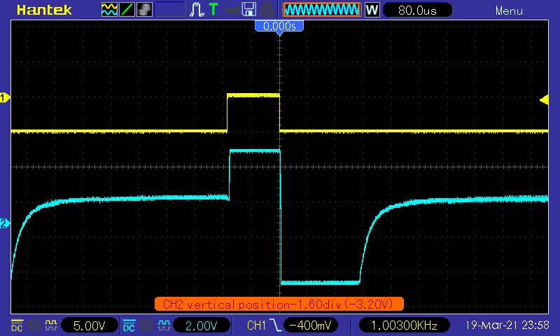

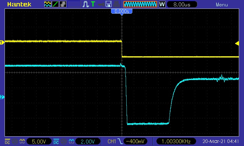

            • I did build this board in stages, and tested as I went. Lets just go back to the basics.
              TP2 & TP3 wave form. Per page 31 of the book, I should see a drop of about 20us, but I am getting closer to 224us? Pic attached.

                The "drop" on TP3 is when the pre-amp is saturated. If it was coming out of saturation in 20us before then check the clamping diodes, D2, D3.
                Also recheck the offset adjustment (R30) and look at TP5 to see if it is first or second pre-amp stage. Are the PL7, PL8 jumpers correct?
                Also take a look at TX coil and ensure Damping resistor is still doing its job.

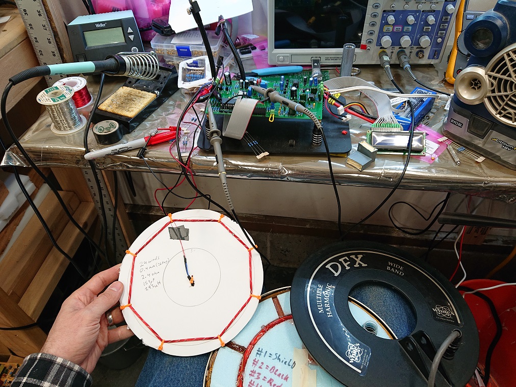

                • Thanks for the notes Waltr. I was able to track down the problem to the coil. The DXF coil has been giving me all sorts of problems. I used George's description for a "small concentric coil" (Pg 73) and it's seem to be working, and I am getting the same numbers as the examples in the book!!! Now I can do proper debugging.

                              • I will always do my best to report back, so others may learn from my failures.
                                I moved an 8lb sledge hammer over the coil and it detected iron.
                                I moved an aluminum plate over the coil and it detected non-iron.
                                I am ECSTATIC! Now I have a ton of work to get a proper coil up and running. But the circuit basics are up and running. I am thrilled.
