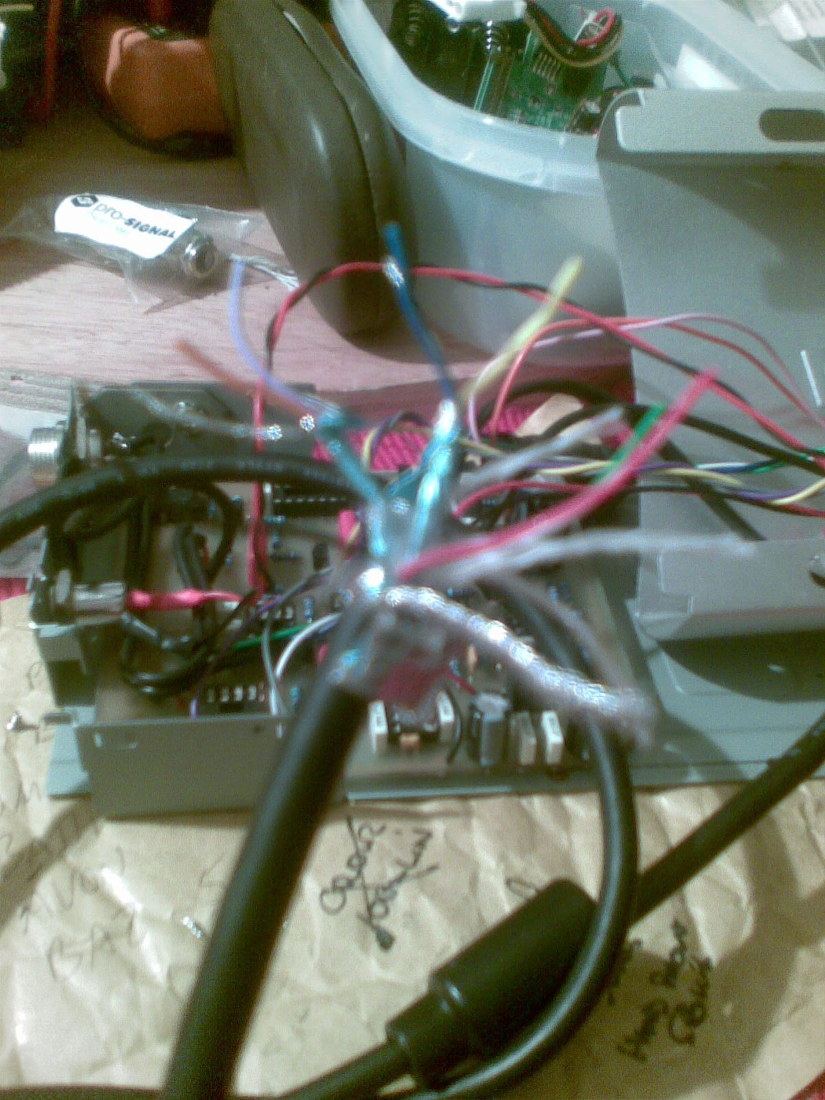

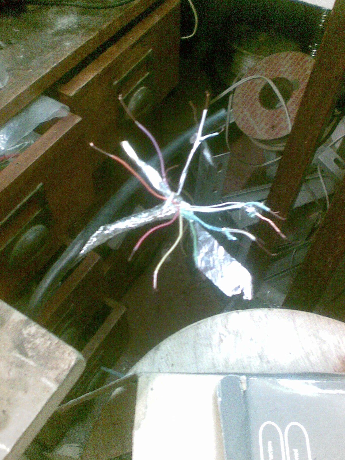

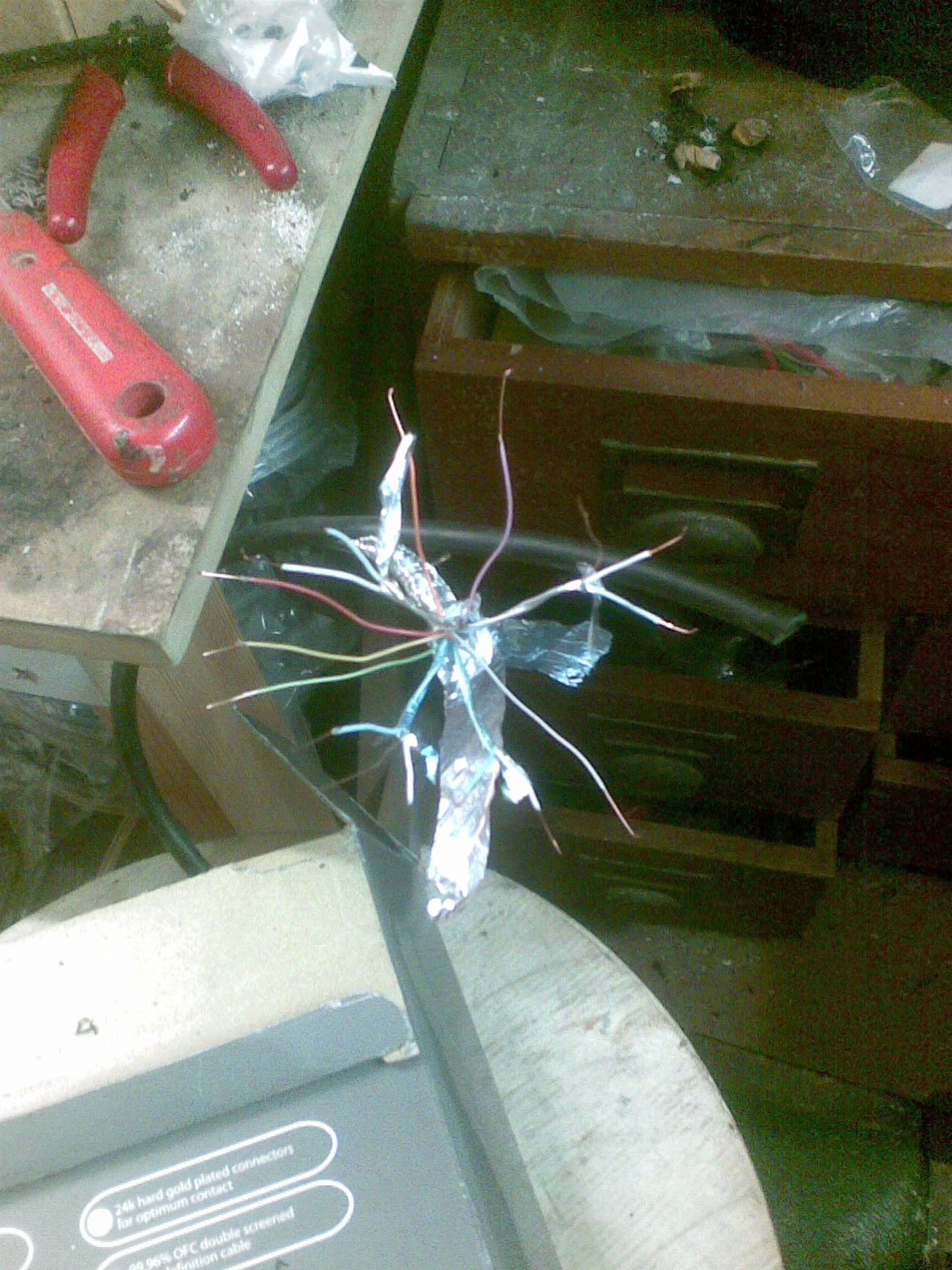

        Also opened up a faulty Labgear 20 meter HDMI lead with EMI filters both ends, can see why these cables are so exspensive with 4 shieldings on the paired cables which are insulated with something that is certainly not pvc and 3 shieldings on the remaining, will find out more.

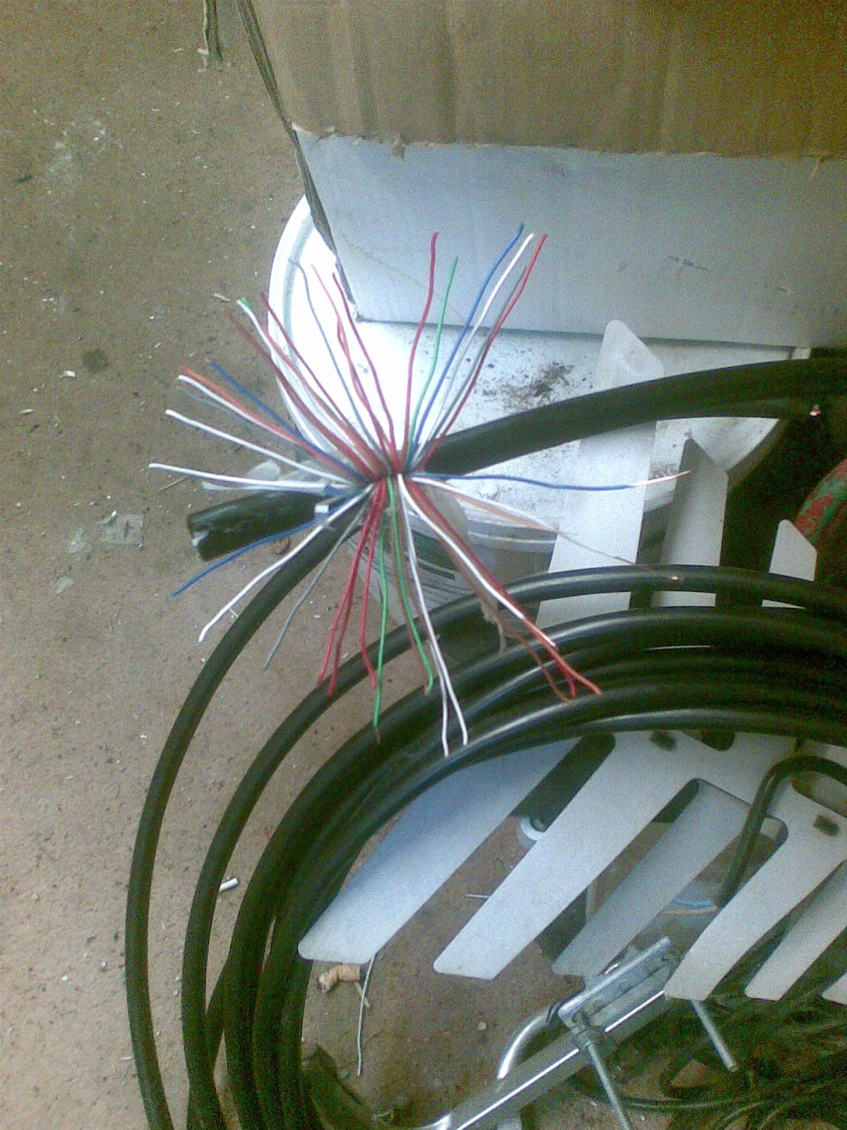

        The other cable is telecomunications which was given to me by a engineer on site where I was working its external 40 cores of solid copper strand, got about 10-12 meters of it, maybe coil making material.

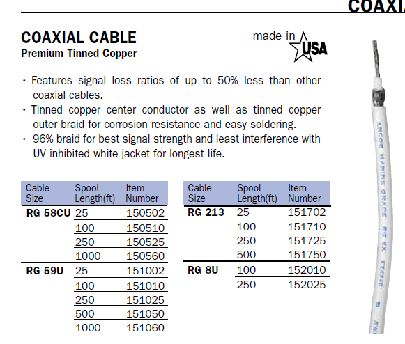

                  I just ordered some Ancor Marine Coax for my PI. Going to give it a try over standard RG58 with a multi strand center core, not tinned that I have been currently using.

                    RG59 has less capacity per length.
                      RG59 will give problems. It has a copper coated steel inner conductor which will give a strong and varying signal when it is near the coil. It is also a thin conductor and will break under flexing.
                      Eric.
