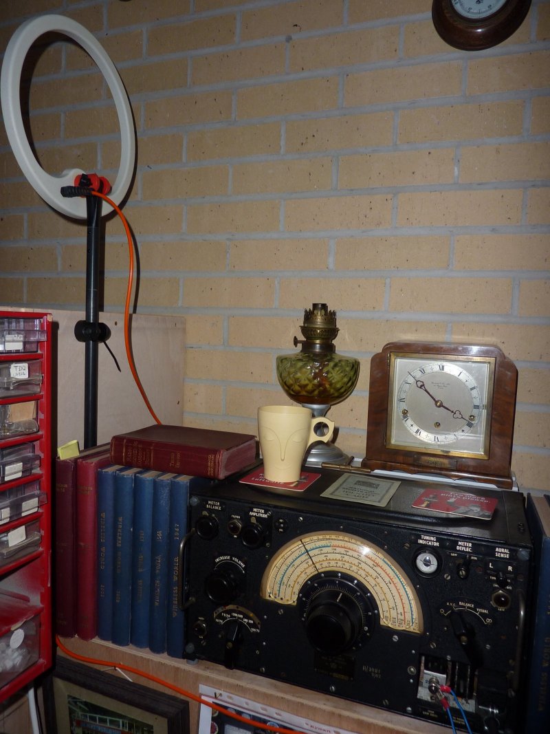

                • New Life for Old Monos
                  I was idlely thumbing through a 1944 volume of Wireless World when I saw something that looked a bit familiar. It was a schematic for a frame aerial that was balanced, i.e. it had a centre tap and could be connected differentially. One benefit, according to the article was that it did not need to be shielded, unlike a single ended winding. The article pointed out the benefits of a frame aerial, either shielded or balanced, as reducing capacitive noise, or the electric field component. Having a restored and working 1941 RAF Bomber Command radio, I thought I would give a wrap around lead tape shielded single ended 300uH mono a try as a radio aerial. Wow, it works much better than the internal 20ft wire aerial I have in my workshop. It is easily turned for optimum alignment to the transmitting station too. The electric noise, which seems to come from wall plug switched mode power supplies, solder station, fluorescent lighting, central heating controller etc is way down. Clear signals are heard right up to 18MHz, which is surprising. When I get a bifilar wound differential coil of similar diameter it will be interesting to compare - with and without shielding.
                  Eric.
                    Hadn't thought about that... I like this test, I'll add it next time I'm looking at OVR.
                    I add a 470K resistor from either pin 2 or pin 3 of the first amp., depending which one is active, to a test pin on the board. Inject 5Hz sine wave to give 1V pk - pk on preamp output and observe integrator o/p. If properly balanced the differential integrator should show little or no movement even when scope sensitivity set to 5mV. Then put up the frequency to between 10 - 100kHz to check that the gain recovers at preamp output to full closed loop value before the start of sampling. Dual amplifier arrangements should be fine.
                    Eric.
                        Eric.
                        Hi Eric, just before a few days I was trying a 11" minelab DD (TX winding), as receiver antenna on the lower part of LW band. Amazing and clear reception.
                                Eric.
                                That's a good EMI noise pickup configuration Eric. I love it.
                                Aziz
