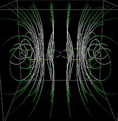

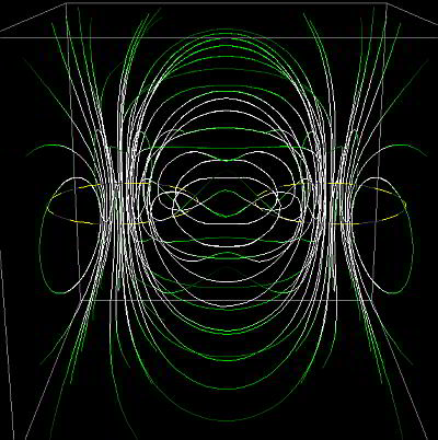

            • How about a bicycle coil. It comprises two Tx Rx combinations in two separate wheels parallel to the ground, where Rx coils are at 0.9 Tx radius. Both Tx and Rx coils are connected in series, only the phases are reversed at Rx to achieve IB, AI, and GB. The only trouble is that such contraption requires a real 4 quadrant gear to squeeze the most out of it. It is a true differential coil with distance between Tx coils of ~ 1 radius. It is a wearable configuration with coil sizes exceeding ~ half a meter radius. IMHO it is a perfect substitute for a 2 box.
              • Tandem coils
                Here are the Tandem coils, same phase and opposing phase
                Note the distance of the coils is not the same for the 2 pictures
                  This is about what I mean with a Tandem coil. A Tandem bicycle has 2 drivers. Tandem coils have 2 TX. It makes a big difference in the field vectors if the coils are same phase or opposite phase. The distance between the coils affects the field differently in either case.
                  But I think it is possible to achieve good AI, IB and GB, experimenting with the many possible configurations.

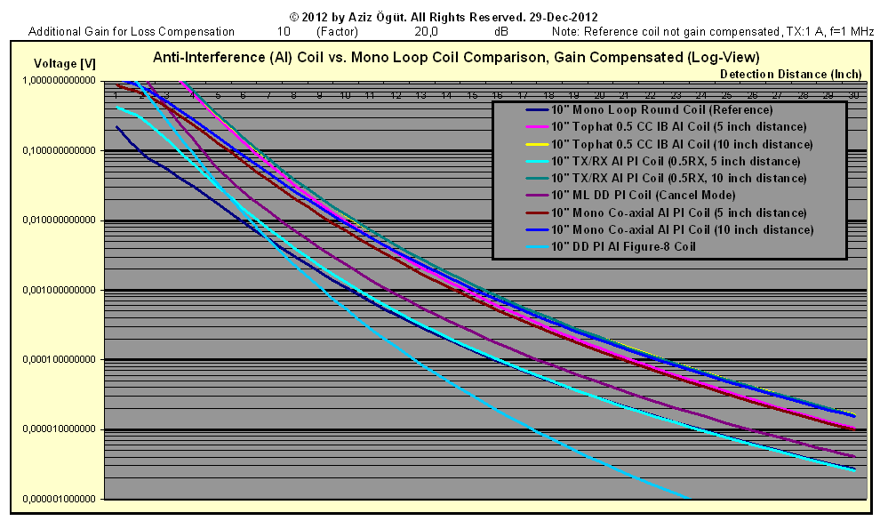

                        • DD PI AI Figure-8 Coil Added
                          Hi all,
                          the DD PI AI Figure-8 coil (TX=RX, formed as back to back DD figure-8, 300 µH) doesn't go deep even with additional gain of 10x. Forget this coil once and forever if you want to chase deep targets.
