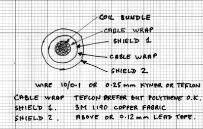

          • Originally posted by Midas View Post
            Hi Eric,
            Thanks for all your very informative posts of late. What exactly do you mean by double shielding ? And what sort of pre-amp gain were you running when you say you were 'nowhere near' saturation? How much do you think you could run before it did become a problem? I seem to remember reading on here somewhere that more than 50 could become a problem in some ground.
            Midas
            Hi Midas,
            I've drawn a X section showing the shielding. As the shields are concentric with the coil x section, there is only minimal eddy current generated in the shield, unlike if you put the tape, or coating, flat on the coil shell with the result that flux links with it. This is the most effective way to shield a coil from the emi point of view, but not cost effective for large scale production. Both shields, in the dual shield coil, are taken to the coax braid, as is the ground end of the coil. For the bifilar centre tapped coil there would be a different arrangement which I will look at in due course. The shield needs a small gap in it so that it doesn't form a shorted ring, otherwise you will get serious eddy currents. I once damped a coil by putting the damping resistor across the shield gap instead of the winding. Seemed to work OK.
            Depending on the current you want to pulse, the wire I have used may be a bit too thin, but of course, this method of shielding is for any coil. 1190 copper fabric tape is hard to get now, and lead is even harder as it is classed as a hazardous material. I still have some for my own experiments but there are no doubt materials that are as good. Beware nickel tape though, as being a magnetic material, you do get a small, but constant decay from it.
            The preamp gain I used was x500. You would run into saturation on the later dc amplification stages long before the preamp caved in.
            Eric.
              Eric.

              some kind of coaxial cable?
              Eric, what material do you think that will be the best for this "type" of shielding, regardless the cost or availability?
              • CAT5e UTP cable. Just don't forget to leave a slit in a shielding at some place to avoid short circuiting your coil.

                • Originally posted by Bill512 View Post
                  It all comes down to conductivity. The woven copper fabric 25mm wide tape I favour has a resistance of 1 ohm per 300mm. It has an adhesive backing which keeps it in place and it is solderable with care and not too much heat. Another candidate which is often available on ebay is 3M Scotch 24 tinned copper mesh tape. This has a resistance of 5 ohms per 300mm, but has no adhesive backing. Plain adhesive backed 0.05mm copper tape is no good as the eddy current signal generated in it persists for about 30uS even with a gap. It's resistance per 300mm is <0.1 ohms. Basically, look for a solderable adhesive backed tape that has a dc resistance of between 1 and 5 ohms per 300mm.
                  A search of web sites that deal in EMC products may come up with some useful material which I don't know about. I have enough NOS to keep me going for a couple of years on development projects, so I haven't been looking.
                  Eric.

                        Hi Mida
                        Eric.

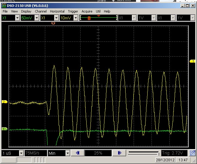

                              Hi Midas,
                              That is interesting about the Kynar having a bad DC. I just assumed that having a fancy name it must be better than PVC. Goes to show - don't just assume anything; check! All my coils now are wound with Teflon wire as I bought several large reels of different gauges from a company that closed down. I also have some stranded Litz of the same equivalent gauge as 0.25 solid. I wound two otherwise equal coils and saw no discernable difference in performance. For higher current pulses I use stranded Teflon insulated high temperature wire. This paper, and others in the references, could explain why Litz doesn't give any advantage in PI detector coils.
                              http://engineering.dartmouth.edu/ind...trandedopt.pdf
                              What is the resonant (ringing) frequency of your coil + cable.

                                I pinged it at around 1.4mhz before I added the shield. I have no real cable on it yet the coil just goes straight into the TX board.
