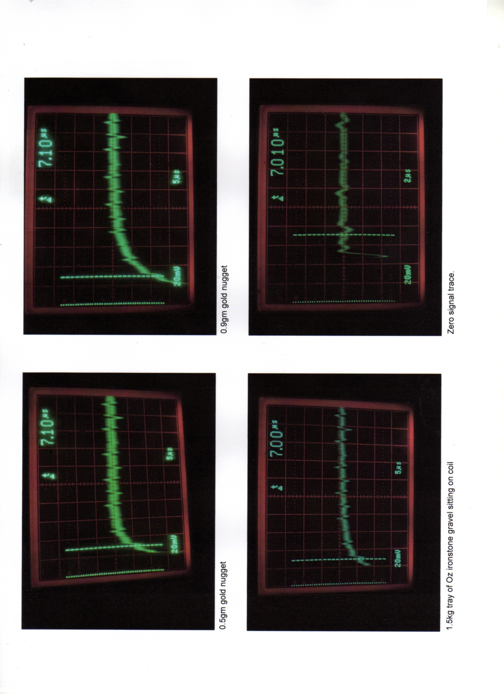

            • Eric

                      • I hate maths too but programming like the above is a step too far. Still it's good to see Aziz having a go, and coming up with some interesting results. I was personally pleased to see that the Dual Field Coil came out with some benefits exactly the way Whites and I had hoped. Didn't lose much in depth, but improved on the pinpointing.
                        I have had a less brain numbing day doing a few more tests with the bifilar differential arrangement. I think now that I am losing some time in the slower than optimum recovery of the 5532. I'll try a couple of LME49990 as I have already seen an improvement in one of my other detectors by using these. Anyway, here are some pictures of scope traces with the cursor at 7uS. Which is where I am sampling at the moment. See the benefit of early sampling for the 0.5gm nugget where there is nothing left after 20uS. The 0.9gm nugget goes on for about twice as long. Both nuggets were close to the coil winding to get sufficient signal.
                        The tray of gravel, which covered most of the coil area shows a typical viscosity response. An initial fast decay which slows up as time goes on. Even at the far right of the screen, it is still not quite back to the zero line.
                        The last picture is the no signal response of the coil and preamp. The spikes along the trace are breakthrough from the clock generator. Some of the wires going out to the controls (frequency control especially) should be shielded to prevent this. Anyway, this is just a lashup on the bench to see what works. The spikes don't interfere as they are synchronous.
                        Eric.
