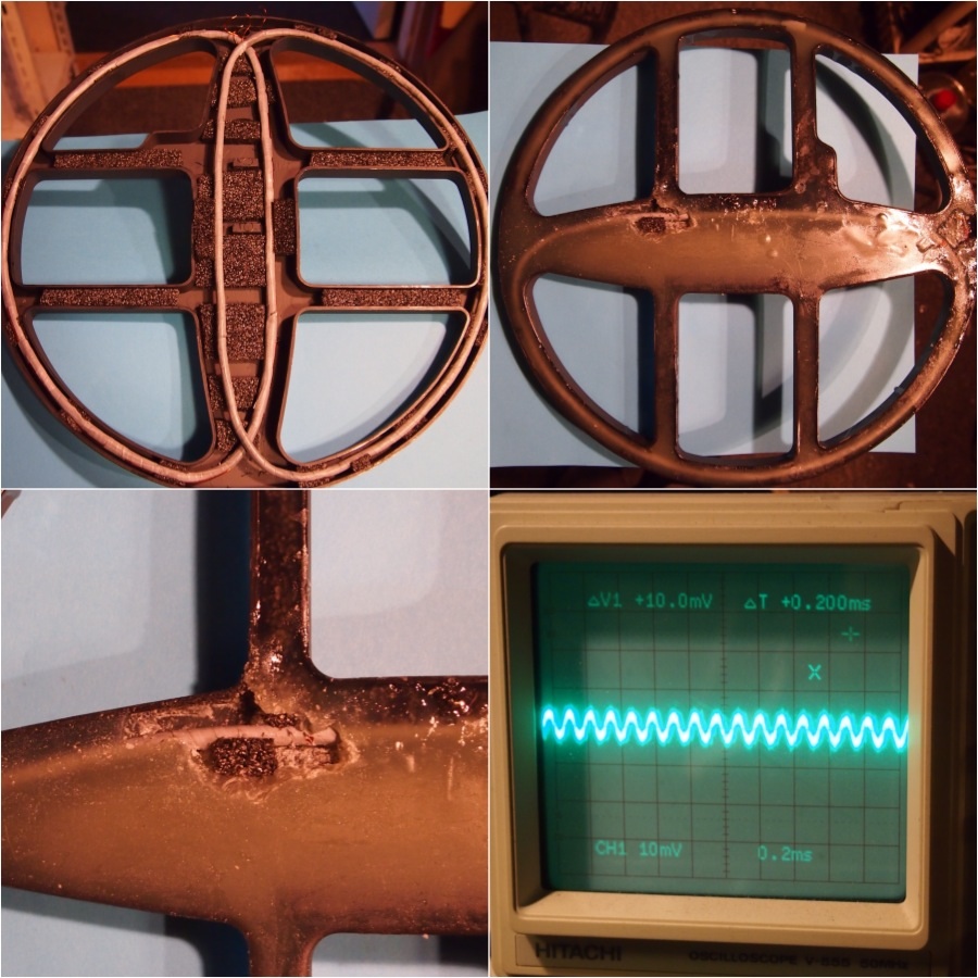

Allmust finish my first coil. Had some trouble to keep the best Null,( with out a small foil and Ferrite) so I had to open the epoxy and gently move the coil, because when the glue/epoxy hardened my best Null slowly got off.
The Scope shows my best Null, pp 5mv. (The prope was 1:1).
The coil's weight went up to 750 grams (13"), and my 11" Stock coil is 600 grams. Not so bad I think. Tryed to use a lot of this foam to keep the weight down. To morrow when the is hardened, I will try some foil and ferrite, before I close it.
The first foil test I did this evening, seem to that I Maybee lost some little deept.. But I am not sure.
