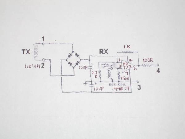

    I'm in the midst of reading/researching coil building with the intent of making a very small sniper style coil for my Sovereign GT. I do have a background of both self taught and formal training in some aspects of electronics, but the field of coil building is going to require me to do a good bit of reading to fill in the blanks. Just printed out about an inch high stack of threads from the Geotech forums that should help along those lines.

    Some other questions to throw out there for now- I have both the old and newer schematics of the pre-amp circuit found in all Sovereign/Excalibur coils. Is there any performance differences between the two that anybody has been able to see? In relation to the pre-amp, in such a small coil potentially as this, would there be any benefit to mounting the pre-amp off to the side of the coil to avoid interaction with the detection field as much as possible? I would suspect it would be beneficial to get the pre-amp circuit as far away as possible, but not so far that the weak RX signal has any chance to degrade or pick up distortions. If so, I'll probably put the pre-amp past the bottom of the coil so it hangs of it's tail.

      I'll be the first to offer comments. "short cuts" will lead to disappointment, avoid. Wire is cheap, don't re-use previously used self-bond wire. Design the coil properly, ie. CORRECT coils inductance/resistance, don't rewind whatever wire you have to hand. DD coils don't need any more than the two coils, but commercial manufacturers find it better to use a nulling loop, possibly for speed/cheapness. You can't 'listen to the null of a search-coil' in any simple way, a scope is the best tool, the DC demodulator outputs could be used (DVM monotoring), but you don't have easy access to them.
        Scope is a must. You may get it "working" without a scope but it won't be zeroed in. I agree with Skippy don't cheap out. You will have to invest in different gauges of wire and a good scope. Gauge and turns will be way different from a 10 inch stock coil to a 4x3. It may not even be possible to make a DD that small? The coil will be extremely thick. I use 21-22awg for my TX and 29-30awg for my RX but my coils are much larger then a ML stock 10 incher. Shoot for .440uH and about 5R using the AD797 on your pre-amp for your RX. But like I said your gauge wire will be different. For my larger coils I'm about 25 turns RX and 40 turns TX but it varies and again yours will be different on such a tiny coil. Don't forget about shielding there are many methods you can try. Coil is useless without proper shielding.

            Factory coils TX read about 1.01uH and just under 2 ohms for your resistance.

                It appears that TX has twice more induction than RX. Interesting why? May be preamp helps to reduce it. In regular VLF detectors RX has more windings than TX.
                Also schematics I have found for preamp is here: Click image for larger version
Name:	Newer Sovereign Coil Pre-Amp Schematic.jpg
ID:	338538 Probably several variations are circulating over Internet.
