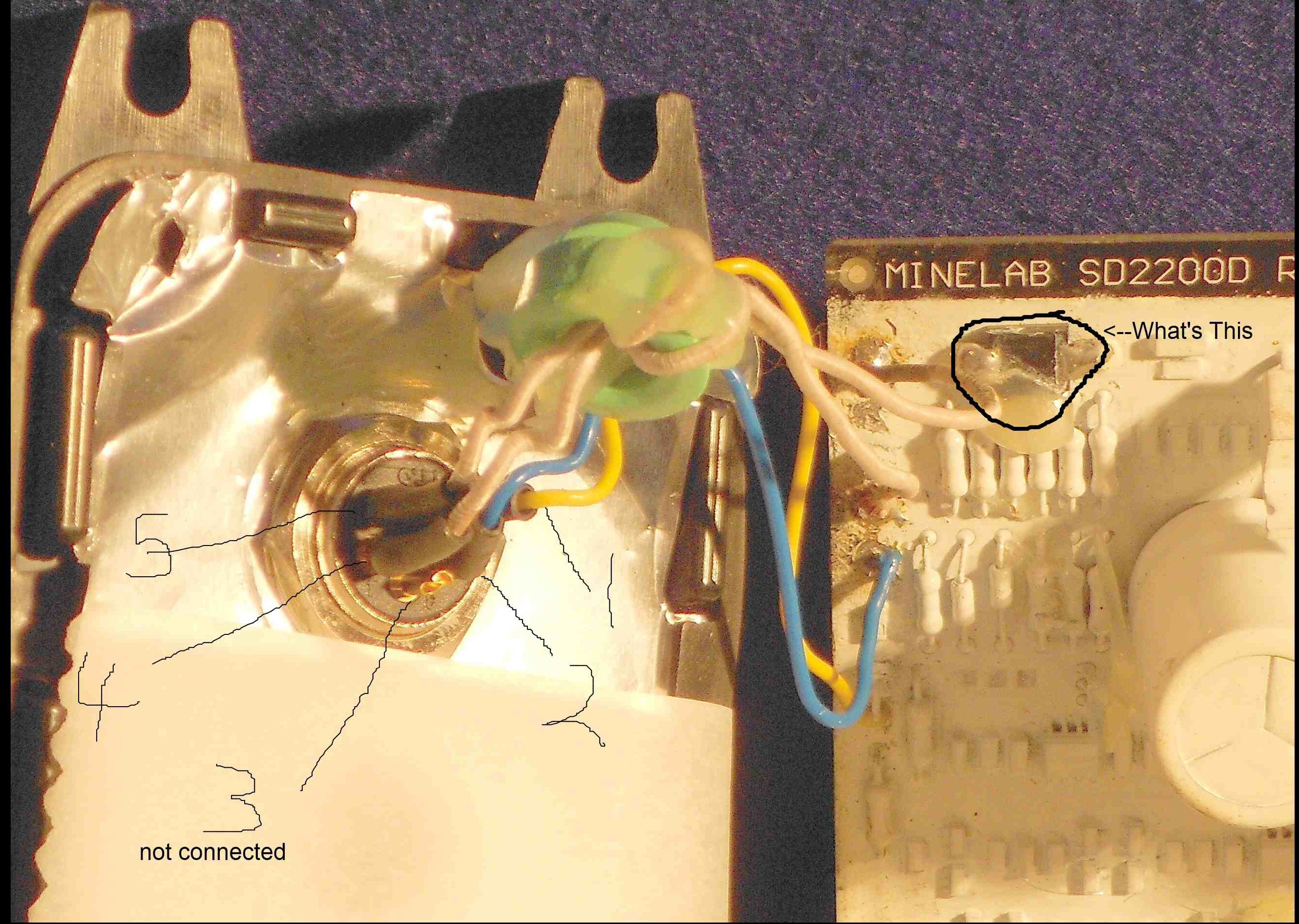

          Problem: when the sd2200v2 is turned on it goes through all its testing and such and when it does the final 3 beeps it starts
          Wailing/Warbling and won't stop and it won't pick up a tin can lid at 4". I was using the Coiltek 250mm Mono and I tryed the
          Stock MineLab DD that came with it, and still the same. I sent this machine to Woody last year in June and David repaired it.
          When I got it back it sat till this Feb when I hooked it up to test it for this years detecting and it's making the same sound it did
          last year.

                    Ok, for a start, have you tried it with the mod switches in the centre position?
                    Now get your scope, hook the ground lead to the test point between the 2 thick coil wires, this is detector ground.
                    Hook your probe up to the ( with the board edge that the coil wires are coming from toward you and the coil wires on the left hand side) test point to the right near the trim pots, but the one closer to the centre of the board. set your scope to 100mv/div(probe x1) and about 100us.div. You will be able to see the decay curve, grab a large metal something and move it onto the coil, the decay curve should move a lot. If not you have a problem in the front end and we need to scope it further.
                    Just do this with a normal coil.
                    Cheers Mick

                            Mick, I don't think that bumping the case has anything to do with the sound. I have it apart now and am setting up the Scope to use.
                            here is a pic of the Coil side of the end cap and upper left of the board. My other pics I posted last year on the Noiseless Thread are still there also.
                            Pins 4,5 are White Pin 3 isn't connected and Pin 2 is Blue and Pin 1 is Yellow. Anyone got any Ideas on what the Pins are????
                            Any Guesses on what the IC is in the upper Right is??? NO markings and apears to be only 2 Pins.
