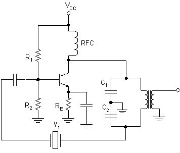

    alternate oscillation methods can we discuss the pros and cons of the various method's or even discuss a hybrid method say a colpitts using a cystral as a referenced point.
    I don't know if any commercial detectors do this (it is likely), but injection-locking a free-running LC oscillator to a stable reference should produce a low-distortion transmitter with high stability. The source of the reference would normally be a divided-down quartz crystal, but could be microcontroller-generated.
      Crystal-controlled Colpitts oscillator
      http://wps.prenhall.com/chet_paynter...26330-,00.html
