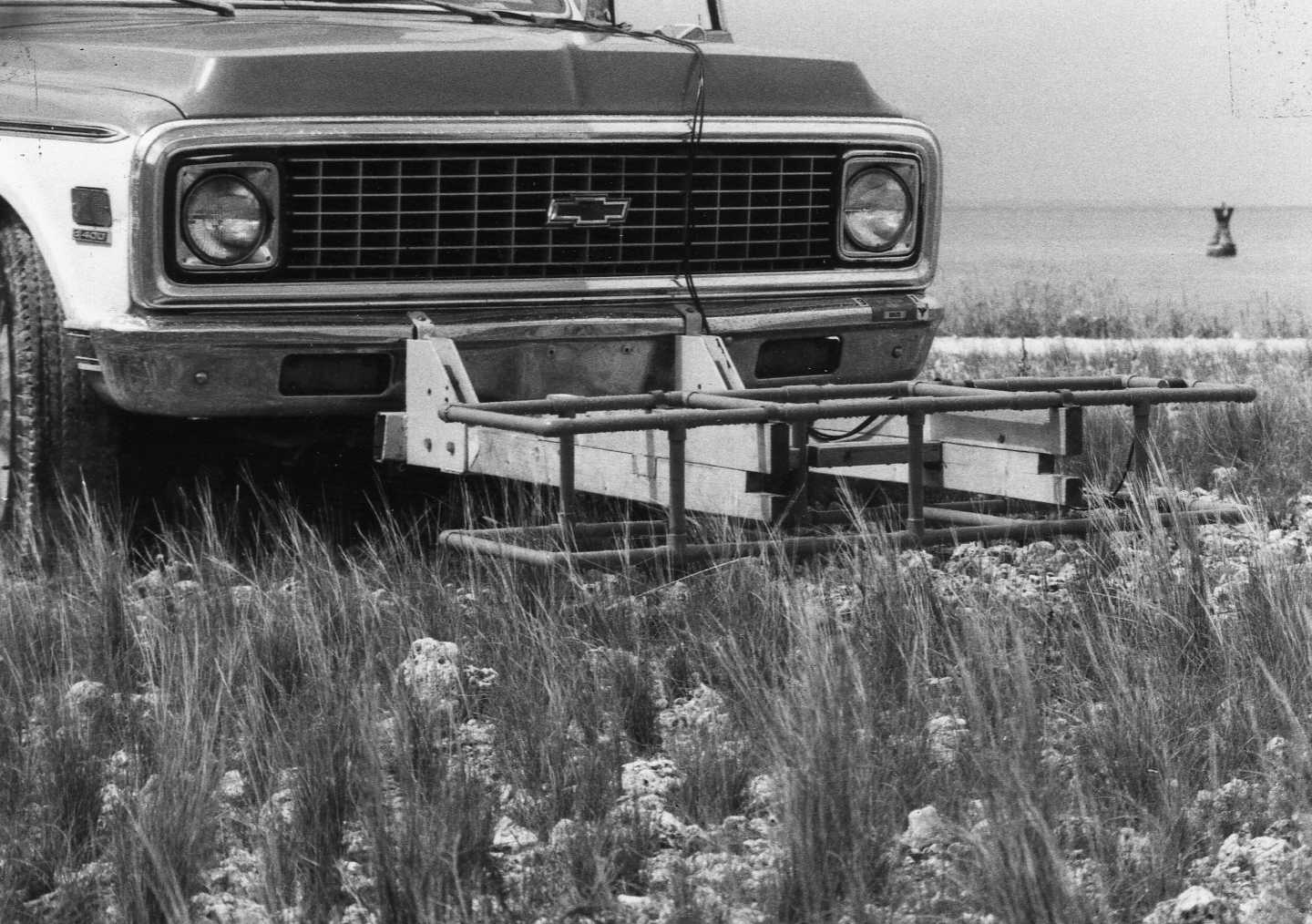

        Hi Bernte,
        I don't have a Lorenz coil, but assume that the principle is the same as I used in 1980's for a vehicle mounted detector. I would think that the two cables go into a multi-pin connector where two of the pins are dedicated to the subtracting receiver coil. I used a separate connector for each coil.
        Eric.
