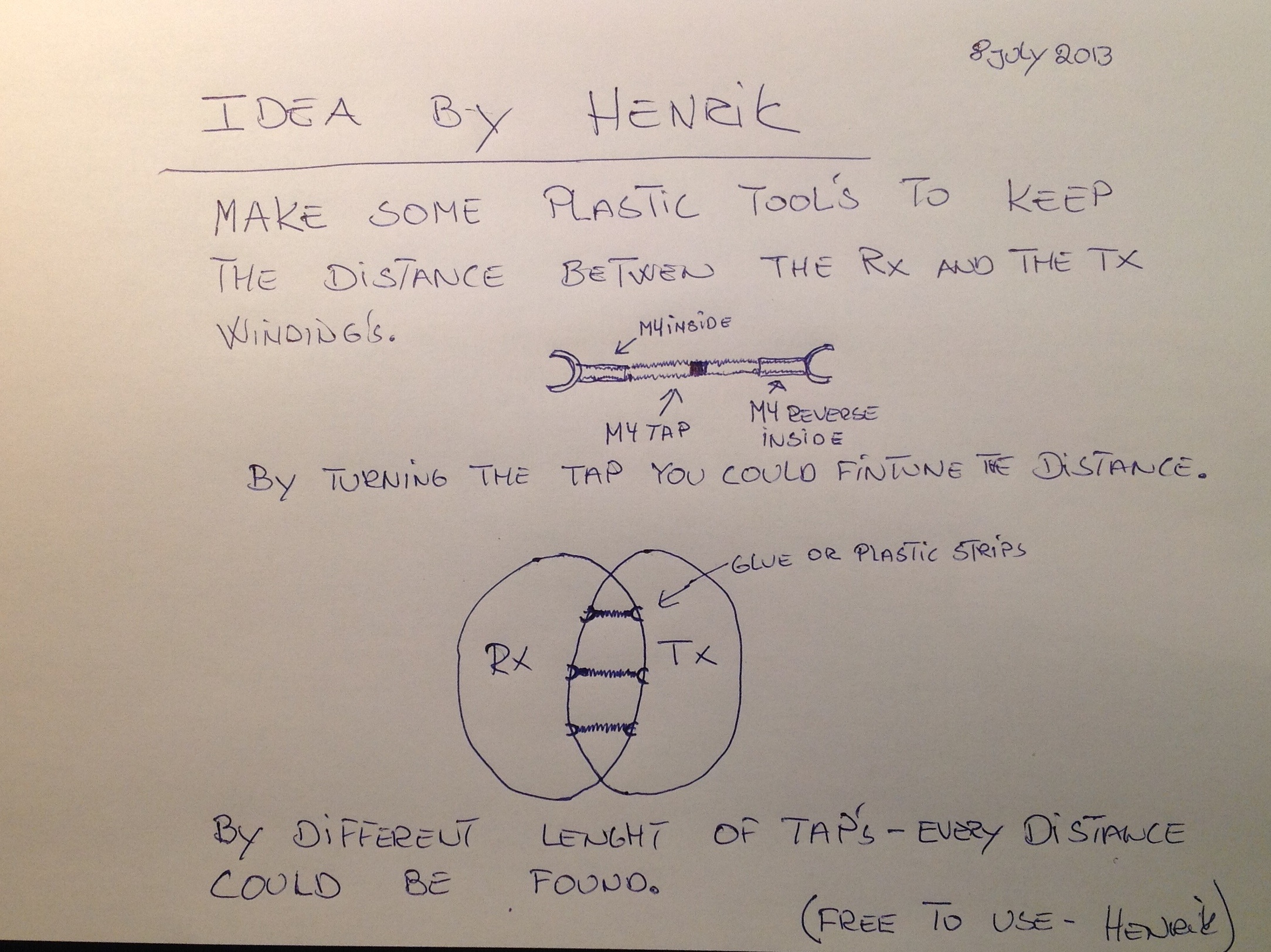

    My problem was not to find the Null, but to keep it.
      Idea to keep Null
      Look at the picture
