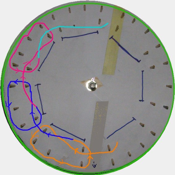

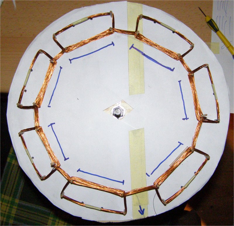

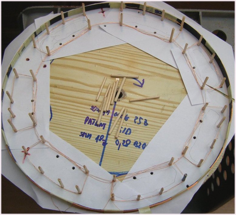

    The other day I spent a few hours looking around this site
    using google translator, the site has a few interesting things on it
    including this strange but interesting PI or vlf coil design
    has anybody tried it ?
    Supposedly it is a low capacitance coil.
    http://www.hq-elektronic.eu/menu_jarz.html
    With proper outer to inner radius ratio, this setup can exhibit anti RFI behaviour. Note that the inner NI product is twice the outer. The same result could be achieved with less fuss though.

          Why such a complex system? Dangle just CX with TX and PX is connected in series. There is no difference. For the PI System strange ...There are no miracles in these sensors.
