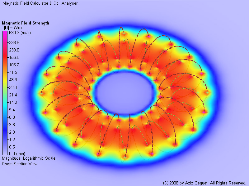

        PS. What software screenshot is on your avatar, it is Field Precision?

          Re: Avatar screen shot
          It's just the magnetic field strength of two torus coils (has nothing to do with metal detector coils). I haven't changed it, well, I'll keep it so you can recognize my posts easier.
