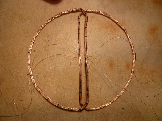

    I wound my first DD coil for TGSL. I was done, first coil 5.9 mH and second coil 6.4 mH.
    But I think I have both coils spoiled.
    To stabilize the coils I used Superglue.
    Suddenly they changed induction.
    First coil: 6.6 mH and second coil 7.2 mH. I could cry ....
    Are the coils to use still? Or for the trash?
    I guess the Superglue acts as an electrolyte in a capacitor (?).
    Dirk

    The TGSL is quite forgiving as regards the exact inductance values, so the coils are more than likely still usable.
    I would suspect the superglue contracted as it dried, pulling the windings closer together, and hence causing the inductance increase. Worst case, you may have to tweak the tuning capacitor values.
      It will work perfectly even with original capacitor values because both coils acted same way (as expected), and only a resonant frequency will be slightly lower - no big deal. The effect is well known for decades, and people used to improve their coils for RF purposes using a Q-dope, which is not very different from a super glue.
        Thanks Davor and Quiaozhi for the hints! I am comforted. Coil development makes a lot of work. Wrap, measure Industance. Mostly it is not entirely true. Then adjust and so on.
        So I have to wrap tighter next coils? And then treating with Superglue?
        A big thing is the coil Calkulator from Quiaozhi. This one has been the possible turns. Great help.
        Next, I will make coil nulling. I will abide by the instructions on the page 52 ItMD (Experiment 5-6).
        Is that all exciting! I'm always learning new things!
        Dirk
          Hi Dixit. My experience is that if you changing a bit the shape of your coils, you can change the inductance. Make them a little more elongated or wider and you can correct these variations of the inductance.
          Fabián
            Yes.
            You may want to wrap a coil here and there with insulating tape that is stretched prior to wrapping. It is a proper way of using the insulating tape BTW. You always need to stretch it prior to wrapping so that it squeezes the wires you wrap.
