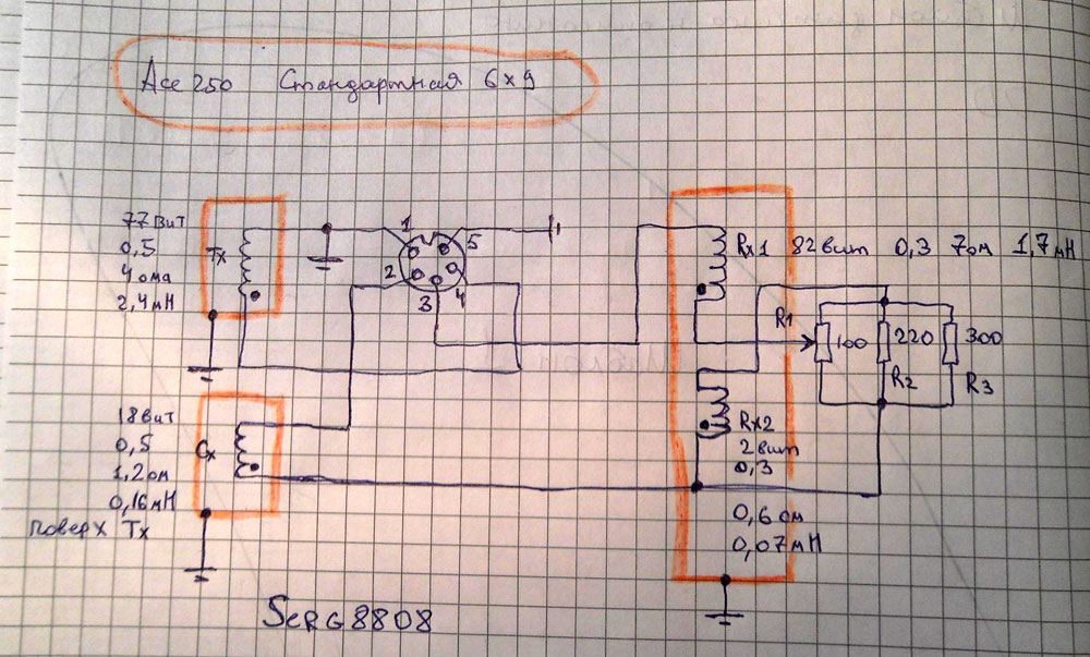

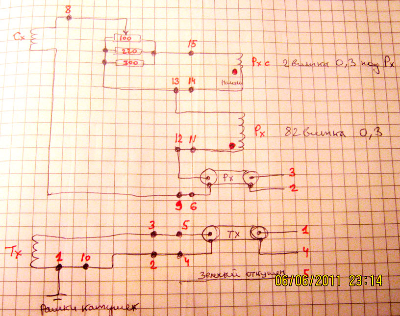

    I made a clamp meter probe to see current in tx coils using a Wurth clamp on core - its very effective (not calibrated) as a relative measure. When I approach a 250 running I see the Tx signal - as The clamp faces touch the Tx signal reduces to nothing and disappears?? Is the 250 Tx coil a bifilar - so sums to zero?? If true how does this put a mag field out - if locally sums to no mag field??? S
    Found it on Russian MD forum:

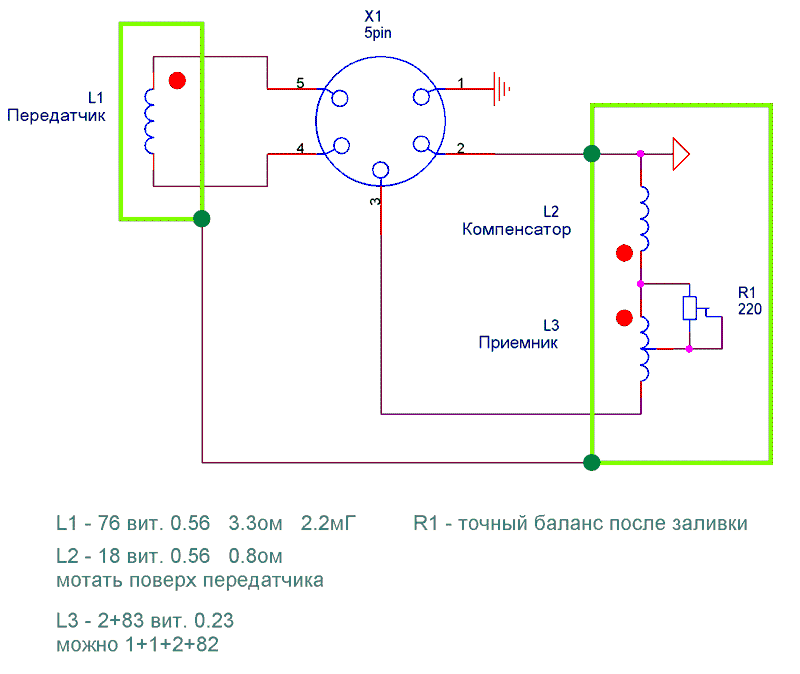

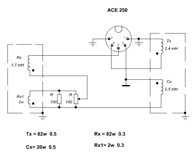

      in your archive. from our table - to your one.
Name:	ACE_250 coil_sch.gif
        perhaps there is serbian translated version... i am not able to find it... on 2min 50sec of the video the coil board seen
          Hmm maybe the buck is co located on the Tx coil so thats why I saw the Tx field go to zero when the current clamp closed around the Tx loop part of the coil head.
