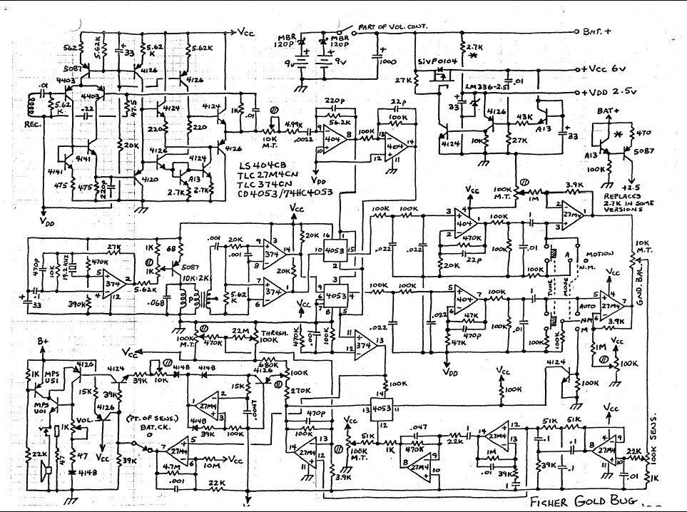

    Here's the schematic. If you know the frequency you might be able to figure the inductance's...
    Oops this is the older model. Yours might be different. The manual for the new one says 19Khz.
    You would have to put a scope on the TX and see the frequency and amplitude of the transmitter
    to see if it needs tuning and look for the RX tuning cap...

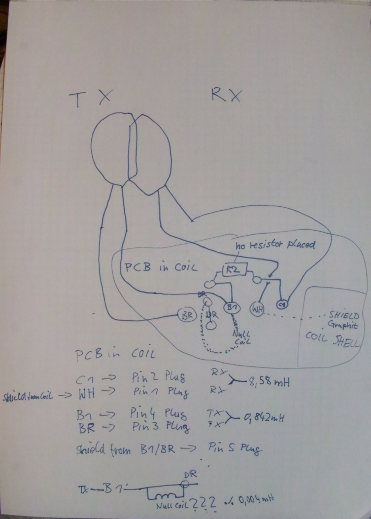

                  please

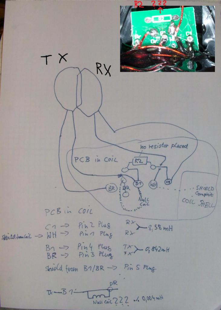

                  can anyone check the pin connection inside the connector plug from the real original coil
                  where goes the shield?

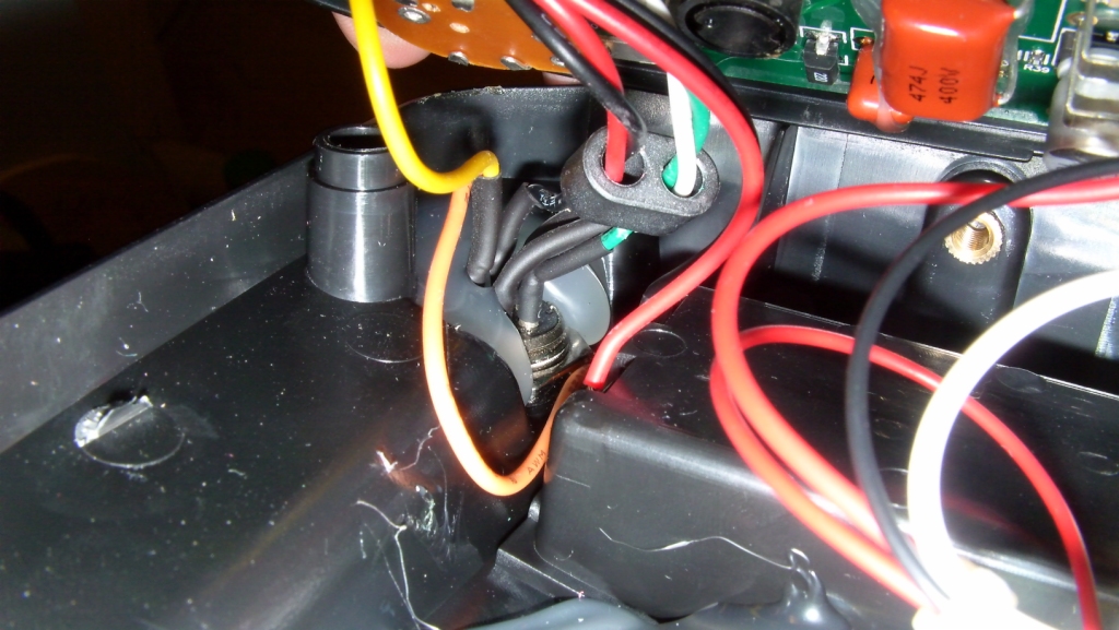

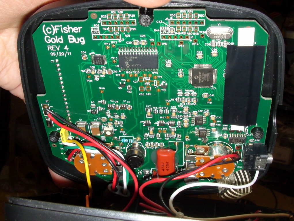

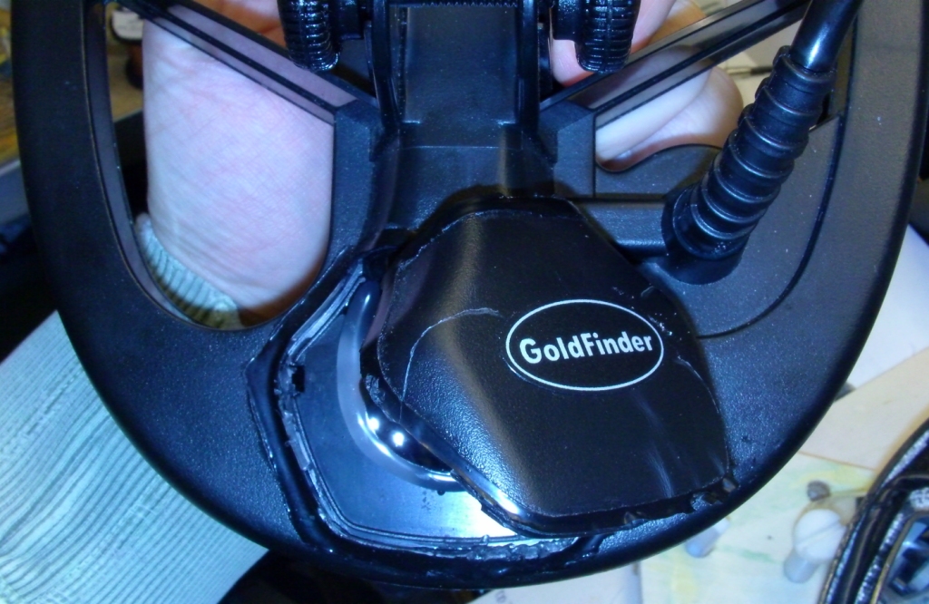

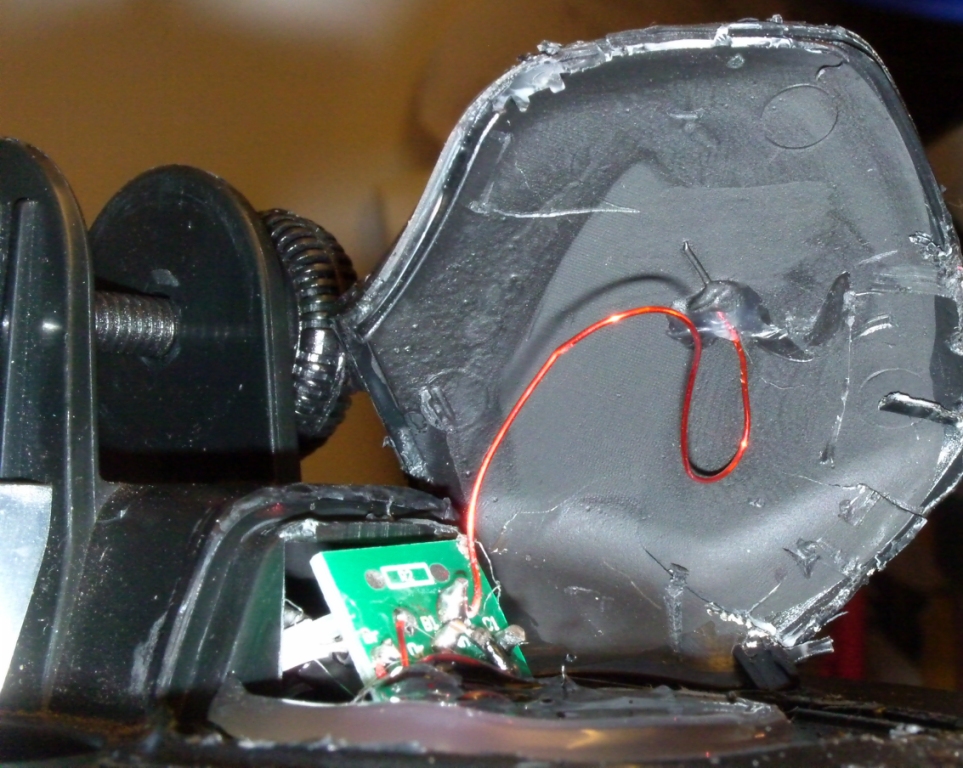

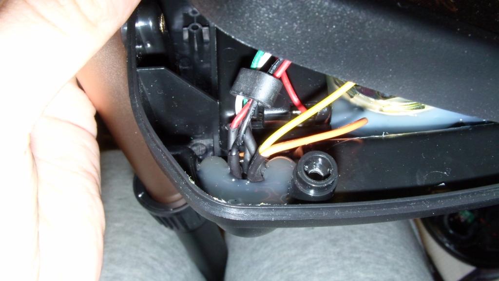

                    I have got an original Teknetiks G2 Coil (a quite early sample).
                    Messurements made with Voltcraft VC940 (quite good device).
                    R Pin1->2 (and also reverse) = 53,2 Ohm
                    R Pin3->4 (""") = 2,0 Ohm
                    Cap Coil12->Coil34 = 0,27nF
                    Cap Coil12 .> Pin5 = 0,283nF
                    Cap Coil34-> Pin 5 = 0,362nF
                    Cap Connector Case -> any other Pin = 0,0xxnF (negligbible)
                    Coil 1-2 determined with series resonant circuit with C = 9,03 nF; f (res) = 17,5 kHz -> 9,16 mH
                    Coil 3-4 determined with series resonant circuit with C = 76,025 nF; f (res) = 19,4 kHz -> 0,885 mH

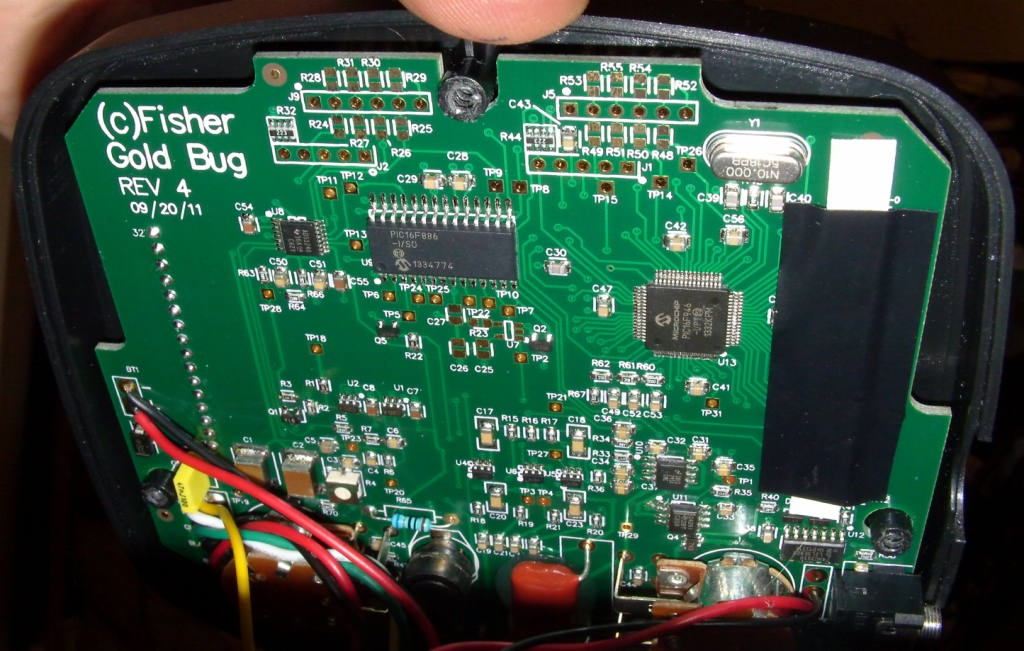

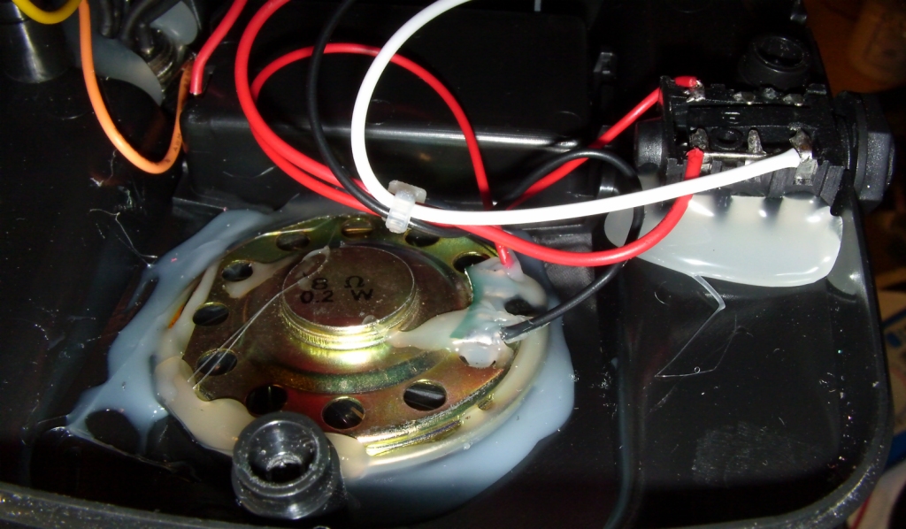

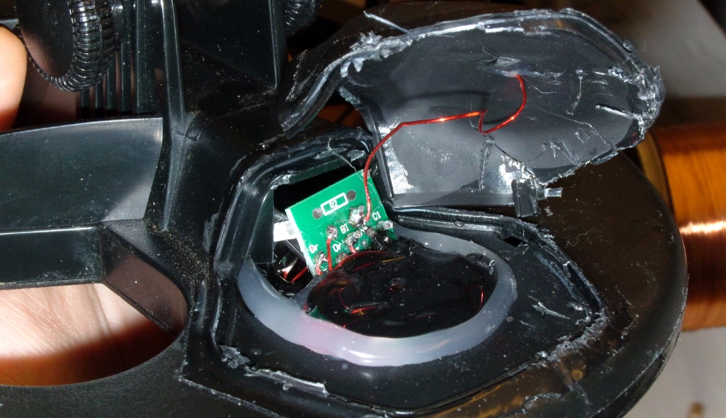

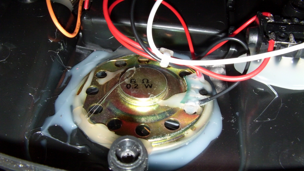

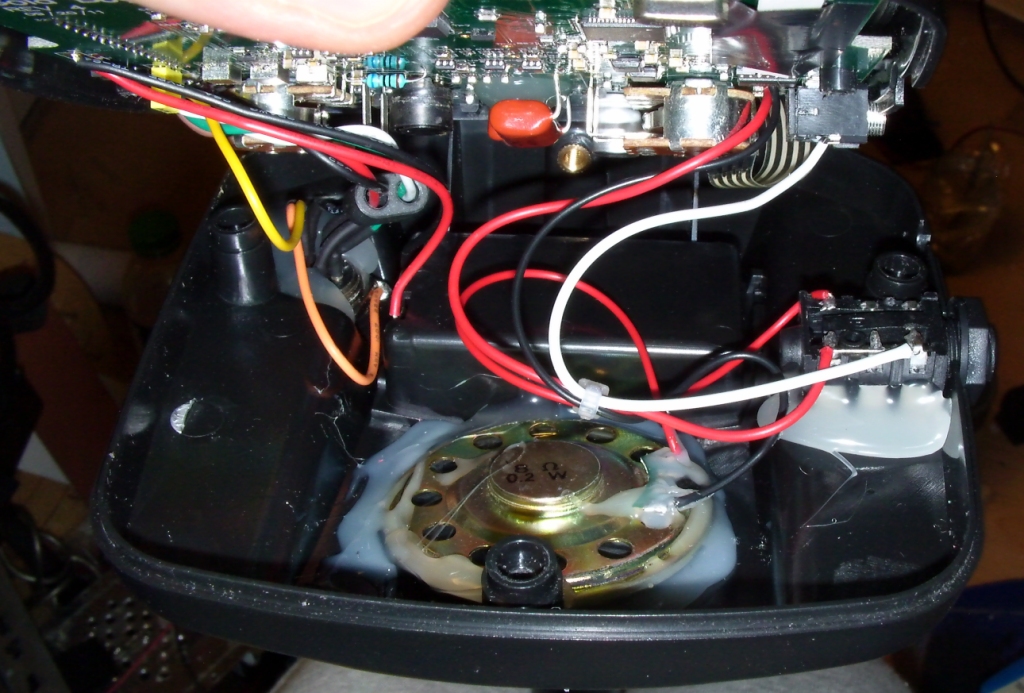

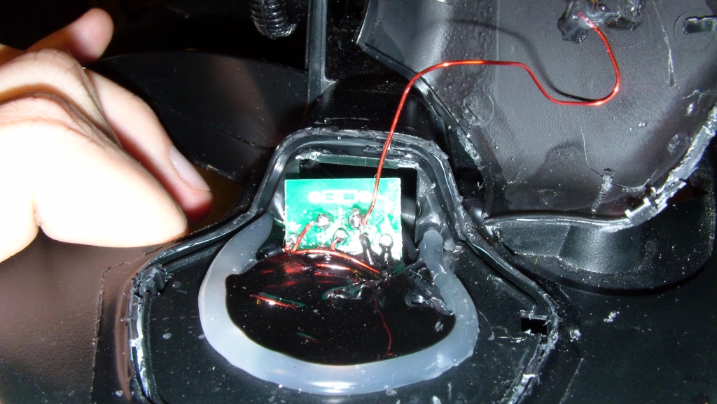

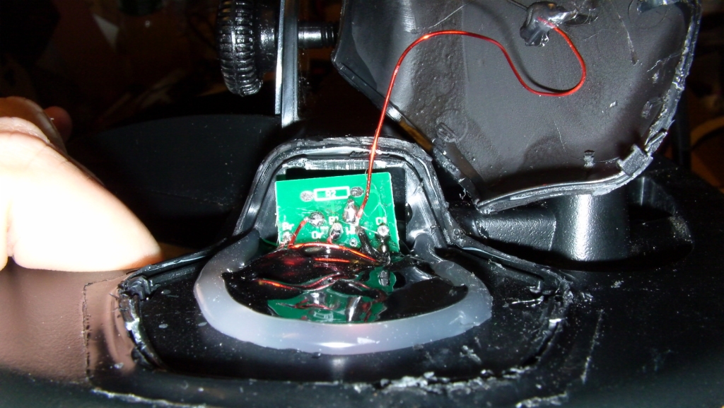

                      Attention the following pictures may be stop your heart beat
                      made them some minutes ago

                      thanks for your measurements
                        and here the rest

                            I have a cheapo that I'm trying to open the coil. For the last month
                            I've been running an Xacto around it to separate the half's. Maybe
                            I'll be in by New Years!
                            I'd love to see the schematic to that Goldbug above. It looks like
                            and updated one using a PIC. I've just started experimenting with
                            those, it's a blast writing code to make it do what you want!
