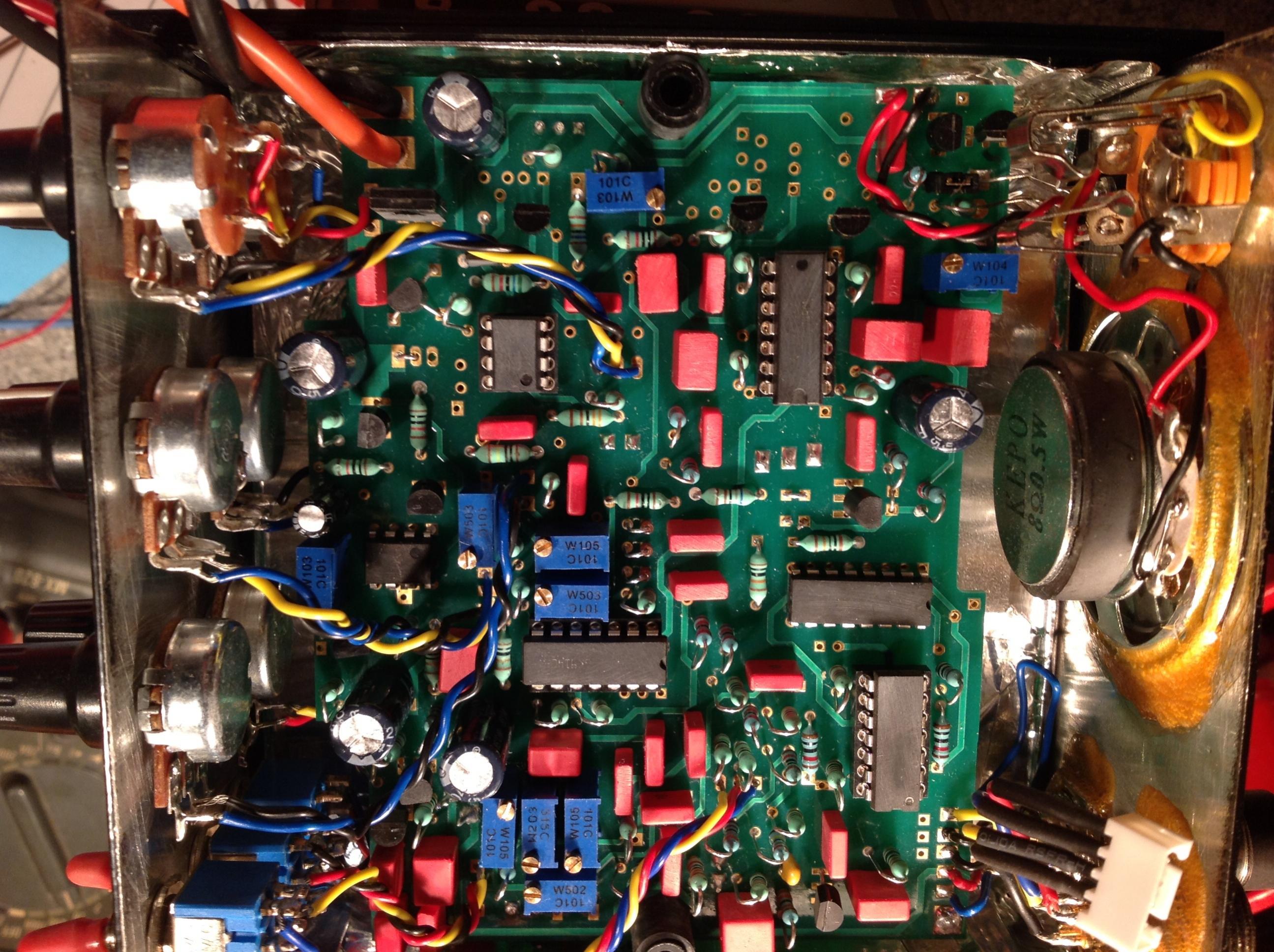

                    I always wondered what the insides of the Blisstool control box looks like, mind posting some pictures?
                    I thought to myself if I could find a Bliss cheap, missed out on a couple, might take a stab at making a 7" coil.

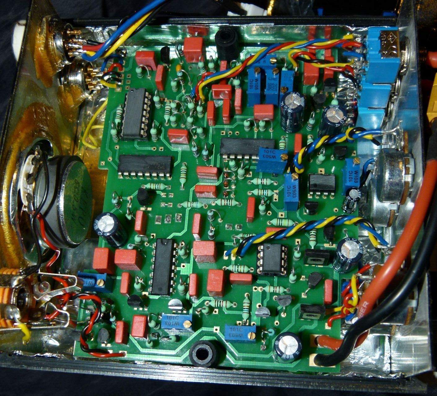

                      To you Sven... Some Pictures. VTC 48 and VTC 64.
                      Ps. I know a guy with VTC 64 v3 - still warranty - prize 420-450 £ - both coils. PM If you want a contact to him.
                      Henrik.
                        I was just browsing and saw the pcb pic. Come on! All those pots ? Something that needs that kind of set-up is bad news. I have worked with lots of proto-type stuff made that way. What a nightmare it must be. How do you set it up, and I bet it drifts a bit. It looks 'orrible (IMO)
                        BUT I have nothing against analogue with lots of set-up automated by a decent CPU.
                          I couldn't believe there's so many trimpots inside to go along with the ones outside. Yikes!
                          Just a thought, if the detectors more or less perform the same , couldn't the resistance value of what the trimpots were set up at be switched out for a fixed value resistor?
                          After seeing all those trimpots, and claims of some Blisstools working incredible and others so-so (complaints) be related to mis-calibration of the trimpots? I'm sure there's more than one person calibrating
                          the Bliss at the factory...................

                            I dont set them up... Only buy them, use them.. And improve something. If I can find something there could Be done better.
                            I learned how the power supply, the preamp and the GAIN system is working, only because my first buy had some errors and I open it up... Tryed a lot and found the problem.
                            Later in the process I found out where the tone is Breaking up and made a two tone model.. But is wasn't perfect. It Helped a little.
                            honestly I do not know why I continue to believe in this beast of a Detector.. Maybee that I Once or twice had dig up a coin from very deep down with this Blistool ! I got Hooked..
                            Is a learning fase I'm through. Properly in one or two years I would look back and ask why ! and maybee think it was waist of time.
                            Henrik.
                              Sven you right... I can tell where the voltage can Be adjusted.. All the rest I got no clue.
                              Some pot. must Be the disc. settings.. And that is a Big problem with this Detector.. DT, DL and DD... And I can tell you a secret.. Psss...dont tell Anybody . The disc system is NOT Linearly... If you change the DT it got influence to the DL, and If I adjust the DL it allso change to DD... Nightmare to find the best setting... Just think about coke. !! If the coke is at surface you change the DT, but next coke is Maybee 2" down, then you must adjust the DL.. But third target is a deep small hammered and now the the DD is to high. !!
                              The tone is Breaking up.. But the breaking tone depent how deep your target is. NOT GOOD Sven.
