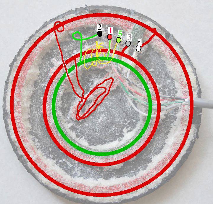

            In this picture you see a BH plug.
            How do you know what the TX + and - is ; and the RX + and - ??.
Name:	BH Pin Layout.jpg

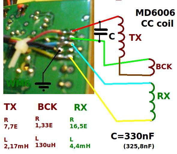

                  hope you get it working, i have an md6006Click image for larger version
                  the coil wiring is very similar on the chinese machines Click image for larger version
ID:	339472, the 8" bounty hunter coil i put on this machine,is an old one and the 5th wire is not connected, the capacitor can be adjusted to better match the detector(but i did not need to do this it worked fine), and was much improoved with the bh coil.

                    Dear Silver Dollar ,
                    I found out that the 5th cabel on the BH is not connected to enything.
                    The Yellow cabel 5 is not connected .
                      Sorry ,
                      So just like a MD5008 , the BH uses just 4 cabels , only has the 5th as a sort of shield.
                      Can this be correct ??.
                        how old is that coil in the xray?, the red loop on the tx is probably used to null the coil, my guess is that the yellow wire is conneted to the shield, the way it coils round the buck coil and receive coil may mean its connected to the shield its hard to make out.
                        the photo i posted of the md6006 coil is a bit deceiving as the black earth wire connects to rx-(on the traces on the board).
                        if the yellow wire is shield, and your chinese coil has the same 5 wires as mine it should work, but you need to still check rx,tx etc on that chinese coil as they dont allways use the same cables.
                        as i said before the easiest way to do this is to open both coils and check them manually, but you have to be sure you can seal them up again.
                        if your 5008md only has 4 wires its shield(it will have one even if its only on rx) maybe connected to rx- wire.
                          The picture of the open coil is from a BH nugget 4" coil.
                          It,s about 5 years old and has a 5pin Din plug. ( so not a srew plug. )
                          The picture of the coil is from a website with all the info.
                          The yellow wire is not connected.
                          http://www.whiteriverprep.com/vintag...ch/bhtech.html
                            then simply ignore it and match the tx and rx wires,
                            it was not used on the coil i used, my md6006 had it but as the rx- is connected to shield(by a trace on the board) i ignored it.
                            it works fine better than before with the chinese coil.
