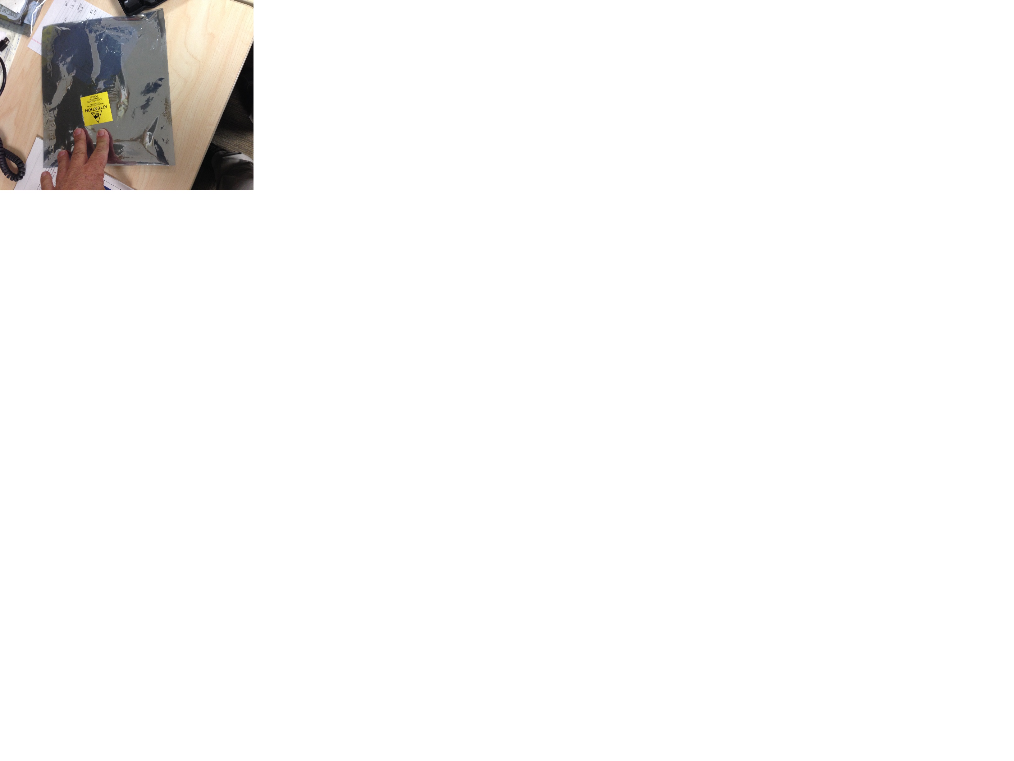

                        ESD bag as shield?
                        Before I go and spend time experimenting with it... has anyone tried using an ESD bag for shielding. They can come in large sizes - see photo.
                        They can be heat-sealed. Any advice? - should I shrink to the coil then cut a clearance ring? Attaching to cable ground may be challenging.
                          I think you'll find they are static dissipative and not conductive...
                            As I commented recently on Henrik's Deus coil thread, I measured a black conductive anti-static bag as having a surface resistivity of 300 K Ohms per square. About 30+ times too high to be useful. Unfortunately.
