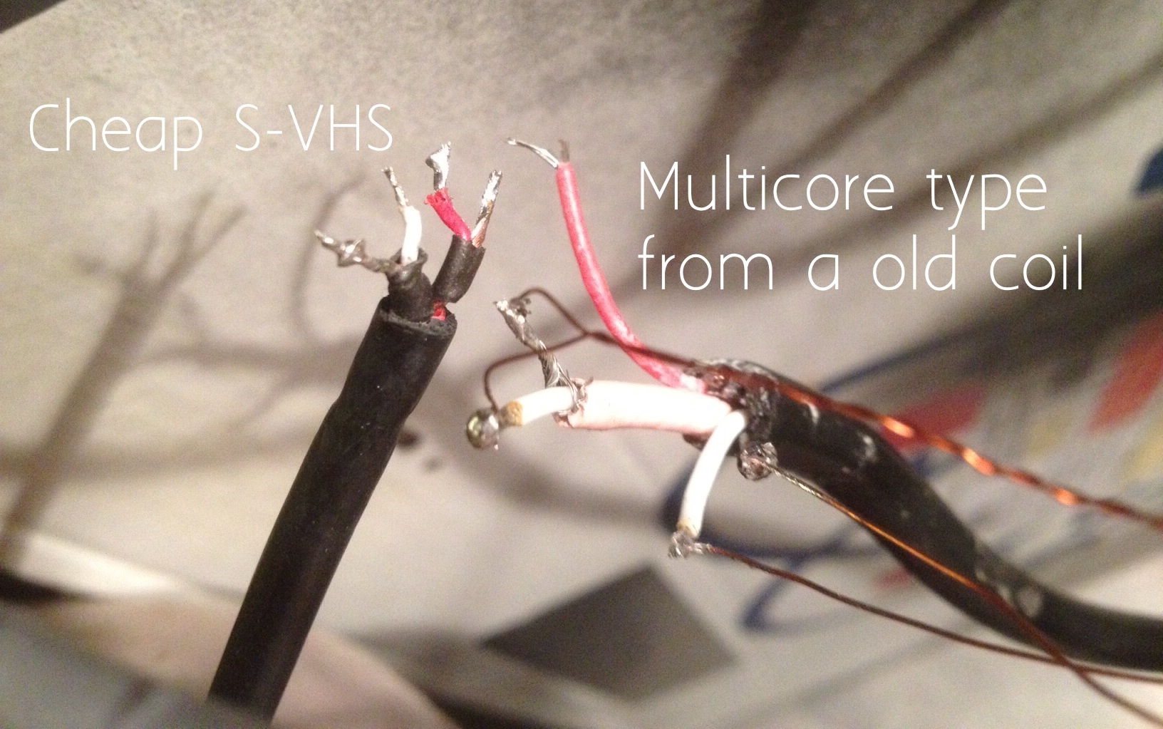

    I tested 3 different cable types at the 15" Deus coil I'm working at the moment, at my conclusion is that Microfone cables are working best !
    The company "Prefer in Holland" are making cables in good quality, like this type; Original PREFER MK 200+
    link; http://www.prefer.de/downloads/kabel..._multicore.pdf
    This cables is allso used by Deeptech at some Vista coils.
    NEL coil are using similar type and that was the third cable in my test.
    Picture is showing a cheap S-VHS cable and a multicore cable I've got from and old coil... Out of those two models the multi cable did work perfect, the S-VHS not, the Multicore even using the cores without shield to the TX coil.
    Ive got the same good results with a NEL coil cable. (microfone 2 pair type)

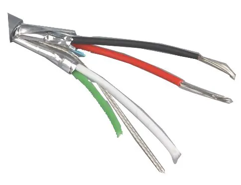

        I need a Cable for my TGSL EDU.
          must shielded in couple - cold end and hot end tx in one shield, cold one and hot one rx in another shield.
          both shields may touching. ie AS it done in firm cable. eah?
          so throw out cat5 and cat6.

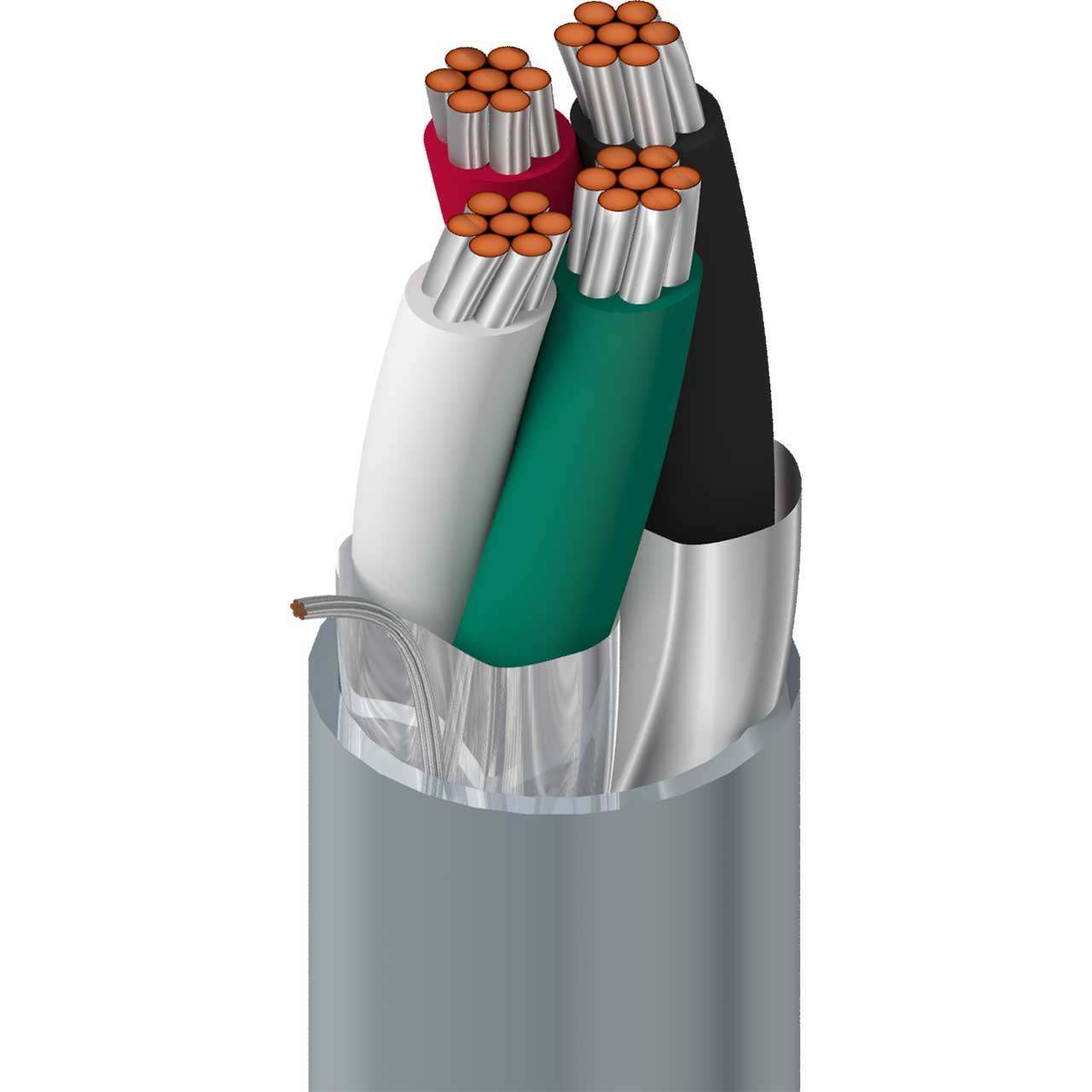

                          Your first picture is the same as Cat6 Network cable .
                          Can i use this?
                          I live in Germany and i dont want to buy a new one because i have thousands of wires at home.
                          I just need to figure out which one is the best.
                            ok. delete isolation from a wire and give me a pic in macro. i would like to make sure that is multistrand.
                              https://gt-netstore.de/kupfer-netzwe...A7AhoCMjPw_wcB
                              It's not multistrand inside of one from the 8 Wires. Its just one wire inside.
