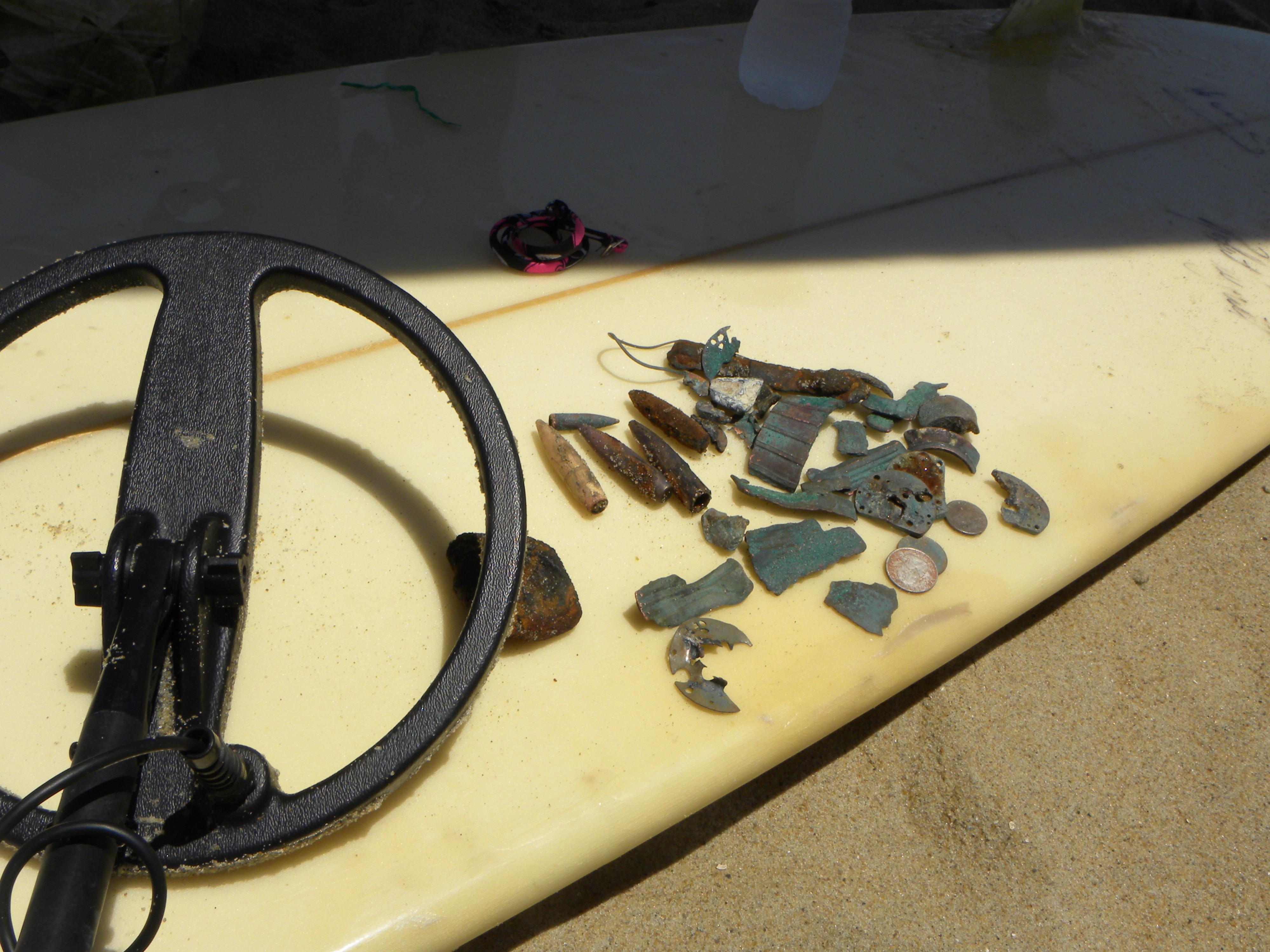

          I was hunting Virgina beach last week. It must have been an artillery range at one time.
