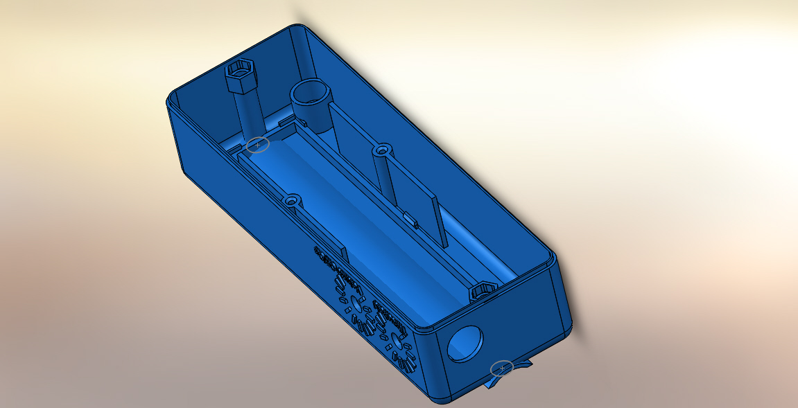

Name:	Surf PI Board Housing 01.JPG

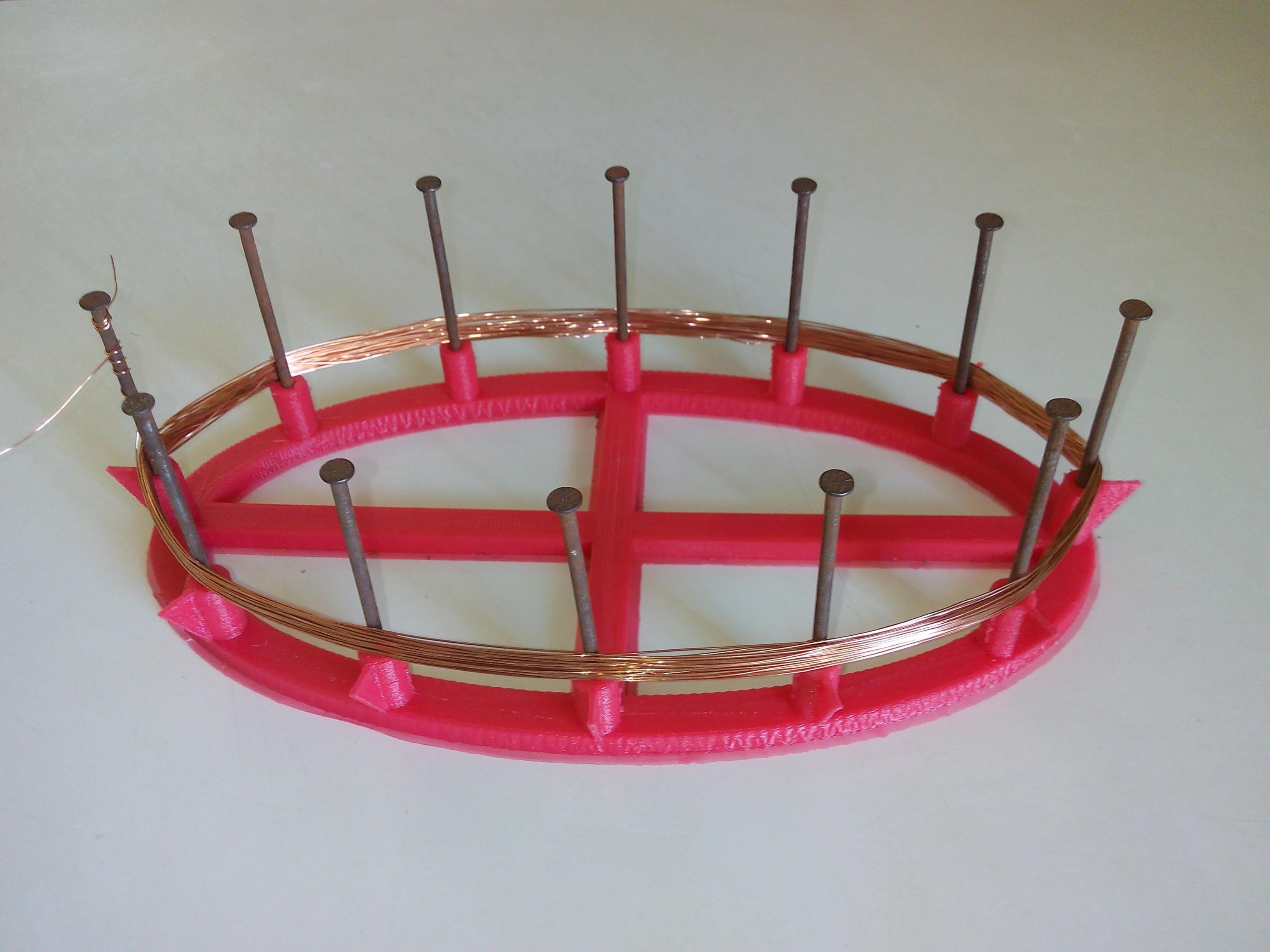

                            Here is a pic of something else I printed which worked really well, a coil winding jig.

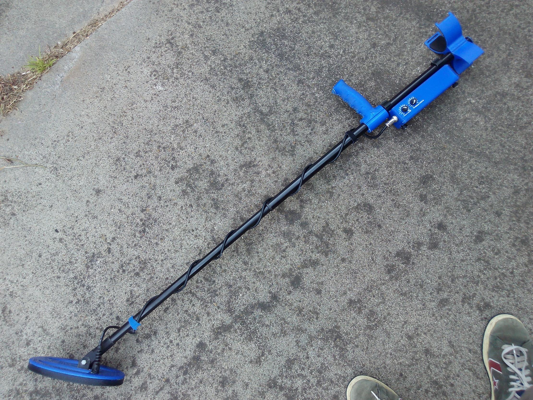

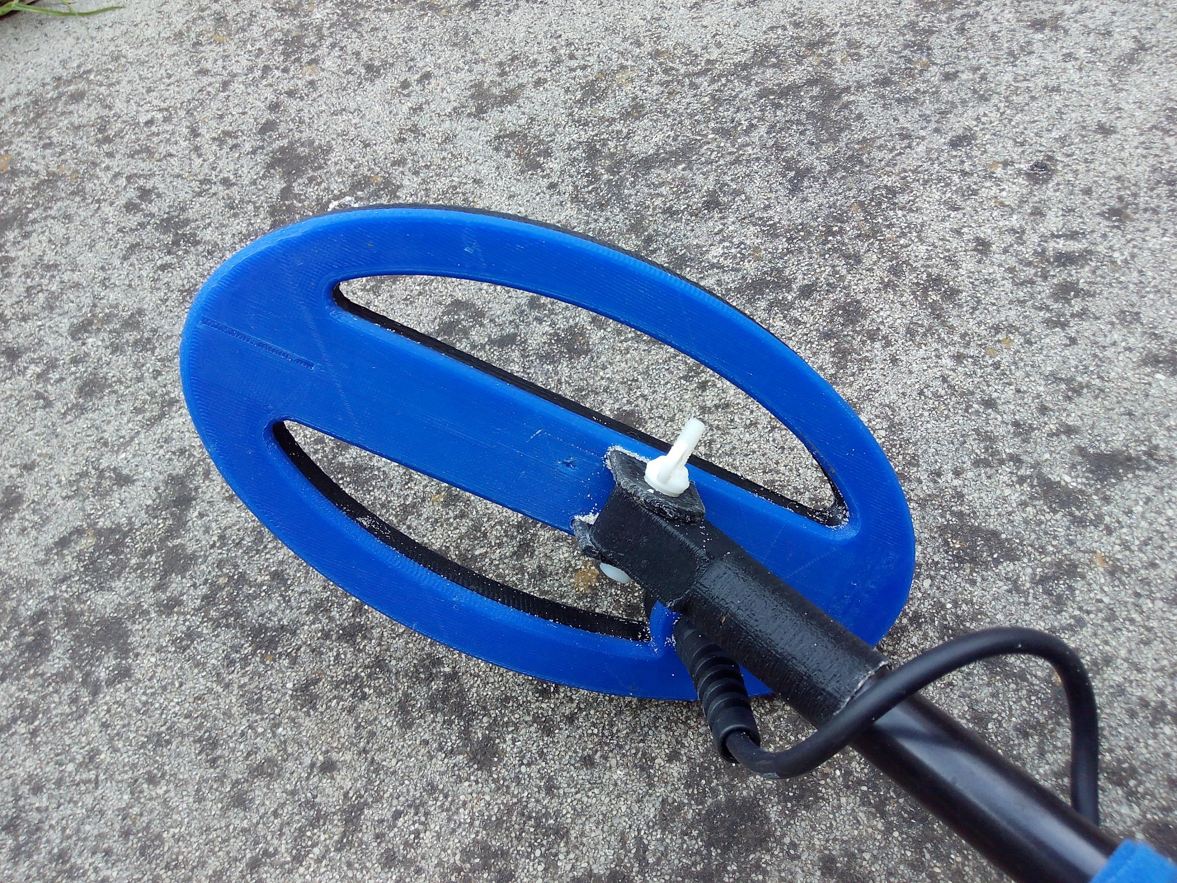

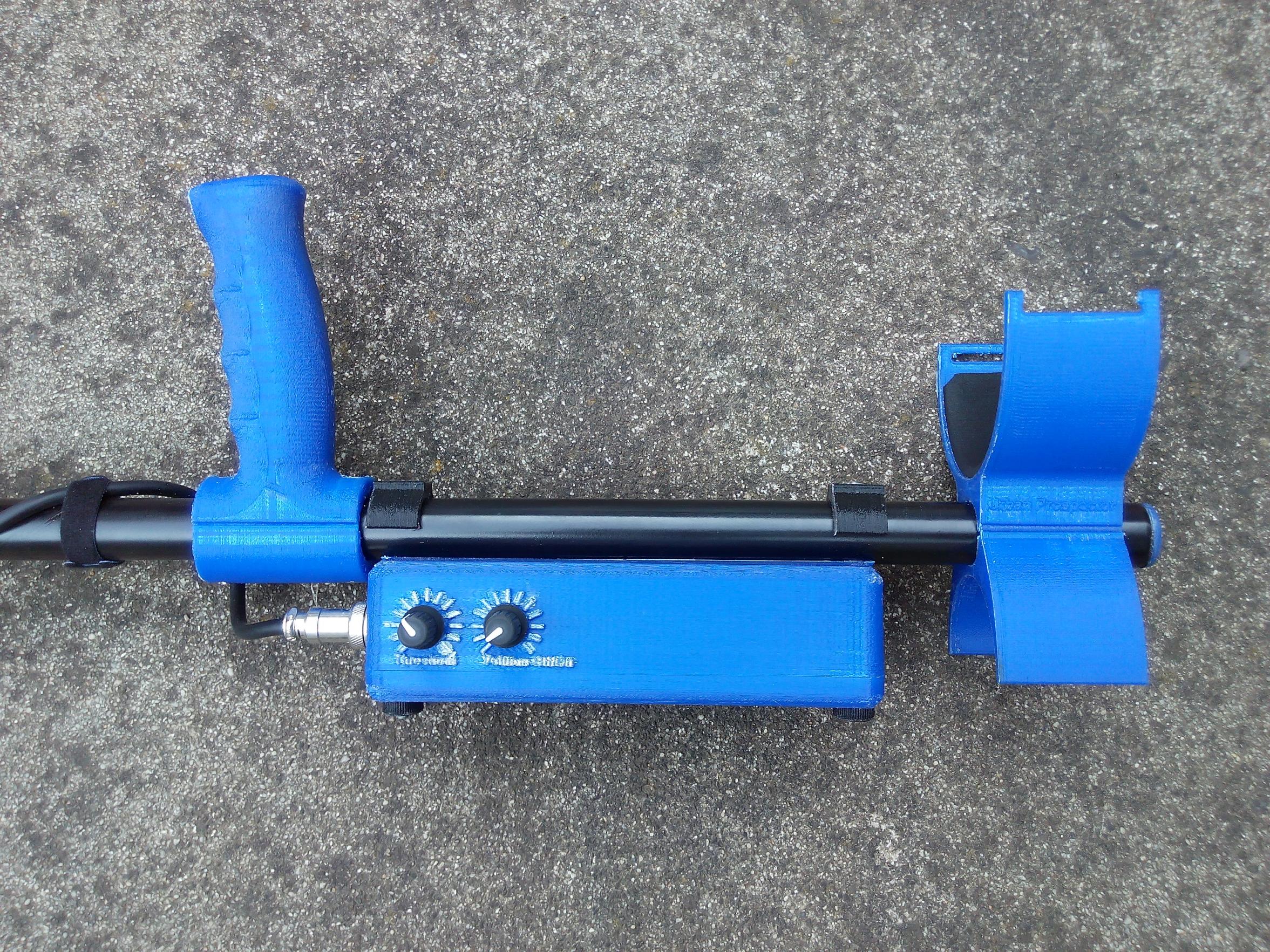

                              Just posting the finished pics of my fully 3D printed Surf PI 1.2, it came out really good and functions as intended.
                              After testing I think I will do a bit of tweaking to most of the parts, coil housing I want to completely re-design more like conventional coil building methods, I want to make the next coil fully water proof, and epoxy filled or something with less plastic used for the print, the current housing was mainly a test model, handle could be angled further forward maybe another 10 degrees, Surf PI 1.2 board housing needs some slight tweaks, board didn't quit clip in properly and I accidentally made it left handed so the knobs keep hitting my body and adjusting themselves, I might mirror image the current case or relocate the knobs, and the elbow support needs thickening around the strap slots or deleting the strap slots altogether because they may never be strong enough printed in that direction, screw on slots printed in a direction that makes them stronger might work. I even printed out the little plastic thumb nuts for the case, tube plug, shaft adjustment and locking screw, everything accept the actual shafts which was taken from an old adjustable mop I found in my garage and a piece of PVC tube for the lower shaft. Overall I am very happy with how it came out and I couldn't imagine a better way to build home made detectors, the best thing about the detector is its well balanced and light as a feather, My Minelab 705 feels like a brick in comparison. Something strange I noticed is that when I snapped the 2 housings shut around the coil I lost 2" -3" inches in detection depth, attempts at re-tuning failed to recover any lost depth, I am wondering could the 3d printed housing be slightly conductive and working like a shield? I had no success with ally foil shield so I removed it as that also took 3" inches off the depth.
