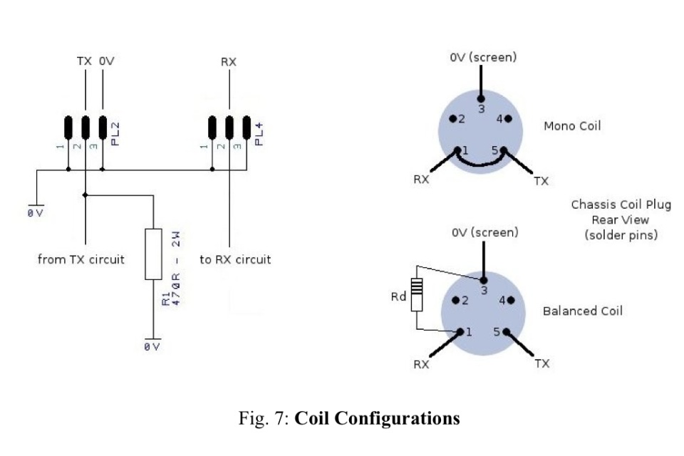

                          I don't understand where the tx and rx ends go, do they connect to the unused pins on the plug and the tx 1 and rx 1 solder points on the pcb? A picture of "fig. 7" is below.
                            [ATTACH]31343[/ATTACH]
                            The TX wires connect to PL2 pin 2 & PL2 pins 1/3.
                            The RX wires connect to PL4 pin 2 & PL4 pins 1/3.
                            This is shown on the left-hand side of Fig. 7.
