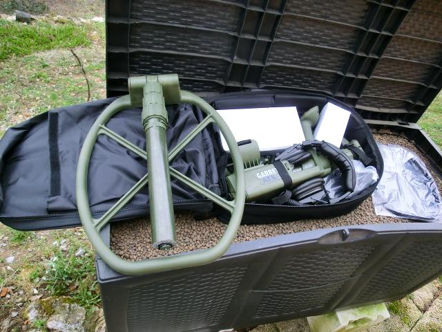

        Yes optimal. It is hard to understand to me what other coil you need apart from this stock coils? You say 20" coil to build, but such coil already exist as stock coil (I tested it, in short: to heavy for everyday search):
          I would love the have the 20" deepseeker. The problem is that it cost over $500 and comes attached to the heavy shaft. I would have to cut the shaft off and build a mount for a standard rod. If I have to do all of that work, I might as will make the whole thing for much less cost if possible. My goal is to make either a light weight mono or dd 20" Since I have no mono to test, but do have a dd, my focus is on the dd. Since it is not a commercial coil, I can make it a little more delicate in order to save some weight.

            I even didn't test it for detection depth, cause it is so big to nut suit in my testing plant:
            Otherwise, so called "mono" coil for Infinium and ATX are not mono (single loop inside) in fact. Such mono (from outside) coil are in fact some sort of concentric coils:
            So you can follow schematic for Infinium "mono" coil to build bigger ATX coil.
