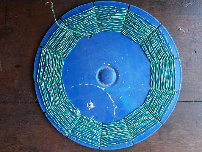

                Hello Monandes
                Perform this flat coil to experiment.
                air tests had good sensitivity, but not finished, should the shield.
                If you want to experience, these are the data.
                Cat 5 cable, two conductors twisted diameters of 0.5 mm.
                Outer diameter: 25 cm.
                Inner diameter : 16 cm
                Number of Turns: 32.
                Inductance :. 298 uH
                Coil resistance :. 1 ohm
                The slots must be odd. In my coil is 13.
                José [ATTACH] 32314 [/ ATTACH]

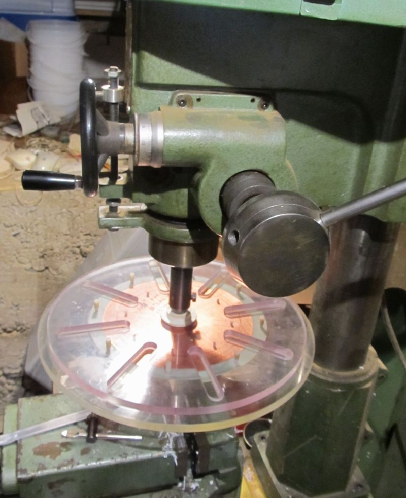

                    hi can you give use inductance and res of your coil?/
                      The Inductance and Resistance using a 22 AWG wire is Determined by the Number of Turns.
                      Not just the Outside Diameter.
                      So what is Most Important?
                      Inductance or Resistance?
                      And What Value?
                      Also, If I were to make you a Coil, What COUNTRY are you in?
                      Take care...Gary
                        he is Iran. Garry, can you give pics of your winding device for flat coils? I hope this ll give a blast for Mohandes. tia
                          My winding Jig on my Mill Machine.
