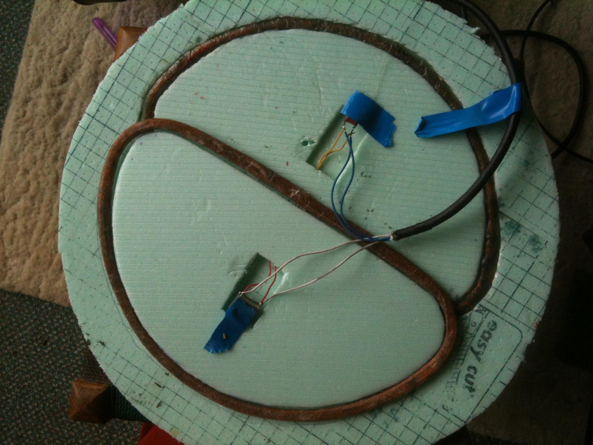

        not much to show with a photo as the shield is now covered in two mm Click image for larger version

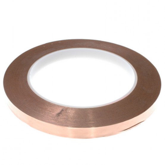

          oops have some copper slug tape but the RX coil is glues to the base.
            thought i would do I quick and dirty test with a sheet of aluminum kitchen foil. At first I thought everything was okay but then realiszed that when the foil is near the coil the null alters. After readjusting is just constantly chirps away.
            With the foil shield or original graphite shield or both the coil is unstable even blowing the air above the coil is enough to make it sound.
