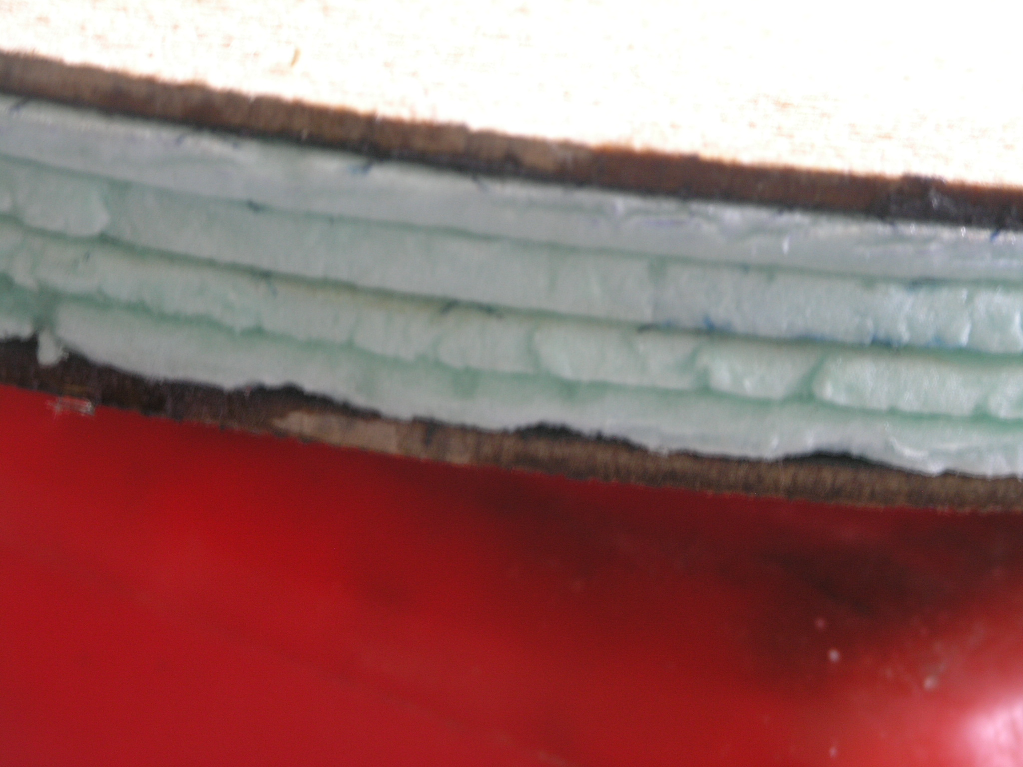

            Thanks I have taken a chance and epoxyed the TX in. Unfortunately its only 16C in the house and the epoxy needs 20 to set properly. Think it might be time for the hair dryer
              Hope so taken a chance and epoxyed the TX in. To cold in the house for it to set properly. Might try a hair dryer
                Still gluing it all together gave up with the hair dryer ended up with buckets of hot water on the top. No way I can get it ready for Sunday.

                        Made a bit more progress but it slow going as the epoxy is slow curing as its still only 16C in the house. Takes a day to go tacky and another day before its like a stiff plastic.
                        once the air gaps are fill with epoxy it became so much more stable compared to when it was tapped together

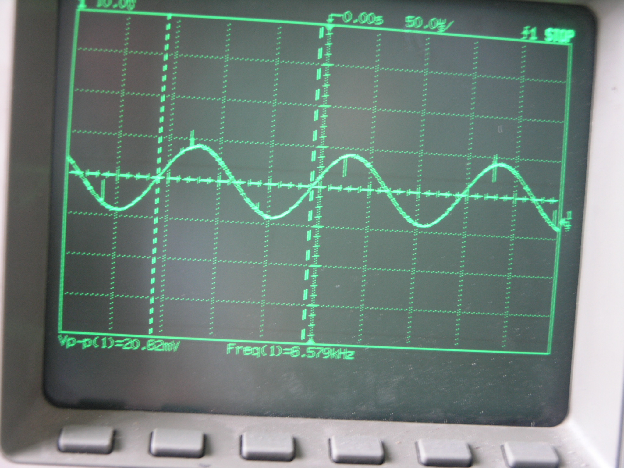

                        Got a spike just before each peak and trough on the RX pin 6 of U1 (pre amp output) Not sure if its just picking up the CRT oscilloscope but seems to be too regular?????
                        Does not seem to affect performance. Ground balance and discrimination is spot on.
