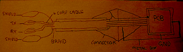

        Finally new problem. With both homemade or factory coil installed if I touch the metal box of the detector it sounds. At the moment I have the boards outer edge to the box connected and the metal case of the POTs connected

                  Looks like a GND loop type problem and not a shield problem
                  If I disconnect the coil connector locking ring it's fine connect it back up and it fails again very consistent at the moment. Time for some more test. At least if it remains consistent it should be easy to beat
                    Ahh its back.
                    If the coil connector has a metal body, then you need to make sure it's connected to the shield ground.
                      Cheers
                      using 4 core cable
                      The shield is connected to the outer shield of the cable at the coil end
                      At the connector end it is connected to both the connector and the GND pin which as far as I can tell is the same an an original coil.
                      Have check something is not amiss in the connector as if I unbolt the connector from detector and have it floating in the air its also fine
                      Looks like this one sorted and just need a bit of fine tuning.
                      Thanks everyone.

                        For the life of me I can't see what I have done wrong. No big deal as if I isolate the metal detectors connector from the metal box it works fine if I pull the metal locking ring back it works fine.
                        Factory coil works fine as it is though. Opened the factory coil connector shield is only connected to one pin and to the connector shell. Same as mine. Can't tell if 5 core has been used as its covered in hot glue
                        • #42
                          It may be a ground loop?
                          Good practise is to pick a single common ground spot and bond all relvant grounds to that chosen point.
