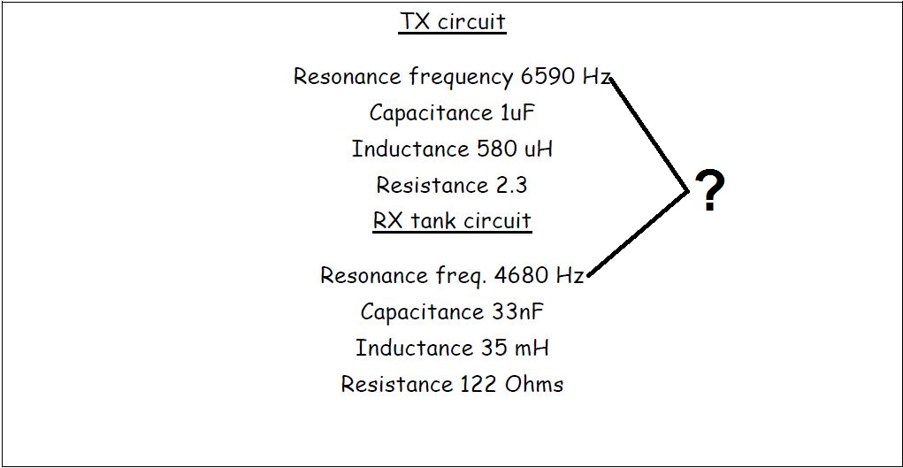

              Why in VLF metal detector , the transmitter frequency is 1 to 2.5 kHz higher than receivers frequency ?
              While the frequency of both should be the same.
              Thank you

                Theoretically it would appear that tuning the TX and RX coils to the same frequency (resonance) would be the obvious solution. But in the real world it's not so simple. Due to manufacturing difficulties, component value drift with time, cost, etc., the coil tuning is always offset to improve stability and maintain consistency of performance between detectors. When tuned off-resonance, any variation in component values, due either to time or temperature will have much less effect on the detector's operation. Only Nexus Detectors make resonant coils for their machines, and each coil can take up to a week to produce. The coil manufacturing process is complex and time consuming, and only suited to low volume production.
                Sometimes people get confused when thinking about the RX coil being tuned to a different frequency than the TX. For example, if the detector is transmitting at 10kHz, and the receiver is tuned at 9kHz, it doesn't mean that the RX signal is 9kHz. If you examine the output of the preamp on an oscilloscope, you will see that the received frequency is actually 10kHz. It's just at a lower amplitude than it would be if the coils were tuned to resonance. Maybe that's what you're referring to?

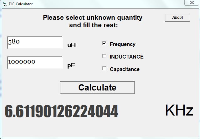

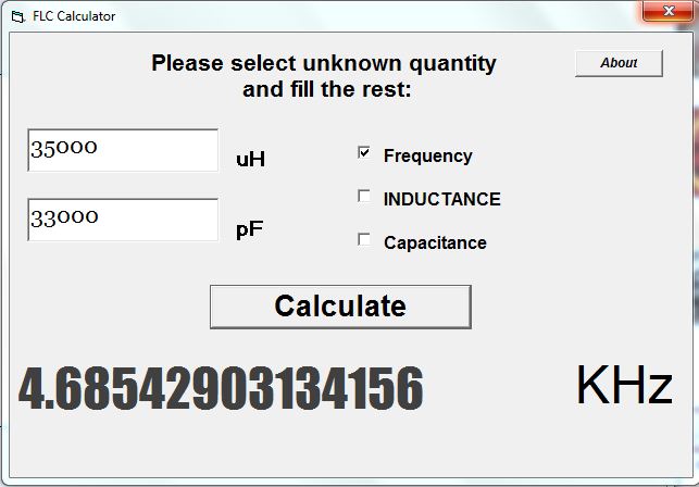

                            Thanks for the answer
                            Yes, that was the orderClick image for larger version
