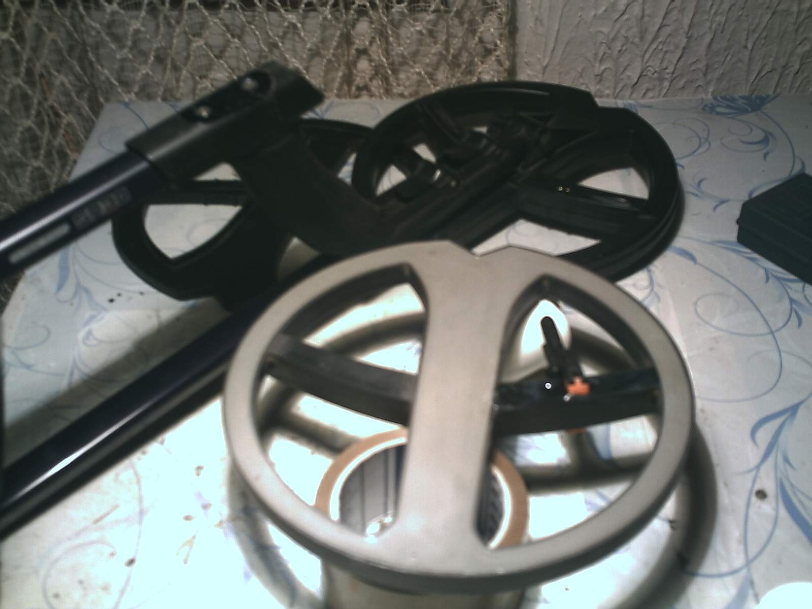

                              Ok, i have Deus now for 3 maybe 4 years. Frequent use, 3-4 days per week.
                              Both batteries are still in good shape. No need to replace them yet.

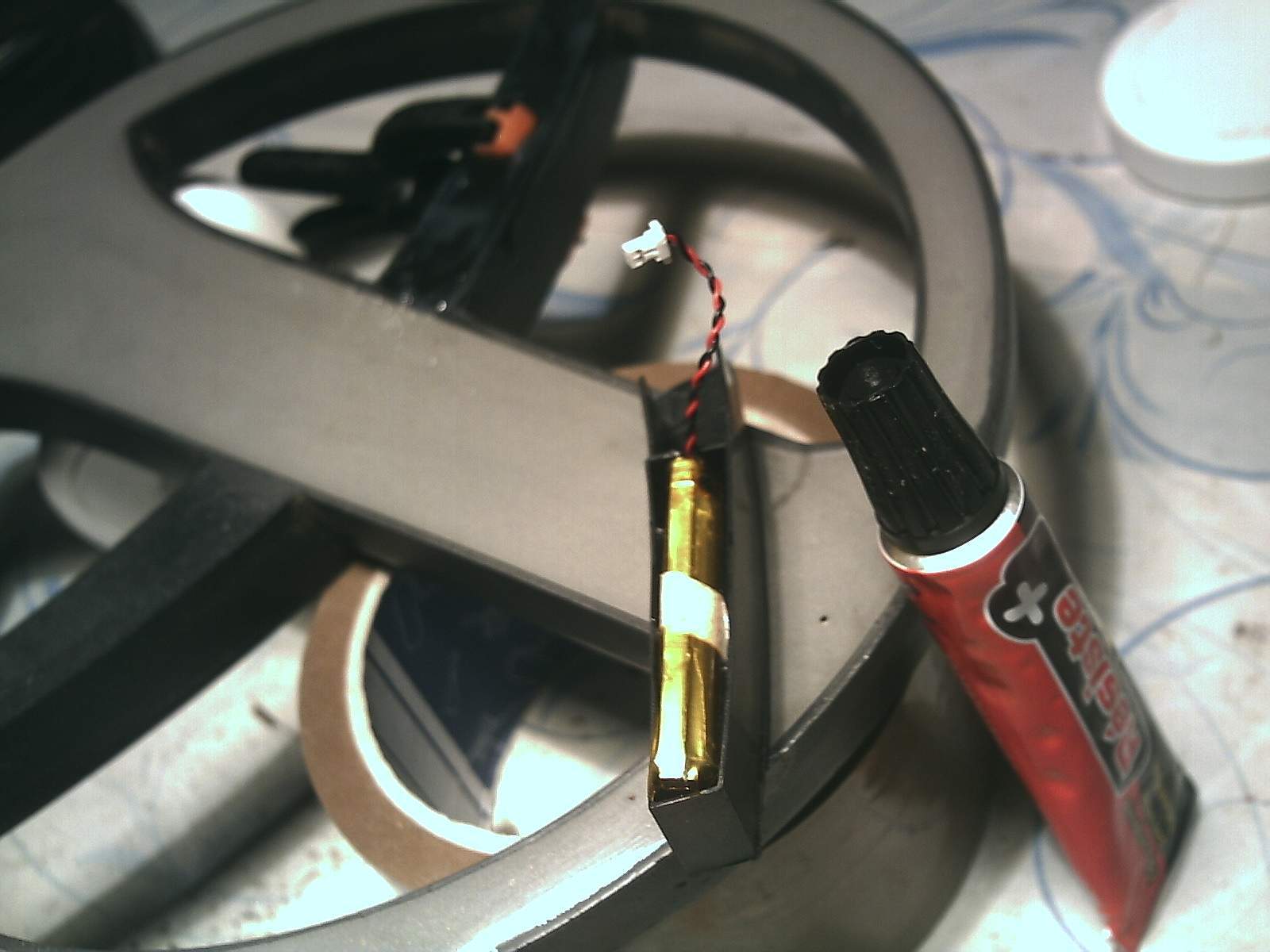

                              And coil battery replacement; 10-15 minutes! You don't even need to be experienced diy'er to do that.
                              Original XP battery replacement kit is expensive? Ok, nobody is pushing you to buy exactly that one; any other 3.7v battery will do just fine. Plenty room inside even for a bit larger ones.
                              As i stated; my own batteries are fine by now, but i already replaced not less than 10 batteries on others people coils so far. Piece of cake. 10-15 minutes in worst case.
                              Next 4 - 5 years they don't need to worry and after that batteries will be replaced again... and again... and again... 1000 times if you like. Again each time; piece of cake.
                              Fully submersible and waterproof ; yes! After 100-th battery replacement still are? Yes!

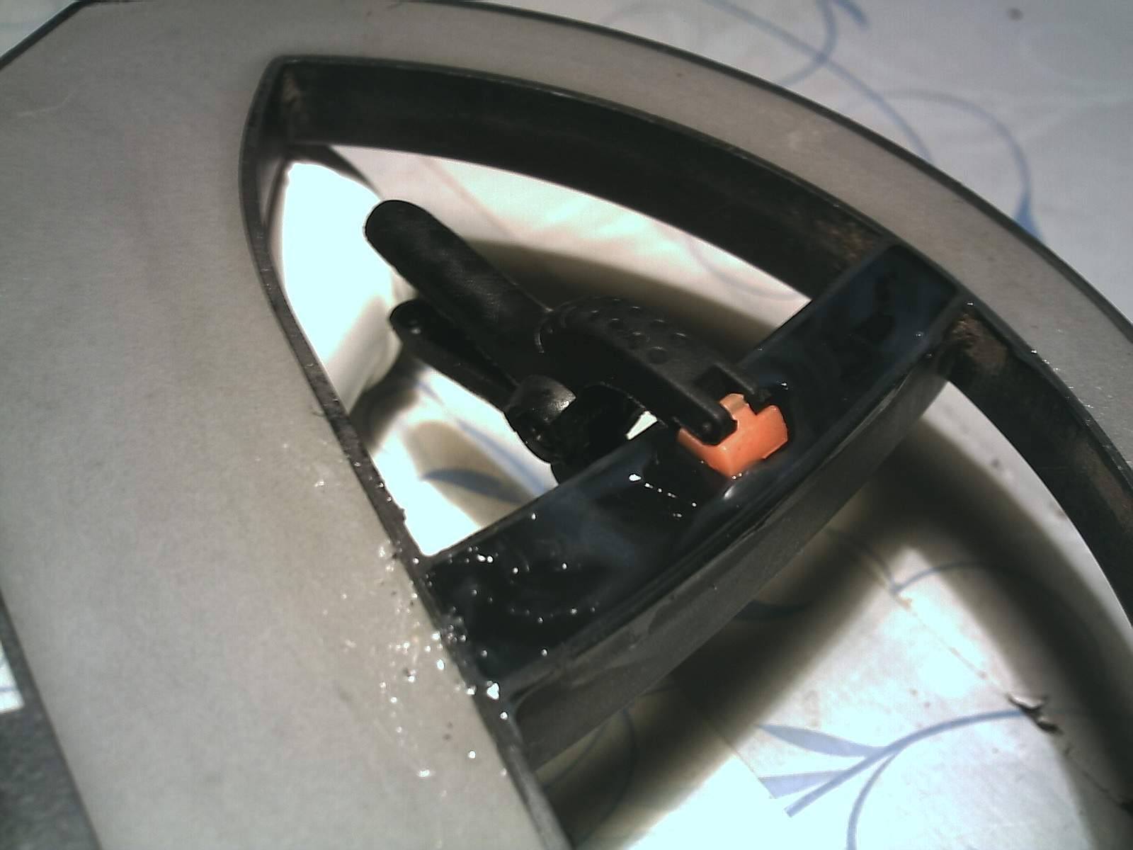

                                I did this probably more than 10 times so far.
                                Easy and sweet.
                                Easier than to replace any conventional and "modern" coil connector.
                                You need sharp blade and silicone. Of course new battery too.
                                10-15 minutes in 4 to 5 years, that's what it takes from you.
