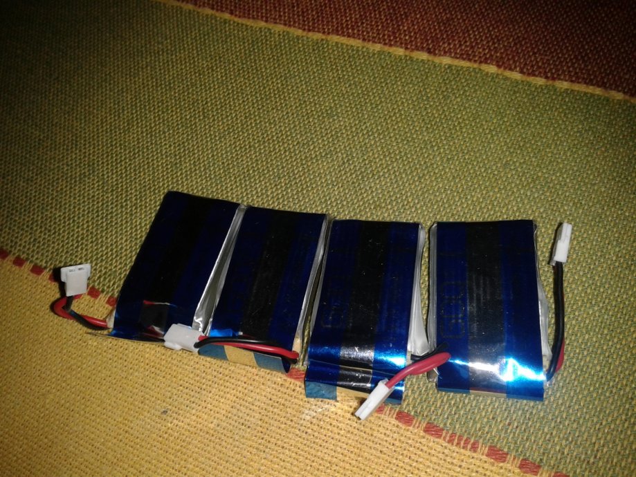

    XP Deus coil battery replacement kit is expensive to you??
    Ok, no sweat!
    You may use any similar with nominal 3.7v voltage.
    Any current. Of course; more current - the better.
    No sweat.
    Now on market there are plenty of those batteries, varying in current from 400mAh to 3200mAh.
    Let us be reminded on fact that original Deus batt is just 600mAh. Lasting up to 19 hours on the field, ha!
    Where to find such shaped batteries, to fit into Deus coil?
    Everywhere! Most of the modern drone toys, helicopter toys also, small battery operated navigation systems too, small cameras... what else?
    Most of those mentioned usually DO HAVE similar or almost the SAME battery! Most often even with larger nominal current, which is SUPERB!
    Prices? FUNNY!
    So?
    Still ready to complain?
    Or grapes is getting sweeter now?

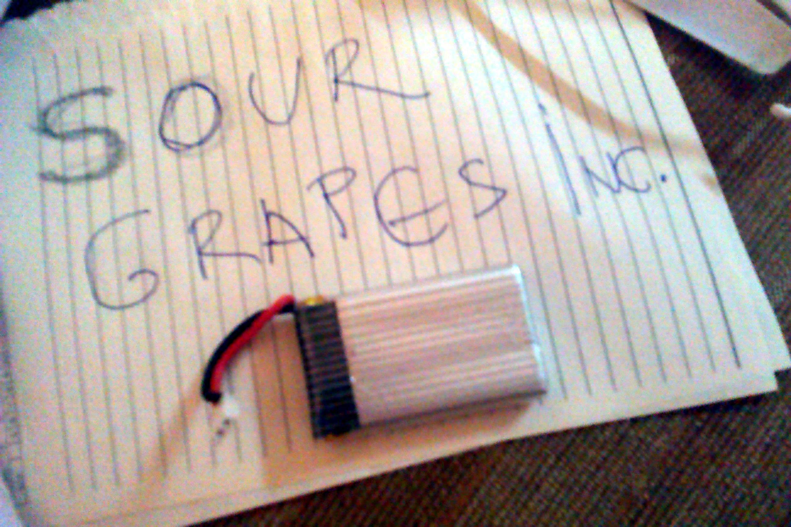

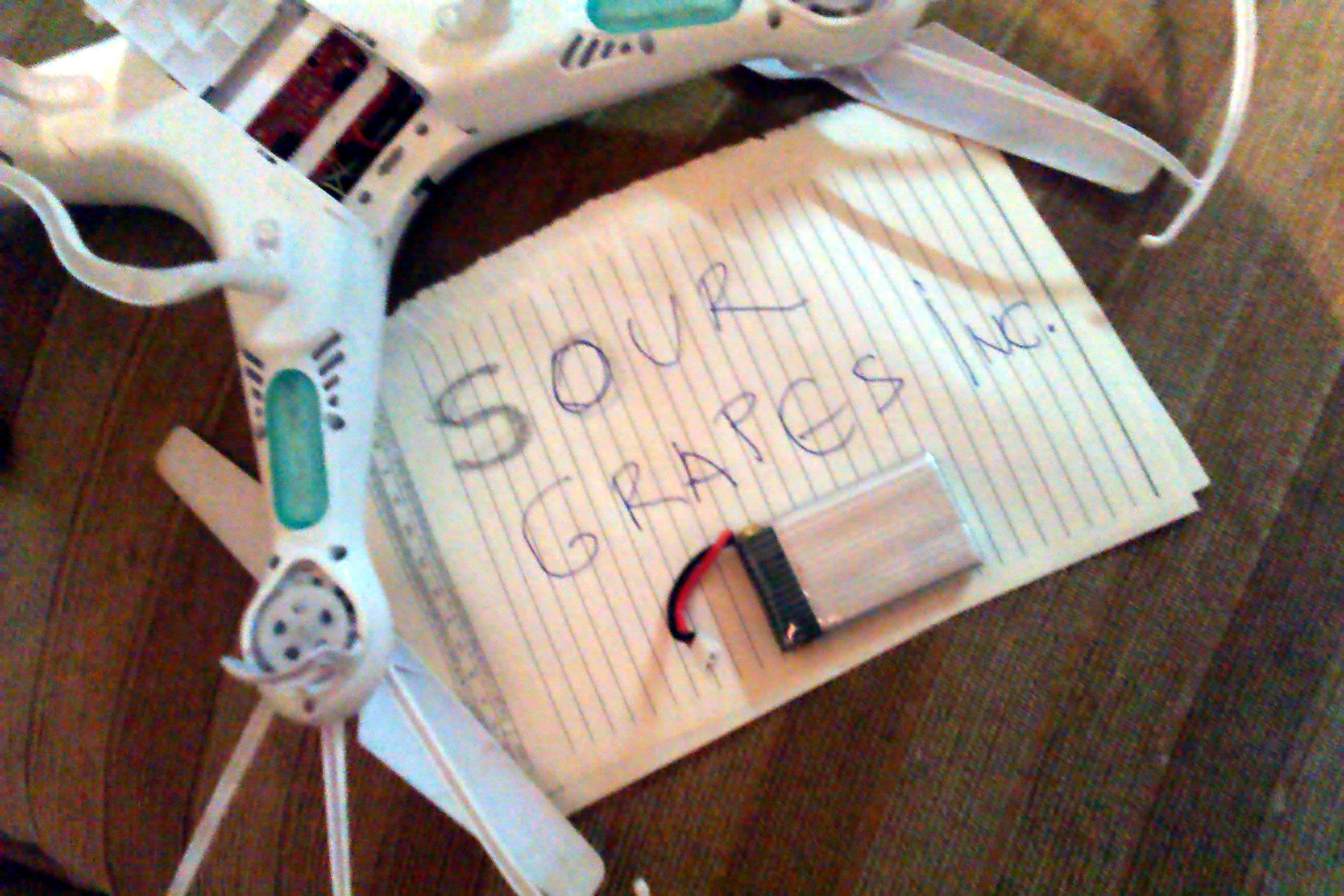

      Hey look!
      My cheap drone is using almost identical battery!!!
      Wow!
