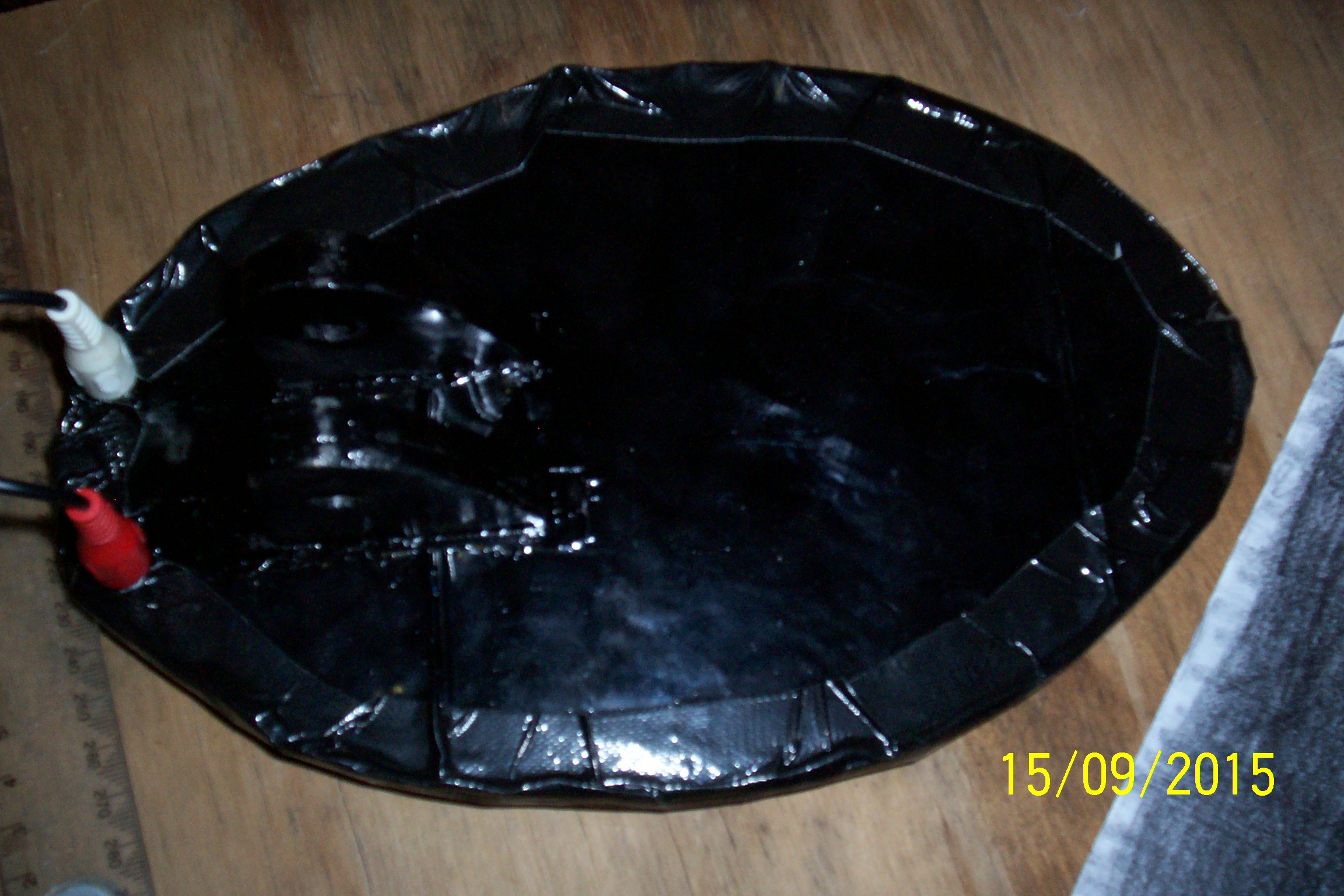

Thank you all in advance for your positive input. I will buy the book. I fixed the rough edges and painted and cloth taped the cover on. Aesthetics aside, on my IB setup, I can get 8 inches on an air test on an Aussie 5c piece, and 12 on a 50c. That's upside-down(air-test), under a fluoro light, with the fridge going. And no it wasn't the cable signal or my hand/arm. That was the reason for the shield, and my extensive research and testing.About 3 inches on 2.4 grams of gold dust/clumps.
That is only a sub-carrier (?) signal, but the human ear can easily discern it. About the same signal as the Goldmaster on .2g of gold inside a 4" conglomerate I picked up near Wedderburn.

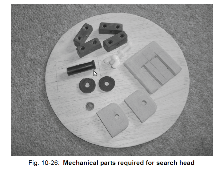

I won't publish the complete section on making a homemade coil, but here's a image that basically shows what's needed.
Parts Required:
1x coil cover (available cheaply on eBay)
1x plastic bolt, washer and nut
1x cable entry sleeve
2x rubber washers
4x coil cover spacers (plastic shelf supports or similar)
2x coil loops (cut from MDF)
1x mounting plate (cut from MDF)
1x base plate (cut from plywood)
... and lots of glue.Attached Files

Thanks Q. Here's my ugly but sensitive coil. I'll strive for neatness next time. But this thing hammers on an air test.Attached Files
