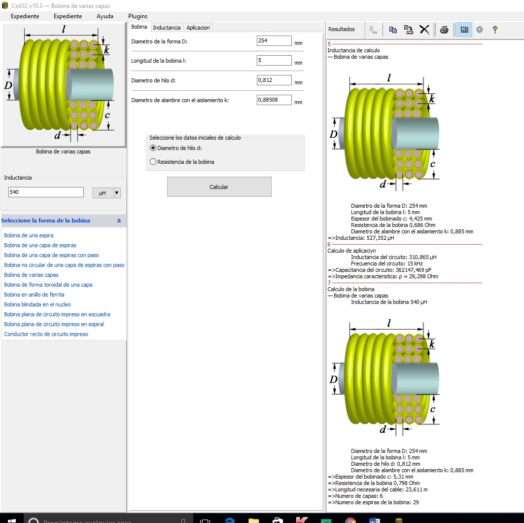

          Firstly I ran our Coil Calculator using a coil radius of 127mm, wire thickness of 0.65mm, and 20 turns of wire. The result was a mean radius of 128.45mm, a coil thickness of 2.91mm, and an inductance of 302uH. From experience I know that this result is very close to reality.
          Using the Coil32 program, I entered the diameter of the former as 254mm, a winding length of 2.91mm, thickness of coil as 2.91mm, wire diameter of 0.65mm, and a wire diameter with insulation of 0.65mm. The result was an inductance value of 130.574uH to 216.08uH (number of turns of the coil: 17 to 20). This is clearly an incorrect result.
          I can't see that I've entered anything incorrectly, but perhaps someone else can check as well.

              If we try to enter actual input data on "Coil" tab, we'll have the following result:
              1 ----------------------------------------------------------------------------
              Coil calculation
              Multilayer coil
              Coil inductance 302 µH
              Diameter of former D: 254 mm
              Winding length l: 2.91 mm
              Wire diameter d: 0.65 mm
              Wire diameter with insulation k: 0.65 mm
              =>Thickness of the coil c: 3.9 mm
              =>Resistance of the coil 0.896 Ohm
              =>Necessary length of wire: 16.984 m
              =>Number of layers: 6
              =>Number of turns of the coil: 21
              We have 6 layers, 5 layers with 4 turns in every one and 6-th layer with a single turn. In this case the coil thickness is bigger then double coil mean radius. Perhaps, the algorithm of result data averaging in "Inductance" tab have need for improving. This is the case of boundary going up of layer number.
              In common case, I think this algorithm is better that any simple formulas (Wheeler's, Brooks etc.) because it have independence of winding geometry, another words - "short" or "long" coil we have.

                  When I tried to compare the results of Coil32 with the Geotech Coil Calculator, I was attempting to produce a square cross-section to the coil, as this is the assumption with the Brook's equation. However, in reality, the exact geometry of the coil can deviate quite significantly before the accuracy of the calculated inductance becomes unacceptable.
                  No doubt the Coil32 program is capable of producing a more accurate result, but in practice there are many factors that result in a "real" coil being different from the theoretical values. For example, when a coil builder constructs the "real" coil, the inductance is very dependent on how tight the winding are bound together. Also, the inductance can vary somewhat once the windings are potted. At the end of the day, coil calculators are useful for getting you into the right ballpark, so to speak. Quite often there's still some tweaking required.
                    Yes, I agree with you. Any formulas and algorithms are based on some idealistic model of winding. Even we try to take the program that base on fundamental Maxwell's equation of electromagnetic field, we don't take the surefire result that would be equal to reality. It seems, from comparison of the results, the Coil32 was getting right ballpark in "Coil" tab, but wasn't getting one in "inductance" tab. I think, this ballpark needs bigger area.
