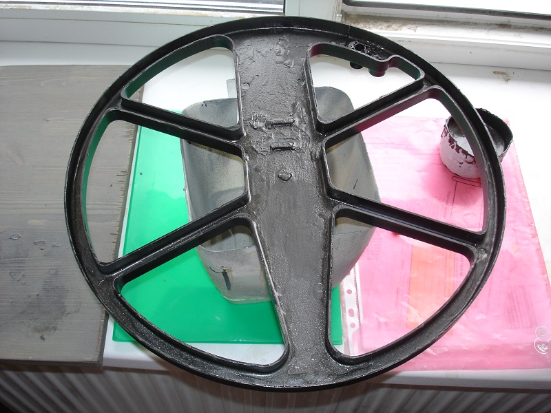

    Just a quick question about coil shield...
    If i paint with graphite bottom and top coil cover, do i need to leave gap?
    see here
      Probably not.. I leave a gap anyway but cannot tell any difference using " Blaster" brand spray graphite. It's not quite as conductive as nickel spray.

                        Originally posted by bandito View Post
                        see here
                        [ATTACH]37937[/ATTACH]
                        That's the same way i maked, but not with spray, i just maked myself graphite powder mix. First painted as bandito show in his picture, later when filled with epoxy resin i do one more layer, twist ground wire with graphite mix and final, add one more epoxy layer, maybe 1mm to cover shield.
                          Don..
                          Thank's Don, first time when i experimented with powder mix, it was with 1 cm gap. For IDX, work's much better than alu foil shield. Next coil i will try without gap.
                            Works fine without a gap with graphite/PVA mix
                            Thin 5mm coils thick are fine just top and bottom
                            Thicker coils need the edge doing as well otherwise wet grass becomes a problem.
                              Great thing is that how little graphite layer can make big difference.
