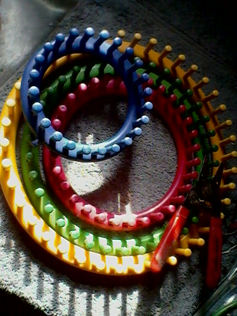

    Discovered a new tool for winding coils.
    Cheap.
    Ready Made.
    Readily Available.
    Multiple Sizes too.
    Wal Mart sells these Weaving / Knitting Looms cheap and it's like they had us in mind. LOL
    They can be had in singles or kits.
    The kit I have includes 11" 9" 7" and 5" forms. What more could you ask for ? I'm sure they make larger ones as well.

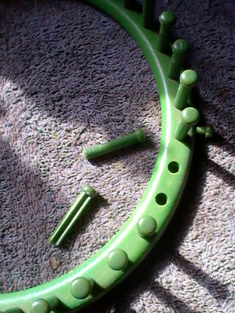

    As you can see the Pegs are Removable .
    You can do Mono or DD coils on one. By placing a small form within a large form you could do Concentric and Ohmaga Coils too. No Bending of coil required.
    Were Girly Toys meet Boy Toys ! LOL

    that really looks great. thanks for the headsup. got to get a couple of them
      Looks like a nice find. Thanks for sharing.
        just looked,
        HOBBY CRAFT in the UK do the full set of 4 for £8 !!!
        5 1/2 inches,
        7 1/2 inches,
        9.4 inches,
        and
        11.8 inches.

          That's a cheap price. They're quite a bit more expensive on Amazon and eBay.
            Discovered if when winding if you go to the fifth peg and continue like that you end up with a decent basket type coil. Will do some measurements when I have one done. Think I found a easy coil for my Barracuda.
