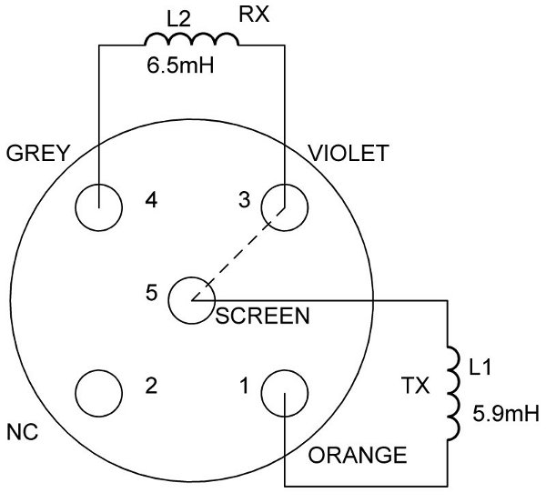

    I was hoping somebody might be able to share the pinout information for Tesoro Delta and Epsilon coils as well as FishTek GBP, F75, Fratbros. I looked around but can't seem to find them. I apologize if this has been posted somewhere before. Thank you.
    Had these in my notes, not sure if these were the numbers given me by Dave Johnson when I was trying to build a small DD coil for the Omega. Which I can't find the file for.
    TEKNETICS OMEGA COILS
    8” ROUND CONCENTRIC
    PINS
    1 & 2 10.87-10.89mH 22.1 ohms
    3 & 4 1.33mH 3.8 ohms
    5 x 10 Elliptical Concentric
    PINS
    1 & 2 11.92 Mh 49.3 ohms
    3 & 4 1.295mH 3.8 ohms
    Nell 13” DD
    1 & 2 25.2 ohm
    3 & 4 4.1 ohm
      Tesoro 4 pin

        Thank you Sven. I appreciate it. You just reminded me that I still have the CD of all the info I got from you a last year. Will have to dig through and see what coil info is on there.
