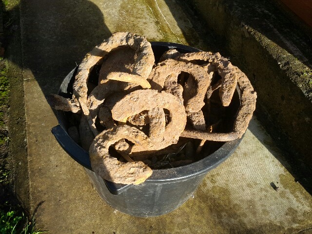

                      The DD is much more of a challenge than the simple coil of 12V thick insulated wire I used on my first PI detector. So for all this one gets less depth, but hopefully much less of the attached☺
                      Thinking along "The Detectorists" series lines, perhaps I should make a collection "Horseshoes through the ages". A steep field I'm currently working has very much less iron.... too steep for a regular tractor.
