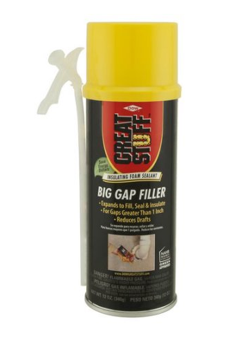

Alternative filling material
    Try it ! You will Like it.

      Do you use this PU-Foam as filling material for your coils?

                Yes, with no serious issues. LOL Do the foam before the shell is together. Just trim off the spouge.

                    I agree with homefire - the pressure pack foam is good stuff and can be trimmed easily once set but don't overfill when using it as it continues to expand slowly & steadily for some time after it is applied. Also, the remainder of the contents of the can do not keep for long once some of it has been used and the applicator nozzle blocks and is difficult to clean out so it can be wasteful.
