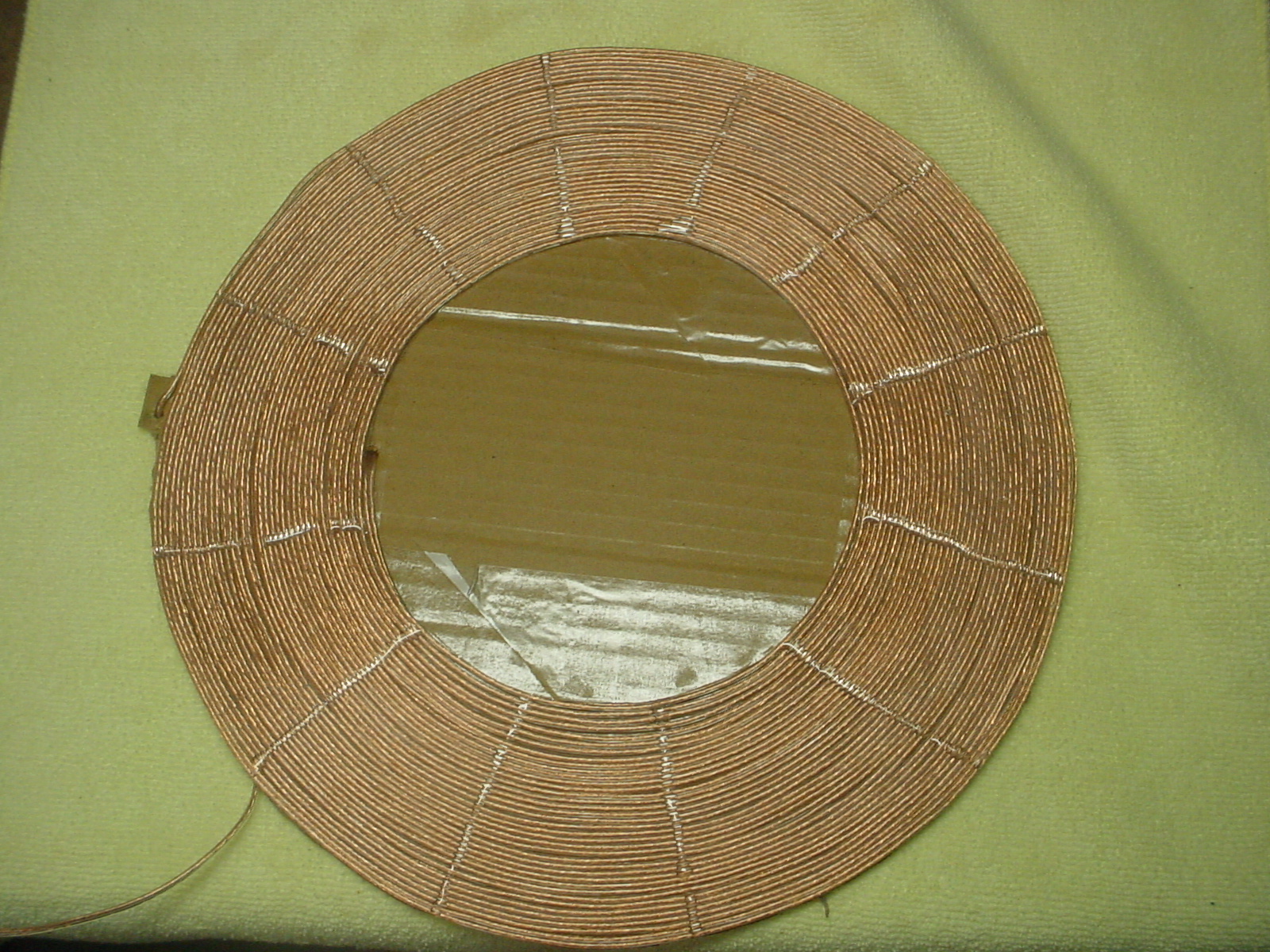

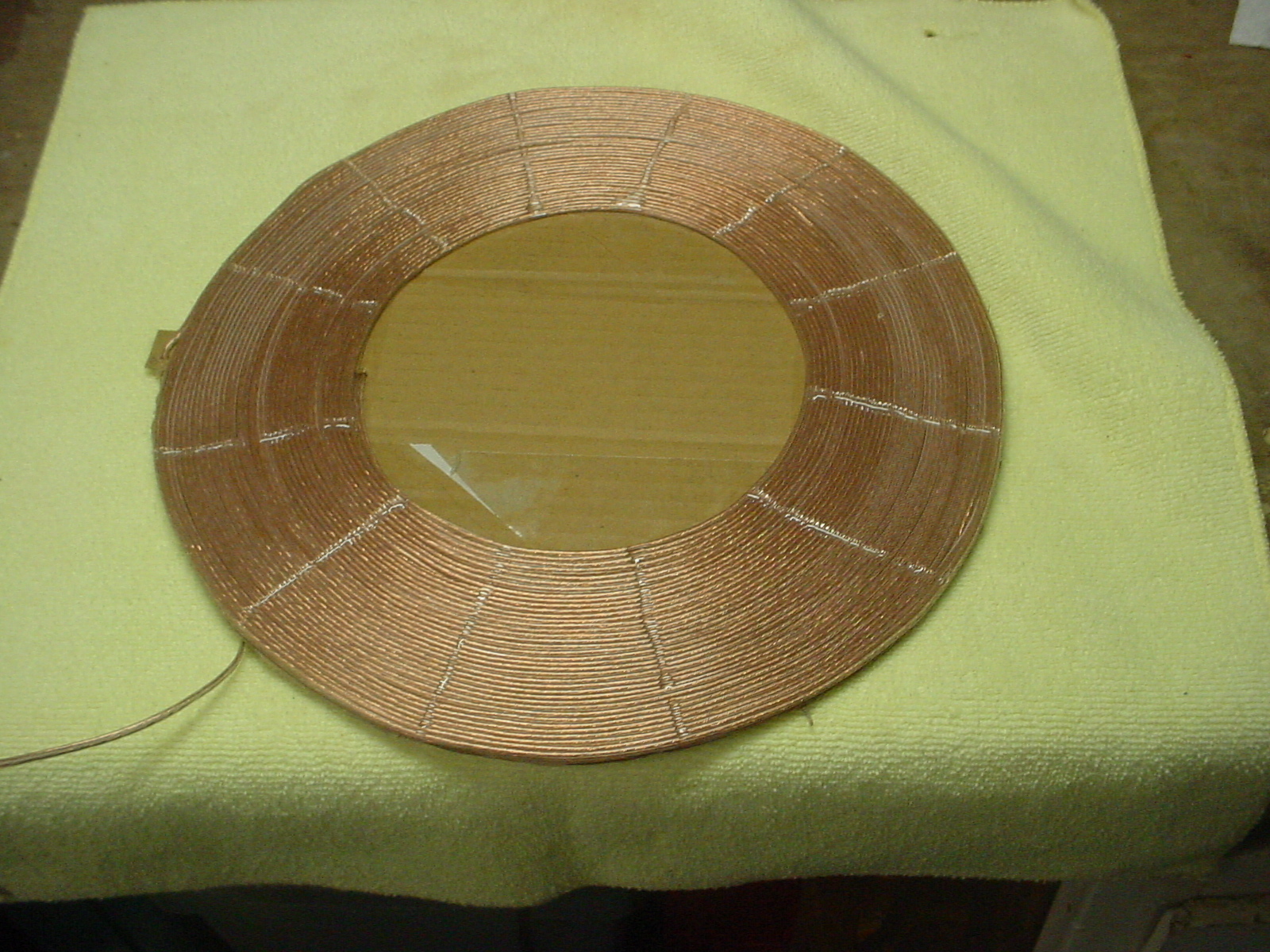

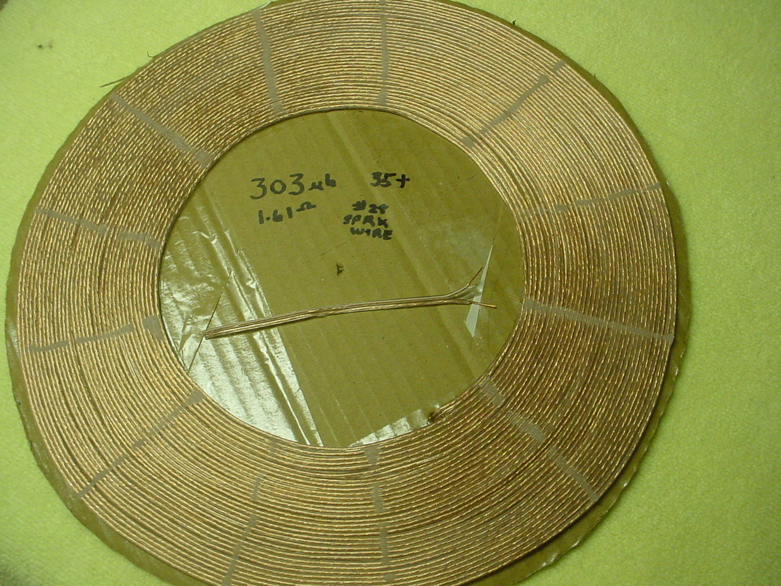

      I finished winding my 1st spiral coil, it is 25.4 cm in diameter , 362uh, and 1.65 ohms. I will test it on the bench this week. Best to all Jim

        looks good, what was the glue ?

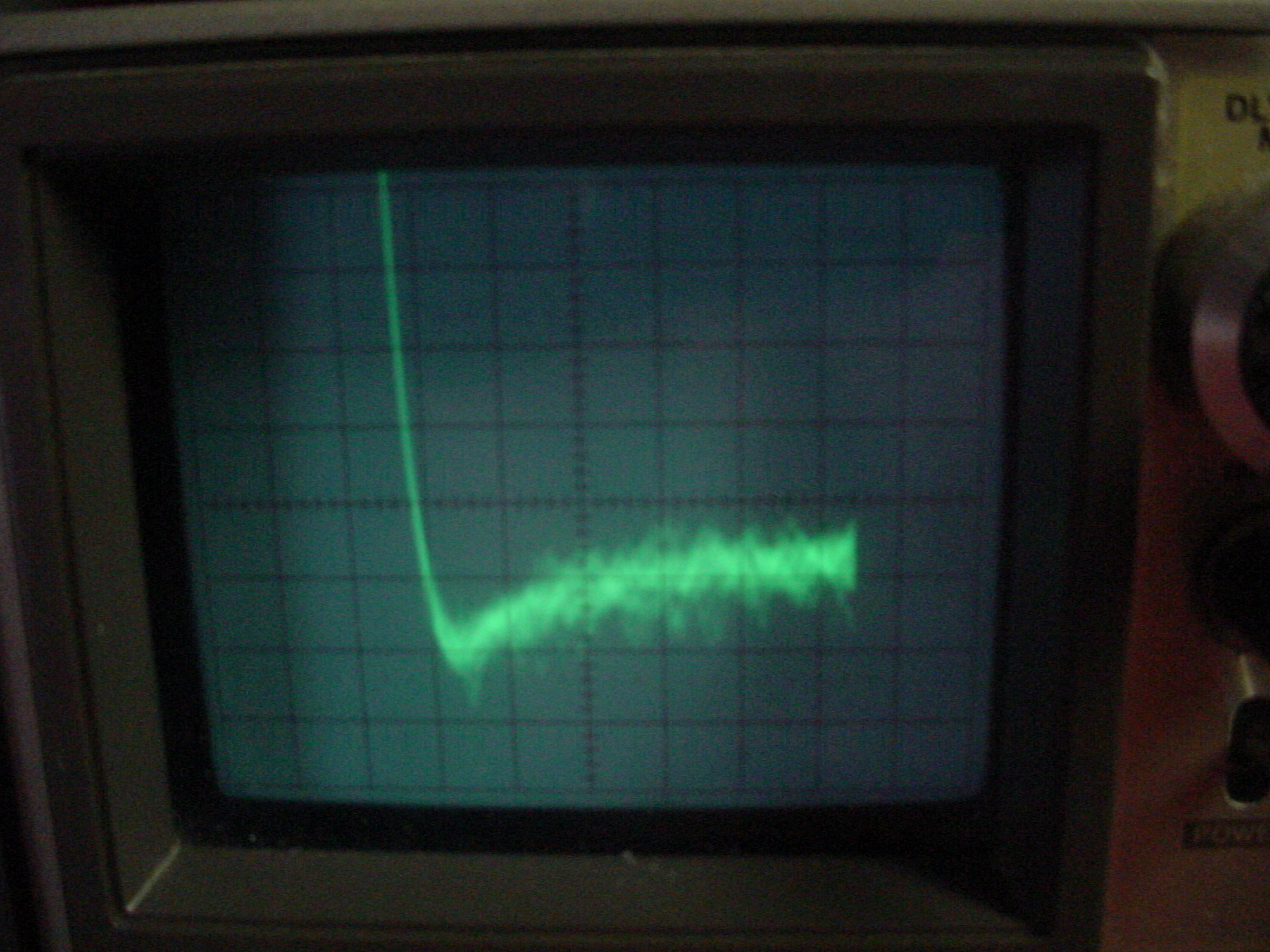

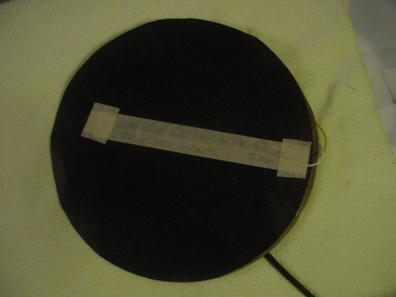

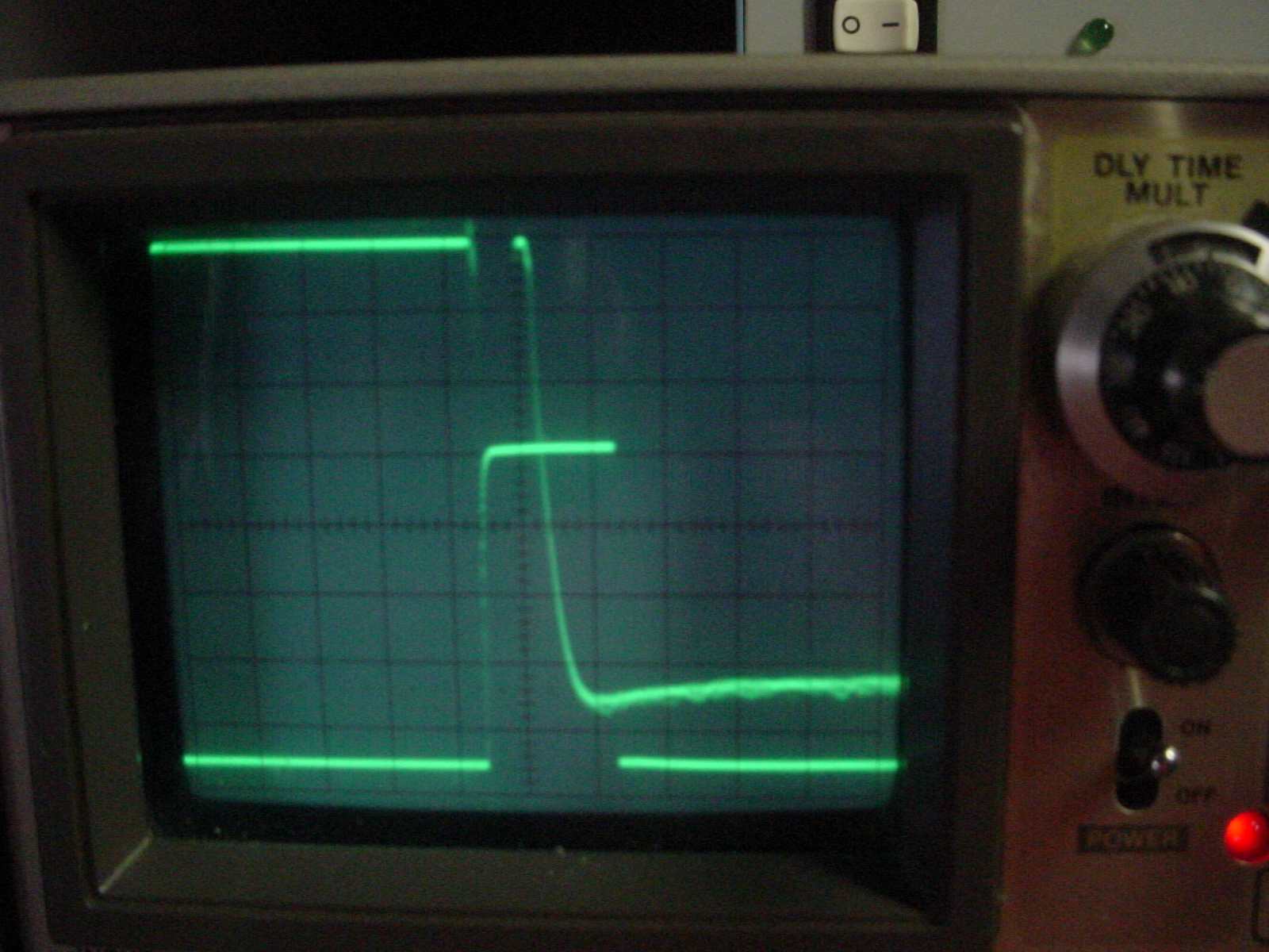

            I did the test on the basket weave coil, I have added a electrostatic shield, I sprayed the coating on a couple of pieces of construction paper, top and bottom. The first picture tis the noise on the trailing edge of the detection pulse, the second picture of the coil with the shield, the third picture is the is the detection pulse with the timing pulse. Here is where I have a question, is the timing pulse in the correct spot ,in relation to the detect pulse. Thank you all. Best to all Jim

              Hi James, which PI circuit are you using? Is the narrow pulse in the last photo the delay or sample period?

                I must of push the wrong button, I use the Surf PI-1 and Overton-Moreland PI in the book. The circuits seems to perform the same. I triggered the scope on the receive and the second pulse is the delay pulse. I use the MG chemical electrostatic spray to coat the construction paper. I attach the ground lead to the paper with very sticky tape. I have the coil shields on the top and bottom. Best to all Jim

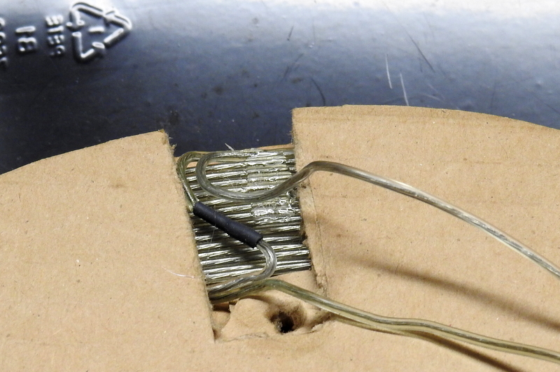

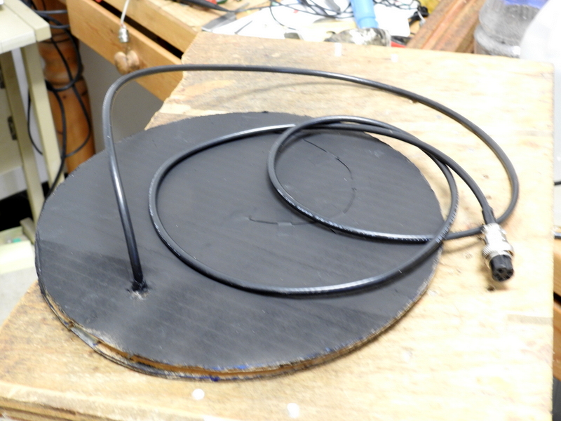

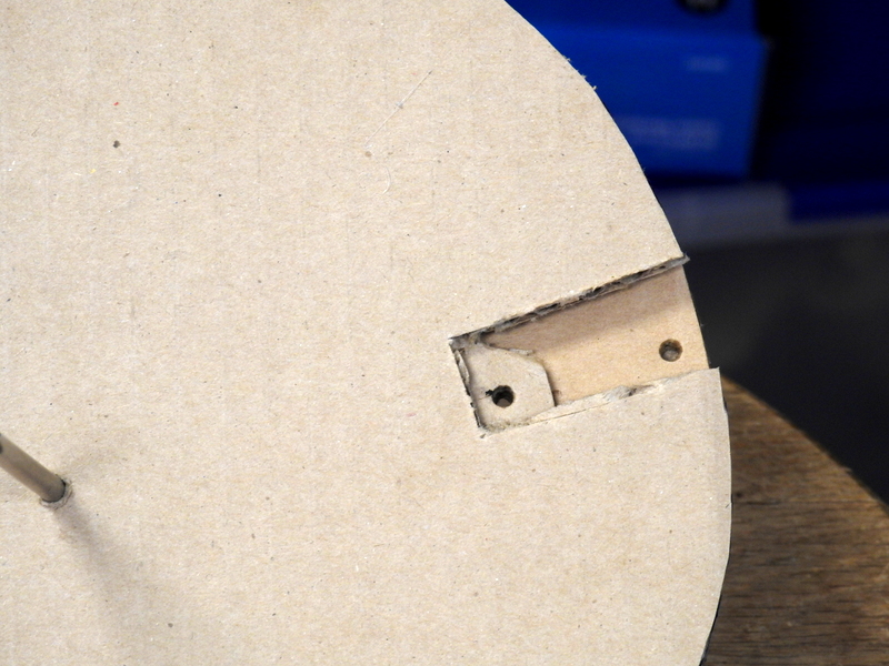

                  This is what I came up with to test this style of winding and it seems worth while.

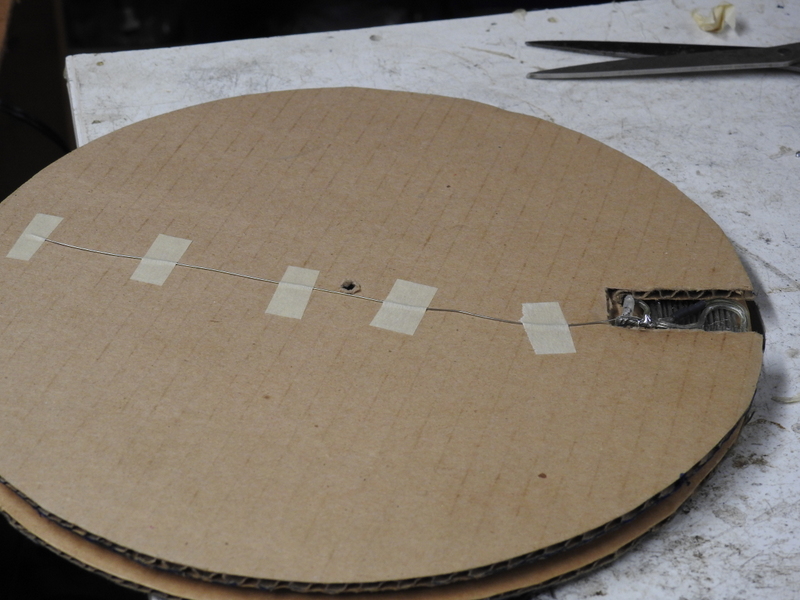

                  15 turns 24 awg speaker wire on a 18cm core. It's wired(stacked) like post #38 by 6666. The top layer finish(outside) is connected to the bottom layer start(inside). Cable is RG-58 and the coil shielding is GC graphite spray. It worked very well on the tdi at 10uS sample delay. Tommorow I will scope the pre amp. Next I want to try some 18 awg.
                  333uH 2.0ohm with cable

                    Well done thanks for the pictures, glad it worked for you, the 18awg will get the R down.

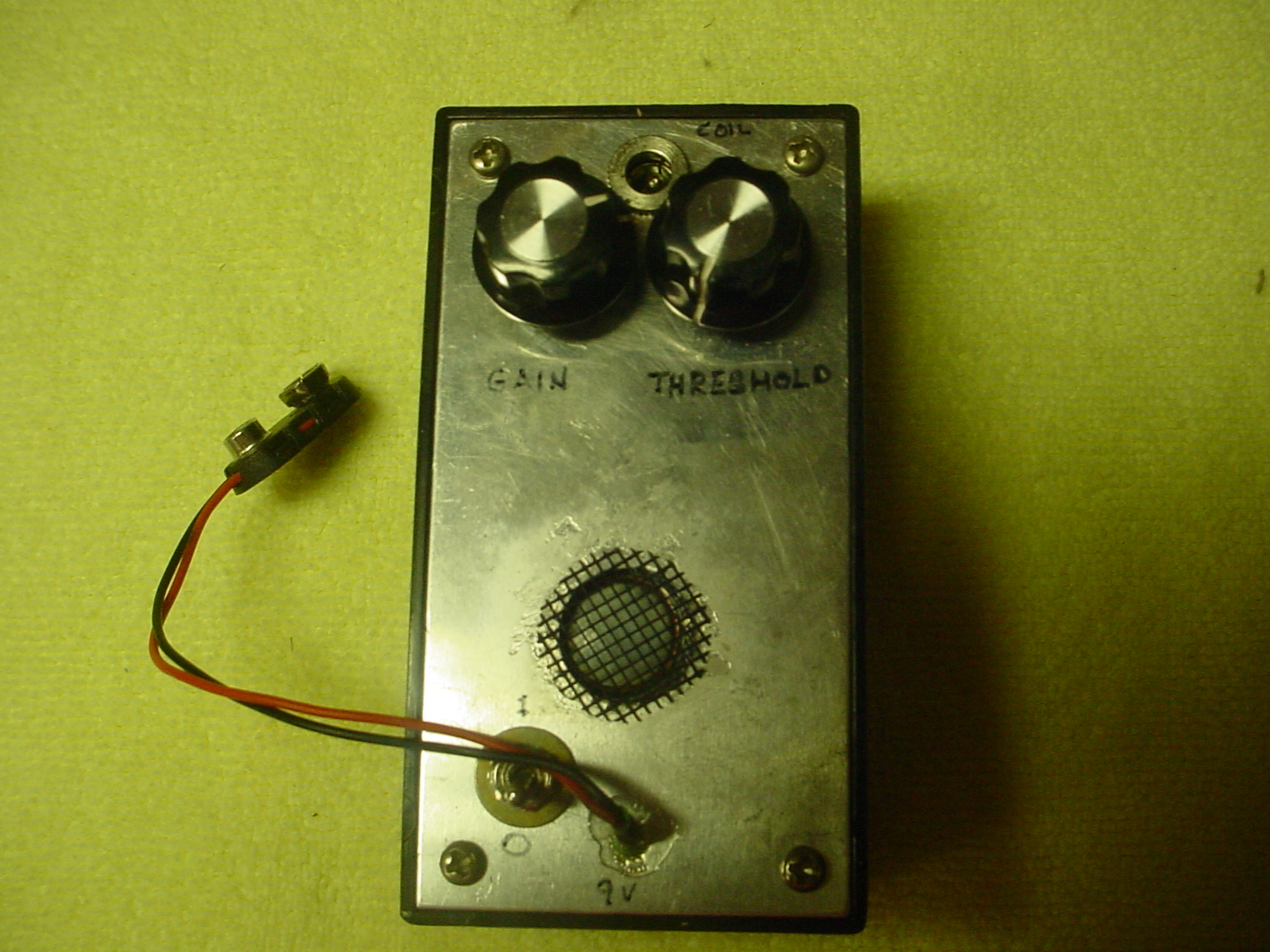

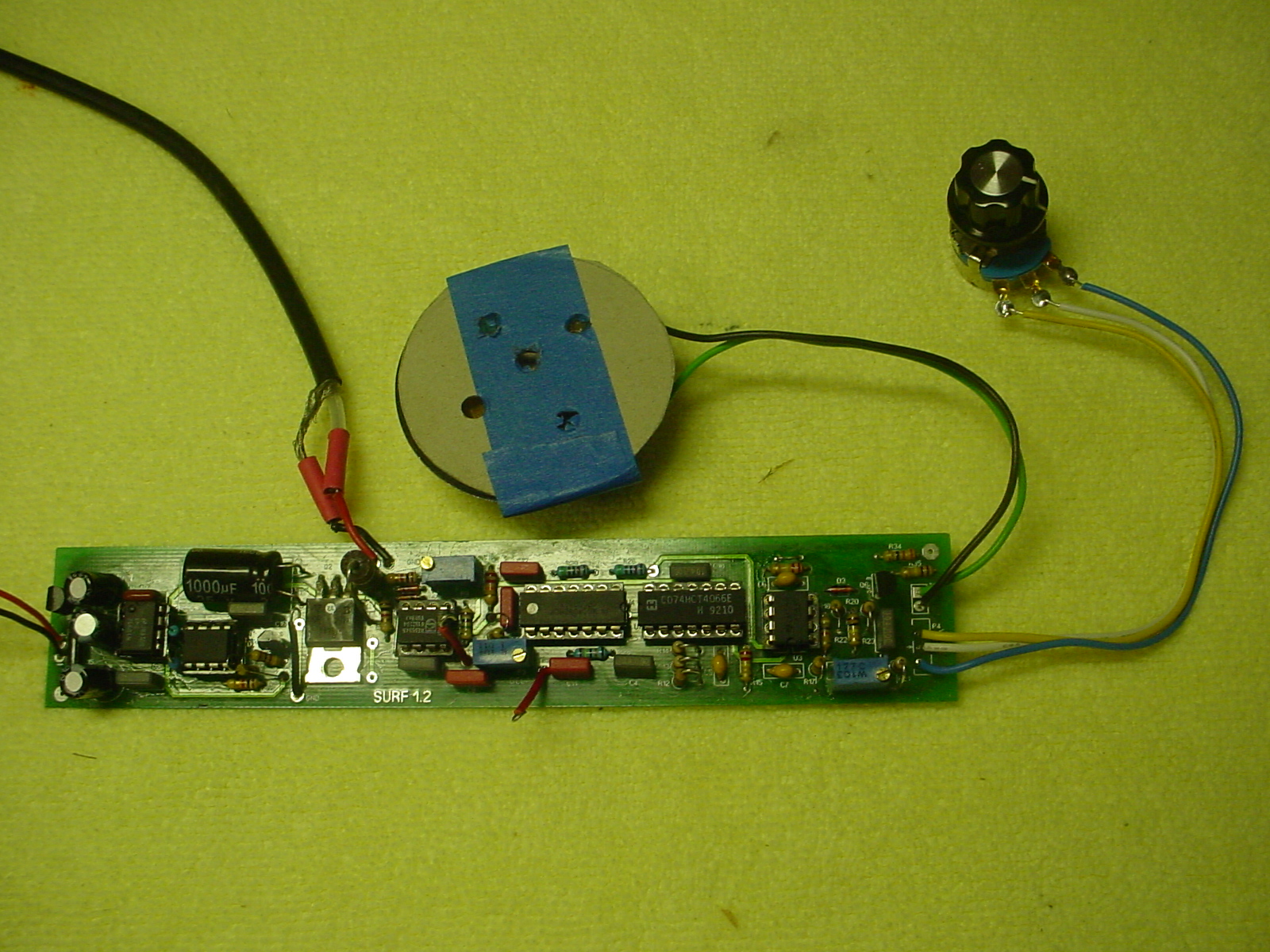

                      I tuned my 25 cm coil, now it is 303uh , 1.6 ohms. I also posted pic's of both of the PI units I do the test with.
