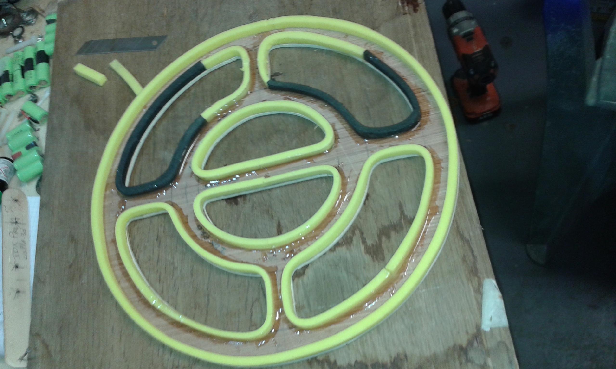

    good evening everyone,
    I seek your knowledge for the shielding of the coils.
    I built a concentric coil of 30 cm. it works very well....on my work plan ....
    is it possible to paint the bottom with shielding guitar cavity paint?
    here is the picture of the coil holder.
    What do you think is the best method for a good result?

    The shield is very important. I have had a few fails. Its sometimes hard to predict what will work and what will fail.
    However if you paint a square and measure the resistance across it will give a good idea.
      I would stay away from any Metallic Based shielding paint. Use Carbon Based.
        Apparently many of the guitar paints are graphite based, but I didn't find any information about conductivity.

            Good evening,
            yes it is this painting .. exactly the same .. I give you the test results on a piece of cardboard as soon as possible.
            tonight I did a test of conductivity with a graphite pencil 6b ... 100kohm / 1cm .. is that good? what should be the good value of conductivity?

                Pencil on paper failed
                zinc carbon battery on cardboard worked. for a short while. Unfortunately it corroded the tap wire
                graphite powder and varnish worked
                Graphite powder and PVA glue worked
                Graphite powder and epoxy failed
                Graphite powder and UHU failed

                          Maybe there is simple solution. Has anyone ever tried experimenting with this? It would be very easy to cut and paste if it worked.
                            Or maybe you could just wrap around coil for shielding.
